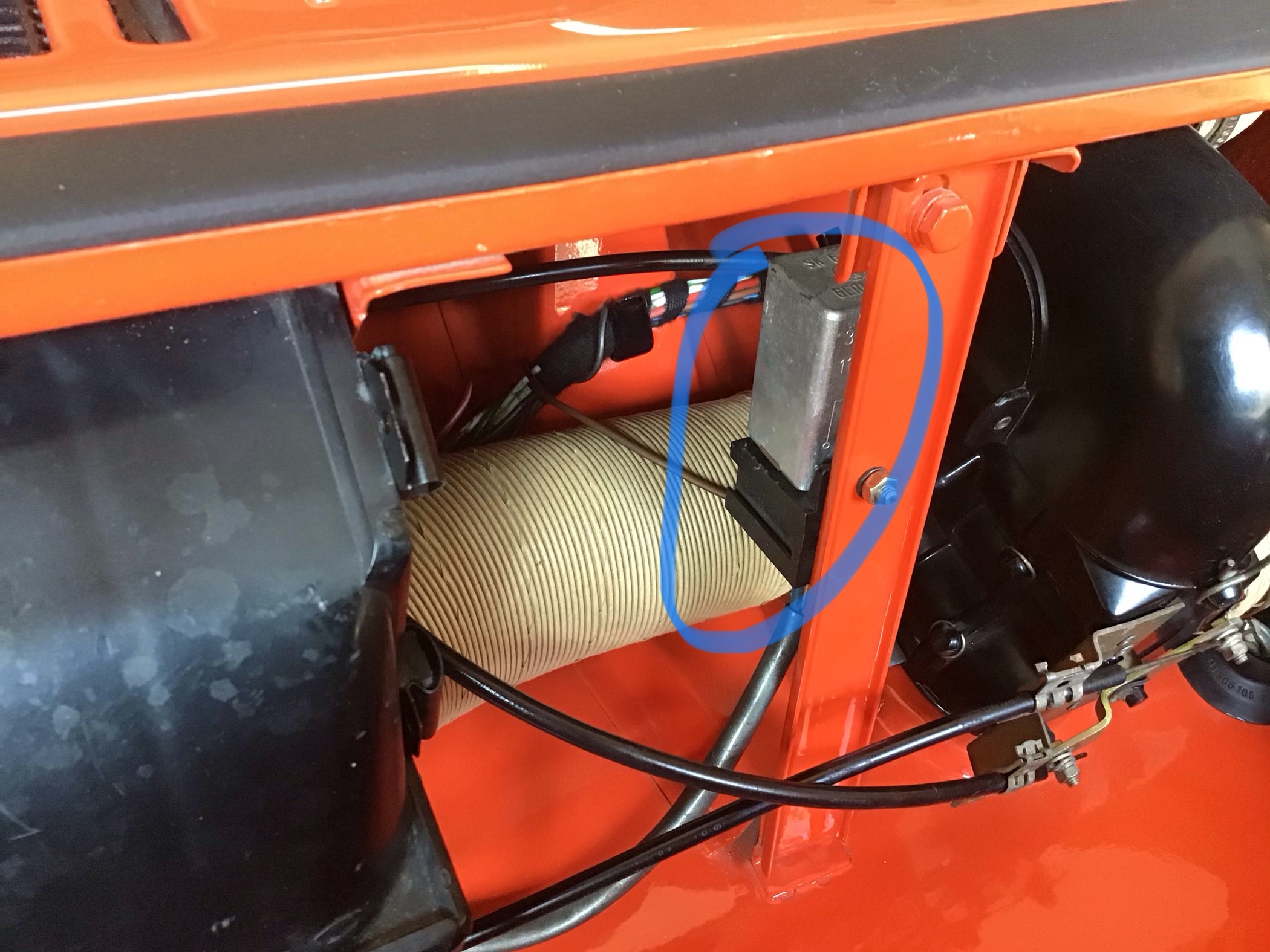

@Morph914 - are you running that switch straight to the pump or do you have the intermittent wipe relay? if it's straight to the pump, one of those wires from the carmagic switch goes to the + side of the pump, the other goes to a switched power source at the fuse box. then the - connection on the pump goes to a ground.
Morph914
post Oct 25 2020, 05:32 PM
Posts: 435
Joined: 22-August 16
From: St Augustine, FL
Member No.: 20,326
QUOTE(FlacaProductions @ Oct 25 2020, 08:53 AM) *
Thank you, i think I have the intermittent option, but I have never had the pleasure of driving this car. It was not running when I purchased it.
Isn’t the relay in the picture, part of the wiper intermittent system?
