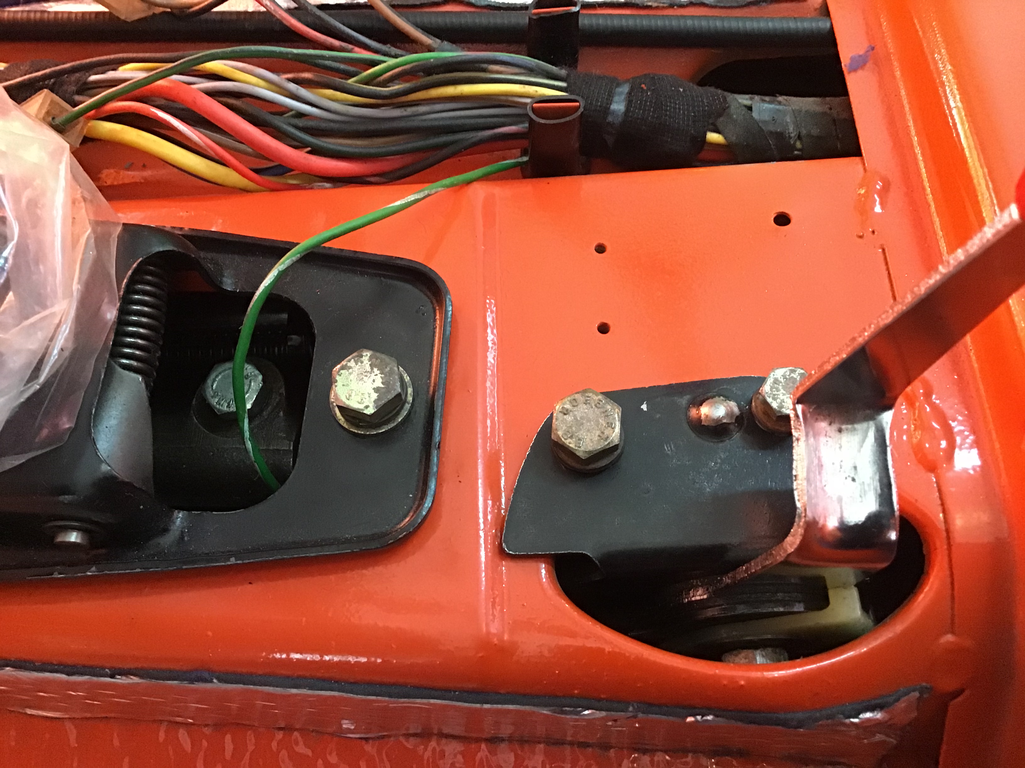

I am starting to work on the interior wiring and am not sure if this green and white wire goes to the heater lever or not. I accounted for all the other wires in the area that go to the 3gauge pod except a black and blue wire, but it has a small connector on it so I know it’s not for this lever. I did connect the green and white wire but when I tried to bolt the lever down it was too short. (IMG:style_emoticons/default/headbang.gif) The wire loom is the only thing I did not remove from the car, so theoretically, everything should be in the same place. Hopefully someone can chime in on this.
Not sure if this is the way the wire is routed.
