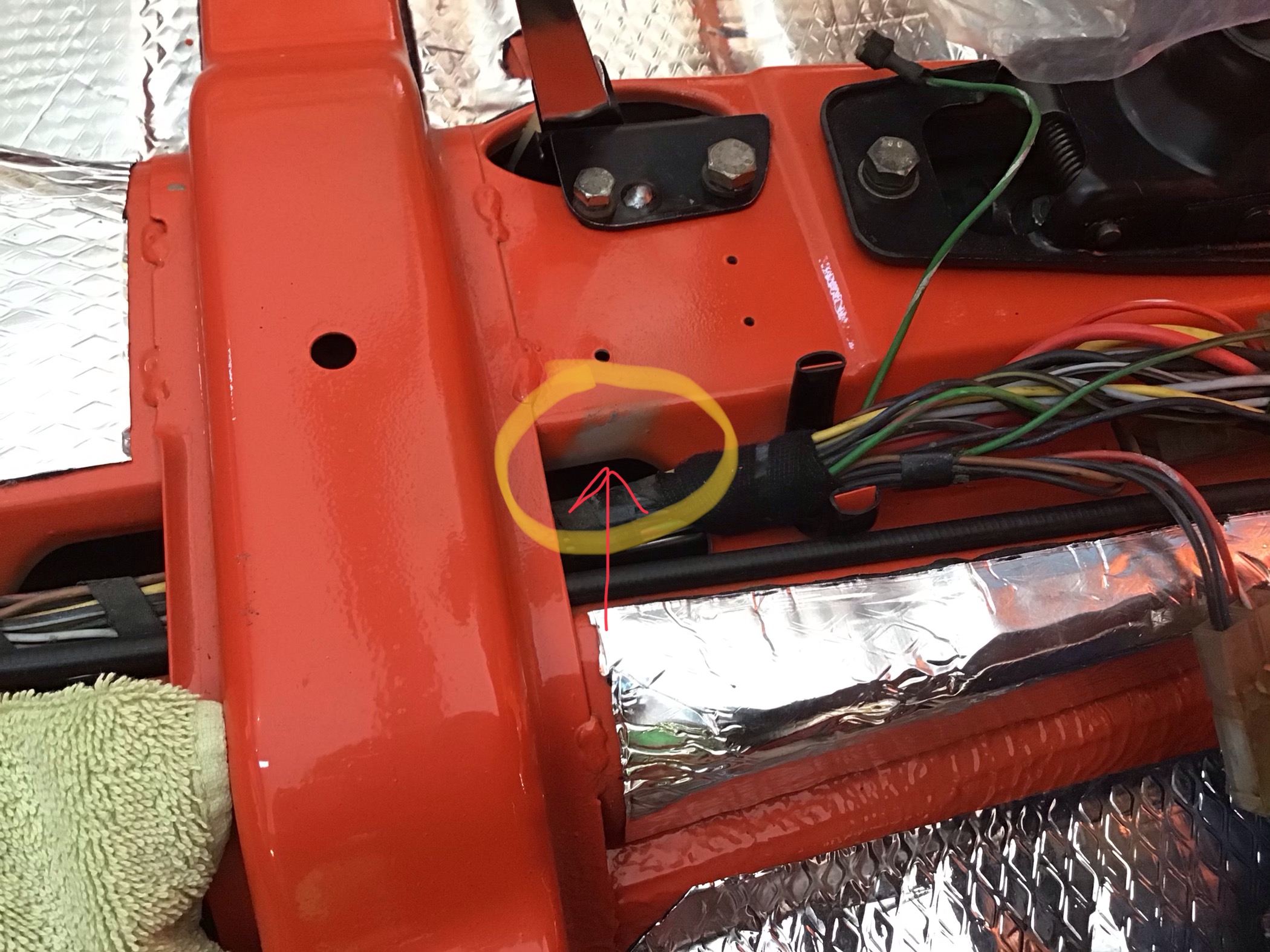

I don't think that is the proper routing for the wire. Check by the cross support for an opening.

QUOTE(djway @ Nov 5 2020, 02:27 AM) *
Yes, I believe you are right, I should have had that wire exit the loom closer to the cross bar. After I cleaned the loom, I retapped this area and probably should have not taped over the green and white one.
I think I’ll undo some of the tape and reroute it through the side of the tunnel.
