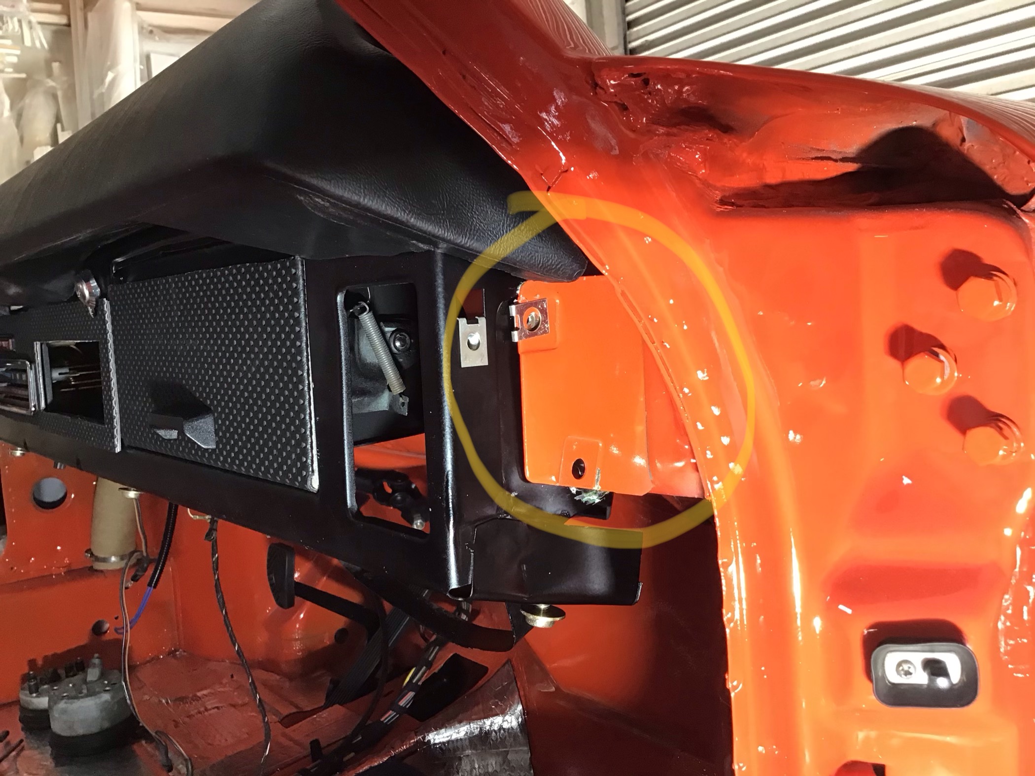

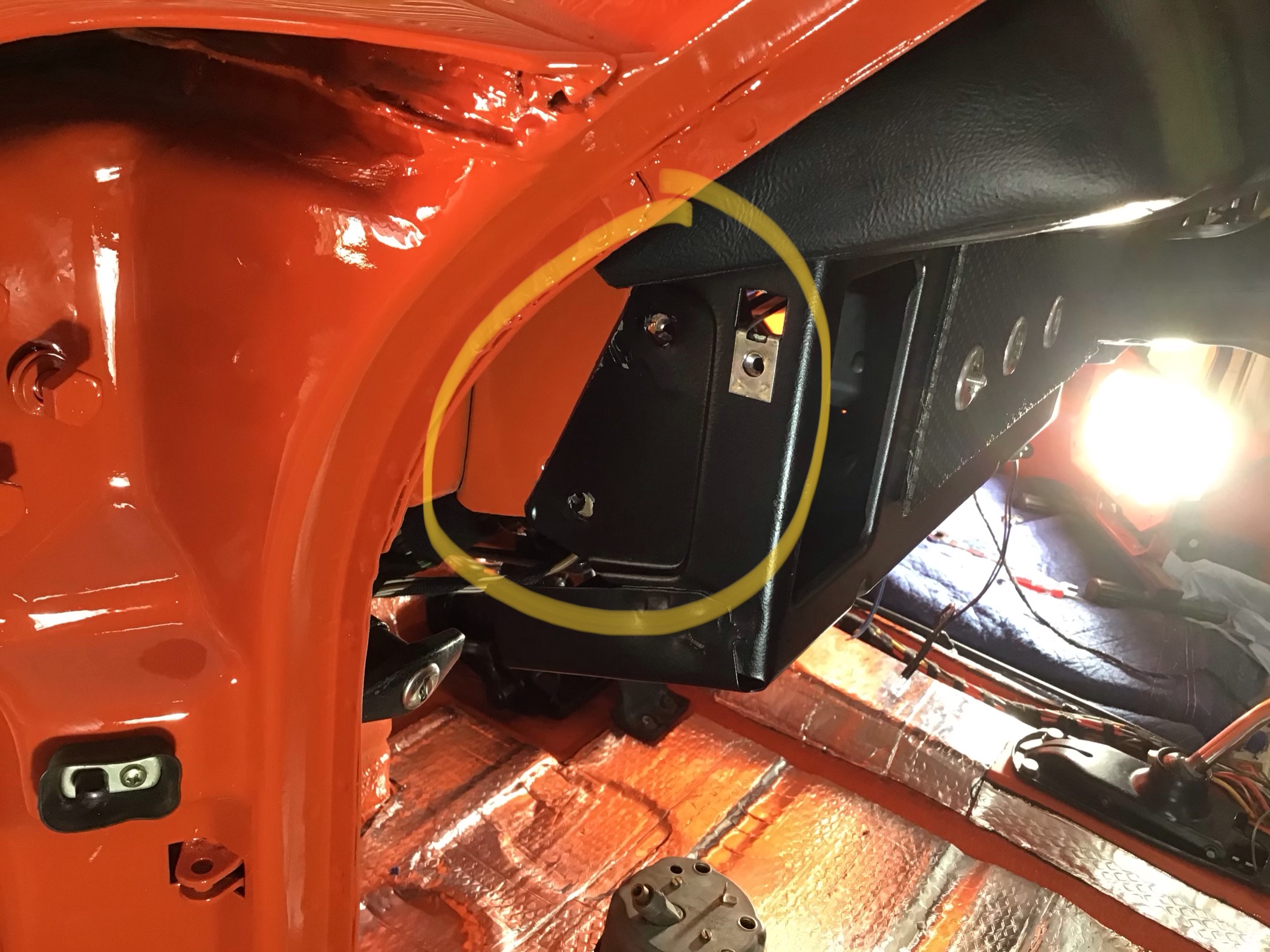

I discovered this today, after installing the dash and now connecting everything. (IMG:style_emoticons/default/headbang.gif) I will now have to undo much of what I have been working on to fix this problem.
I am not sure which orientation is correct, I think the drivers side is the correct. Notice the side of the metal dash, the drivers side is on the outside and the passenger side is on the inside. (IMG:style_emoticons/default/mad.gif) I guess it could have been worse, I could have been completely done with the dash, steering wheel, etc.

QUOTE(Morph914 @ Nov 5 2020, 12:26 PM) *
That is a very good question. And one I'll need an answer to at some point in the future. I'll give you a (IMG:style_emoticons/default/icon_bump.gif)

Morph914   Figured it out, it has to go on the outside to tig...   Nov 11 2020, 03:58 PM
