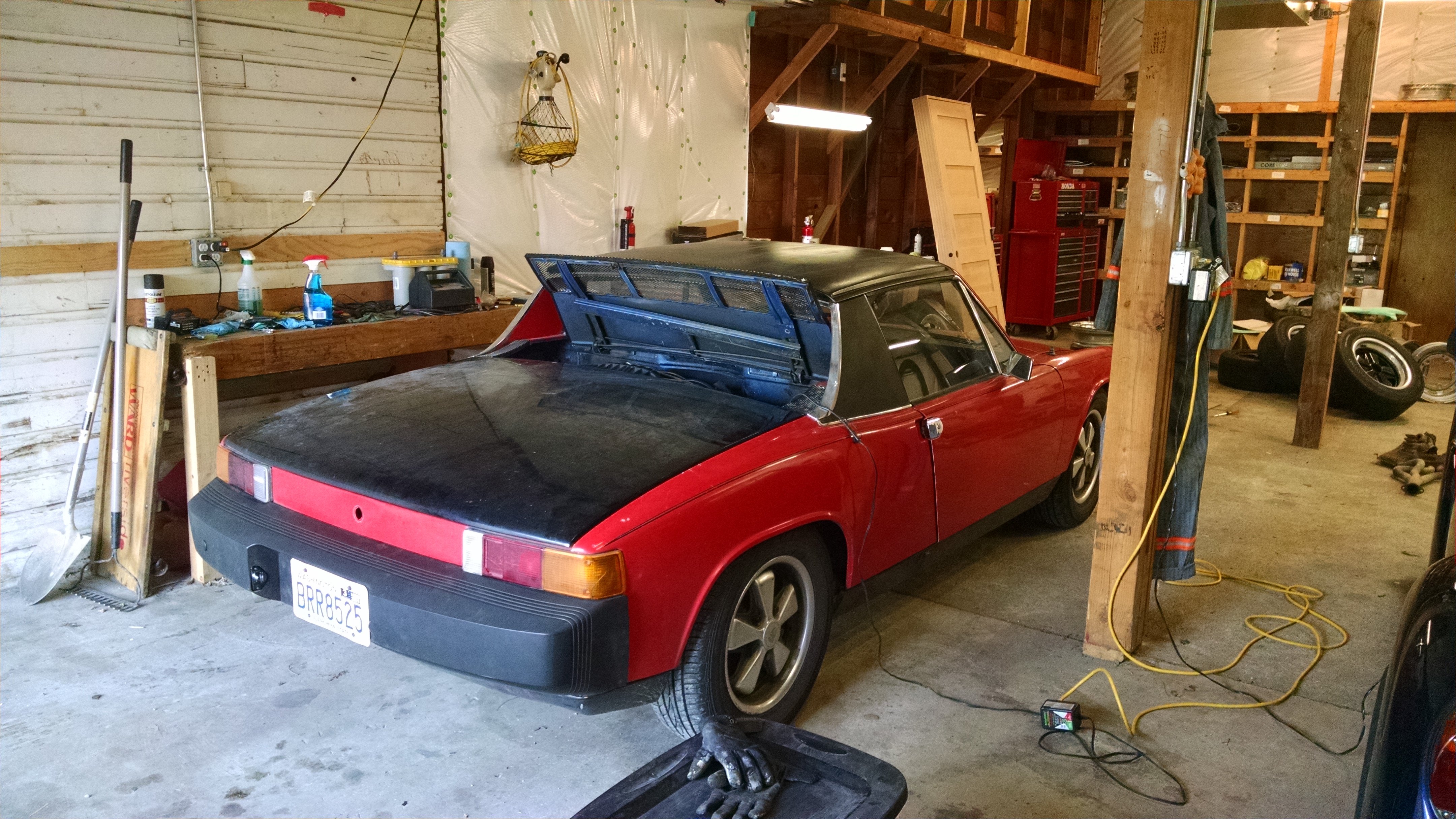

Tinkered on the 914 today, swapped bumpers and rear lid.

Root_Werks   Tinkered on the 914 today, swapped bumpers and rea...   Nov 27 2020, 04:10 PM
