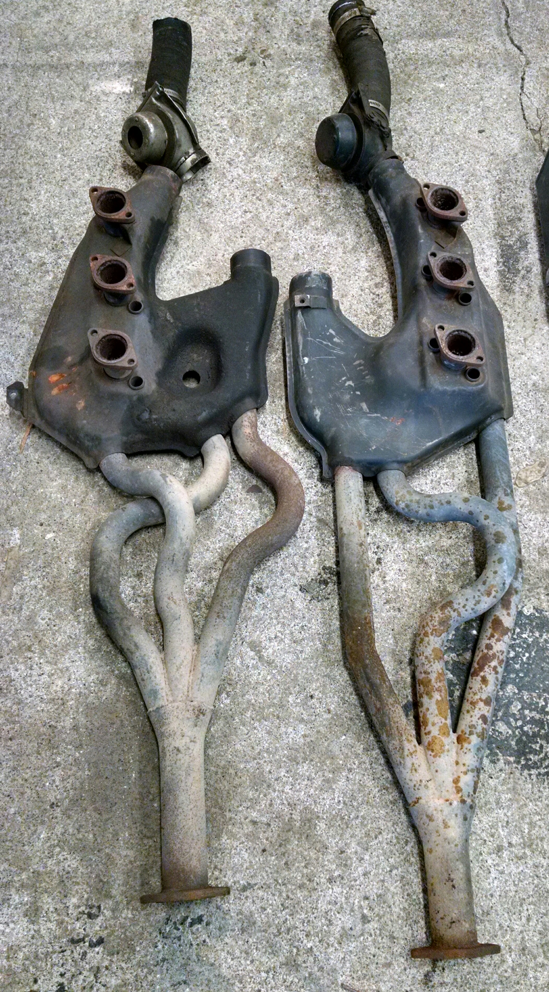

Found these tucked away

Root_Werks   Picture of the 993 heater boxes. The heater works...   Mar 25 2020, 12:09 PM

Root_Werks   Found these tucked away   Nov 27 2020, 05:11 PM
mb911   Score.   Nov 27 2020, 05:15 PM
Root_Werks   Score. Totally unexpected one at that. Bought...   Nov 27 2020, 10:20 PM
