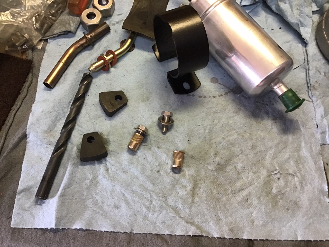

I am getting ready to install the fuel pump on the engine fire wall. I was going to move it to the front near the fuel tank but have decided for now to keep it close to the original location being that the electrical is in place and can be readily connected. I was going to use riv nuts to mount it, but this requires a fairly large hole to be drilled, and I do not have the tool. What have you used to mount your pump in this area?

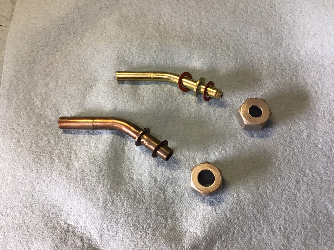

Also getting the fuel tank ready to install, I received the newly plated line that connects at the bottom of the tank, ( thanks bdstone ). His came with two gaskets or fiber washers, is this correct? If so, I need to find a new set for the larger line ( maybe Ace has these).
I plan to use the braided fuel line underneath the tank due to its flexibility, but not sure in the engine compartment, does one have an advantage over the other?

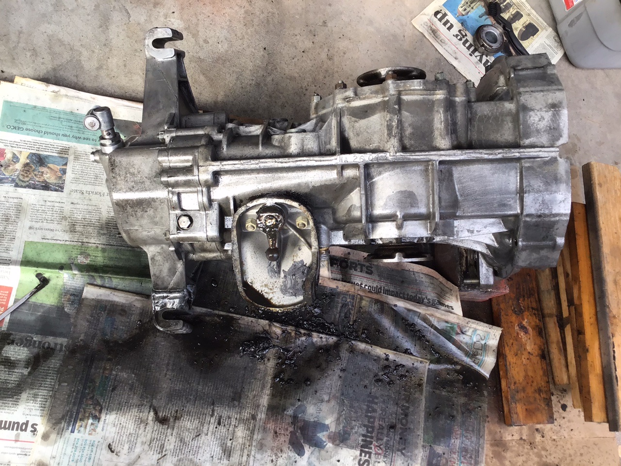

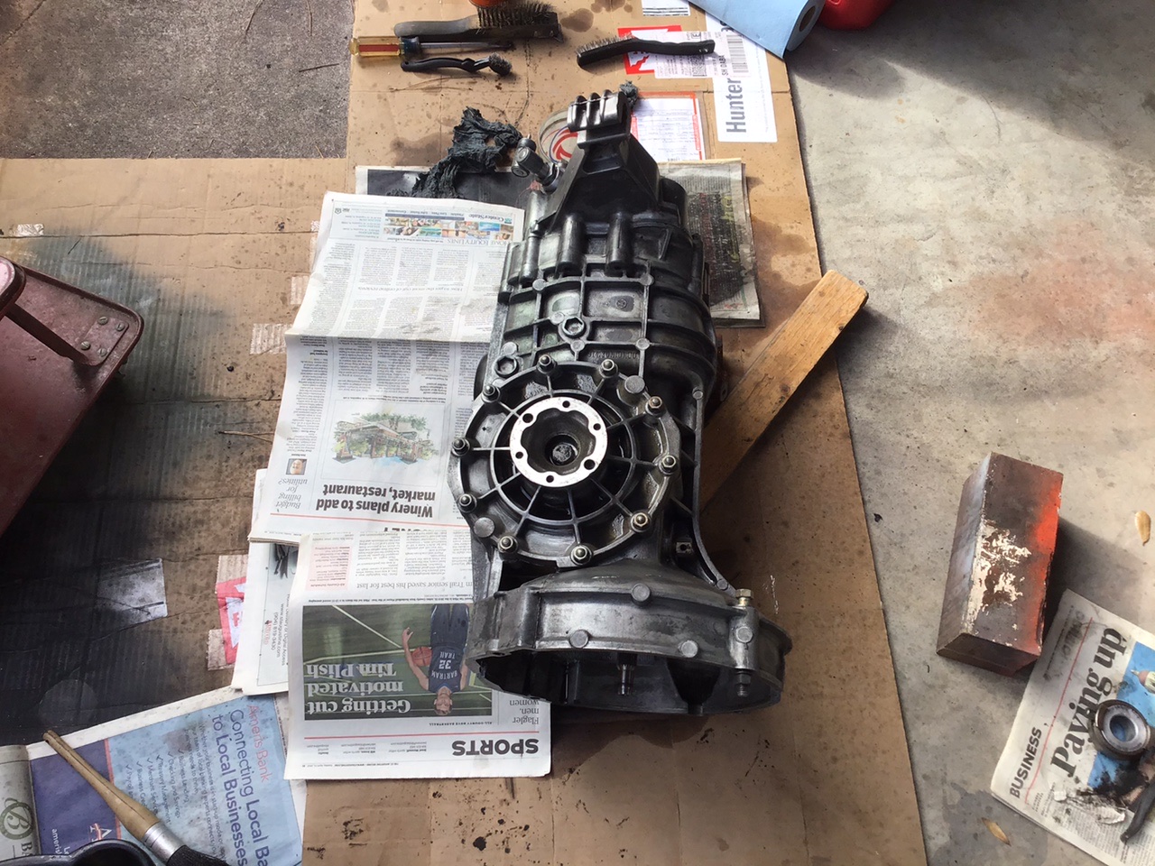

Today I was able to spend a bit of time cleaning and inspecting the transmission before I attach to the engine.
I do not know the history of this trans so I was wanting to at least reseal it before running, but now have decided to put fresh 90 wt and run it.
