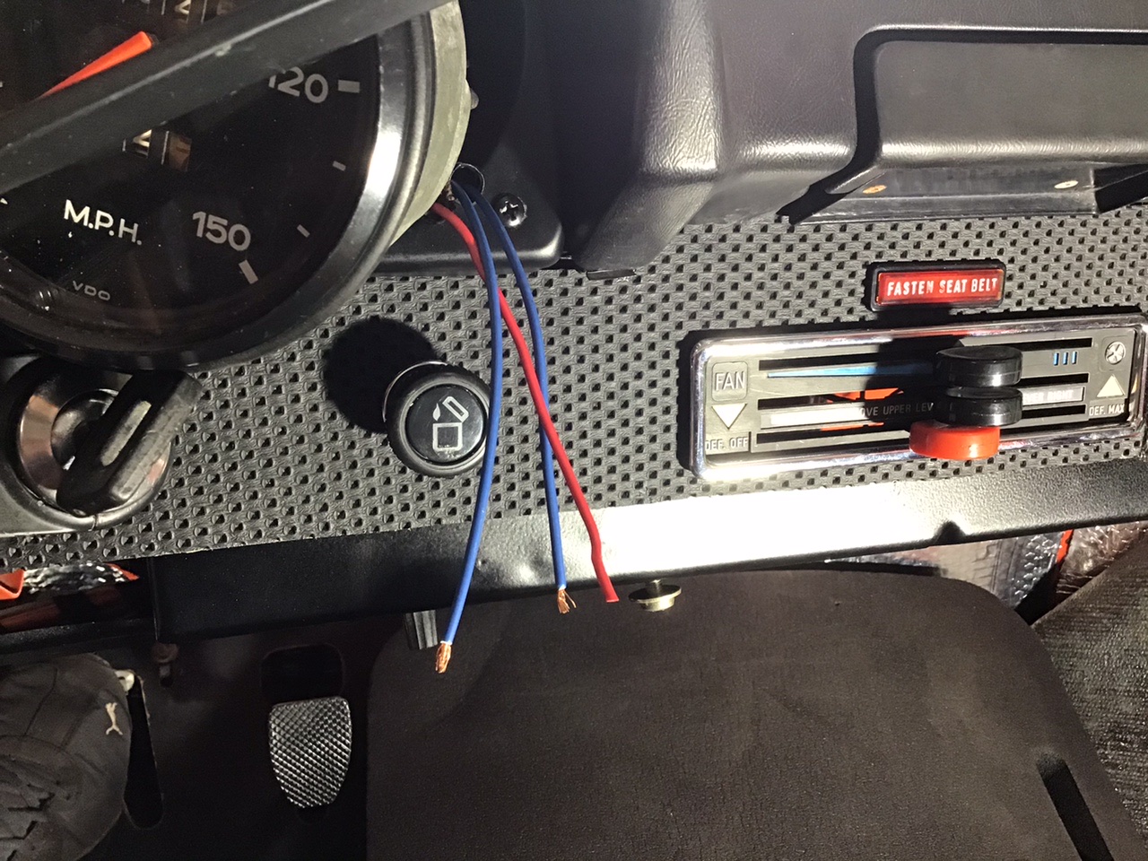

So I already have the intermittent relay on my car. I have installed the car magic switch in the column. The new washer pump has been installed under the reservoir, I have grounded the pump and run a wire to from the positive terminal of the pump up to the column, this wire will connect to one of the car magic wires, but I am not sure if the other wire goes to the switched side of the fuse panel or the intermittent relay.
Any help with this would be appreciated.
You can see the two blue carmagic wires, one of those will connect to the red wire from the washer pump. Ian am looking for direction on where the other should go.

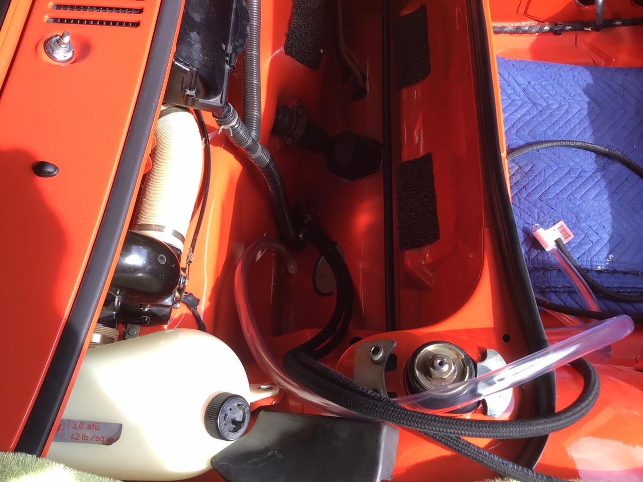

I am trying to get all these little loose ends tied up before dropping the fuel tank in, as it is much harder to work in there with it installed.
I am using the braided fuel line under the tank as it is much more flexible. I will probably add enough extra to lift the tank out without having to remove the lines.

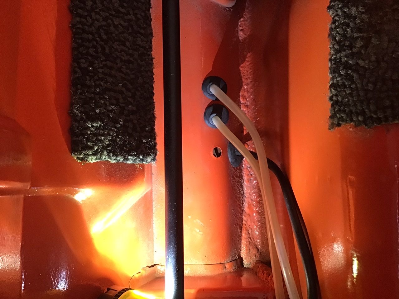

Also wondering what this hole next to the brake fluid lines is for. I don’t want to install the tank more than once if possible.
