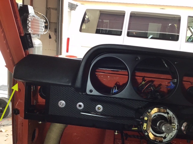

One other thing you may or may not have noticed.....
Both ends of the dash top bow up a bit such that they don't meet the lower trim all that well.
See yellow arrow in the following pic.
I have a big (1/4" gap) on both ends of the dash where the upper dash top meets the lower dash pieces.
It bothers me enough....that I've thought about getting the lower dash pieces reupholstered such that they come up and meet the upper dash top better.
Currently I have some kind of material in there that just fills up the gap.
Aggravating for sure.
Your car looks great.
Keep up the stellar work.
