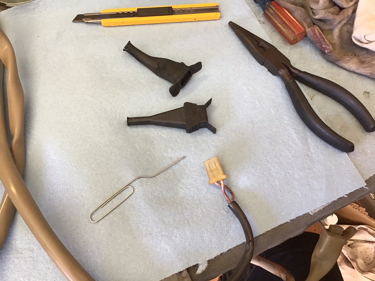

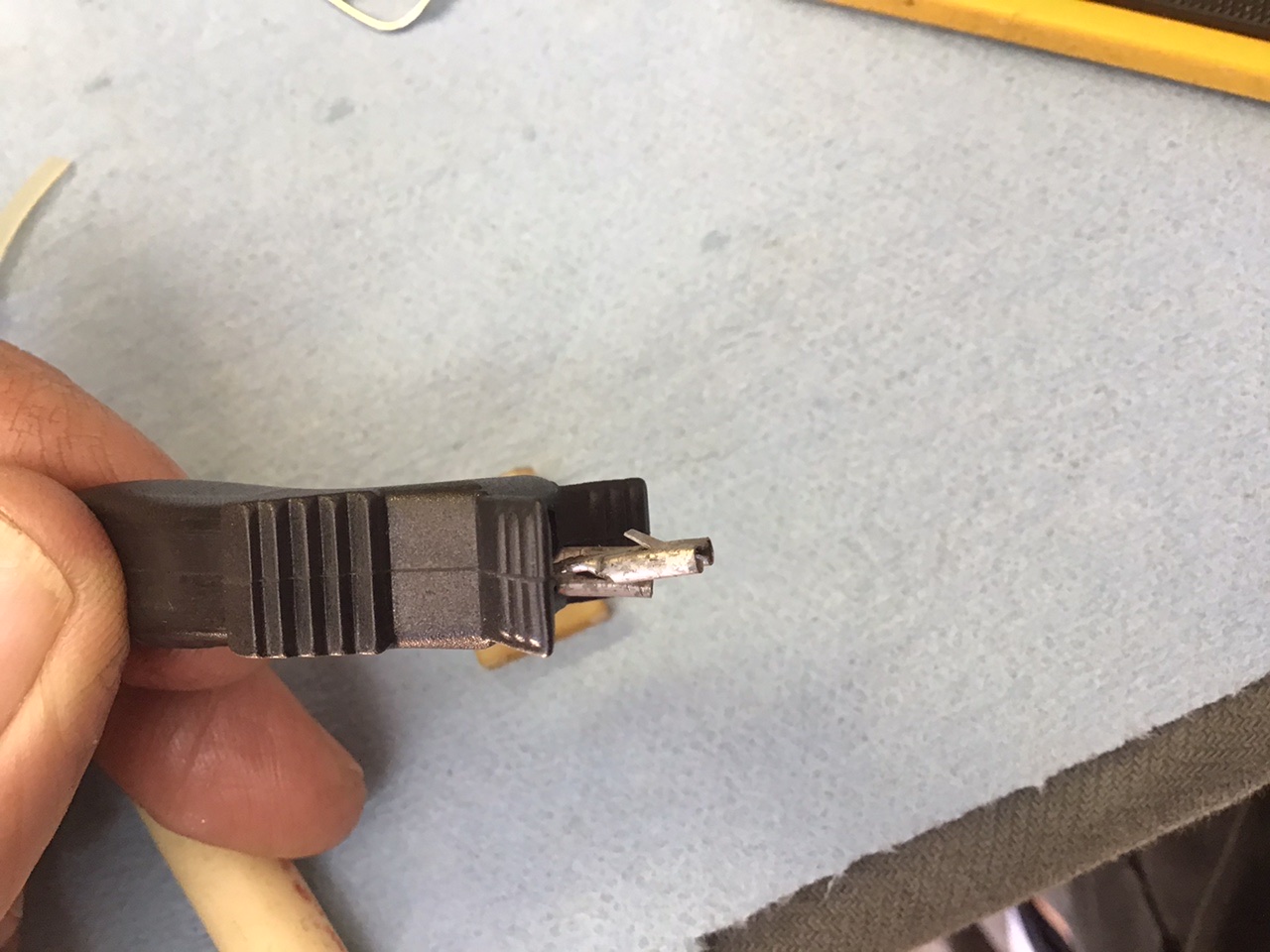

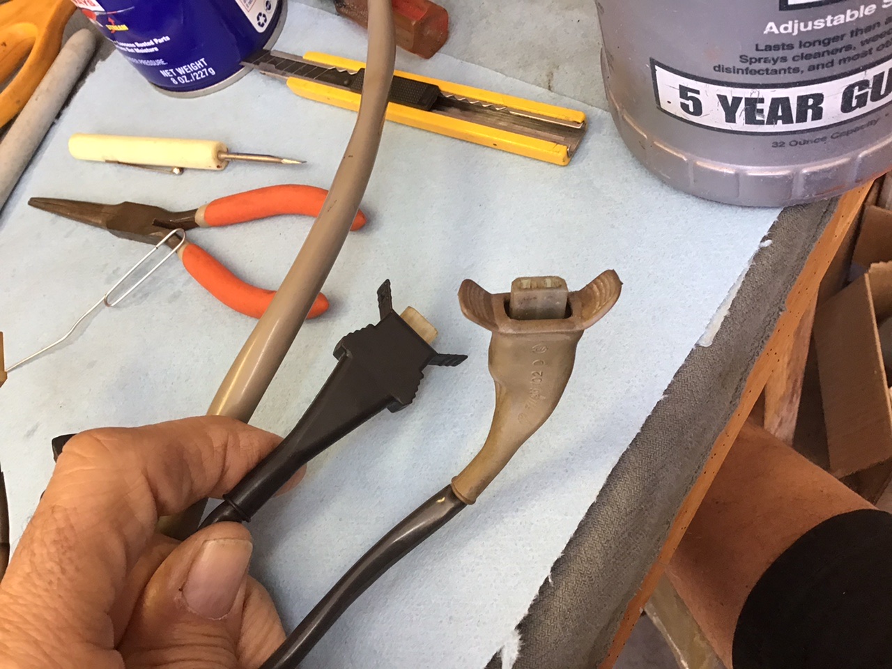

Starting to get some tidbits ready for the engine. After cleaning the fuel injection harness I decided to replace the fuel injector rubber boots. For some reason I had two black and two grey boots for the injectors. Does this signify something, perhaps odd or even cylinders? The grey boots were still in good condition so just changing the crispy black ones.
Notice the handy dandy release tool I made with a large paper clip, just a few taps with a hammer on the edge to flatten out.

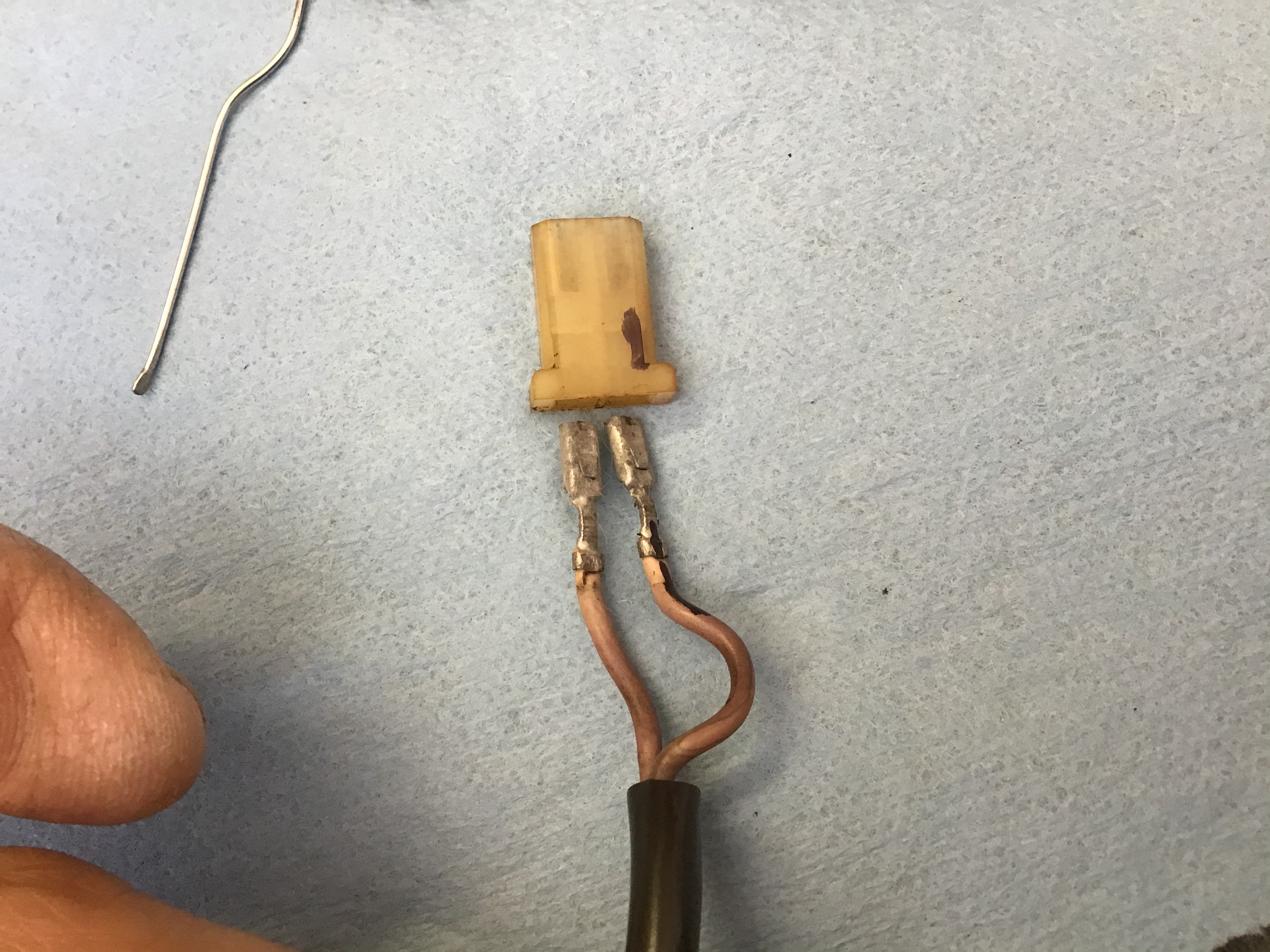

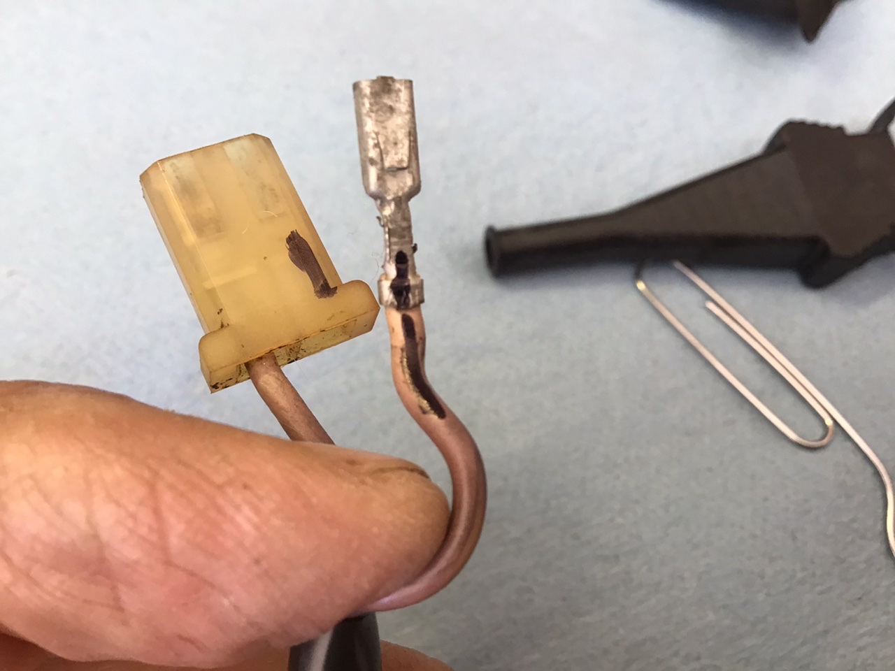

Im not sure if the wire orientation matters, but I marked one of the wires after taking it out so it would return to the same side.

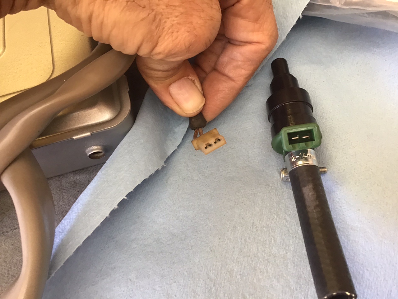

Getting the boots on were a bit of a pain, I used a bit of WD 40 to lube the boot.
After you get the wires through make sure and push the tab back up on the connector or it will not lock into place.
The plastic piece that fits into the injector is notched on two of the corners as if to fit into the injector in a specific manner but the injector has no such matching cut outs. Does anybody know if it matters which way these go in?
