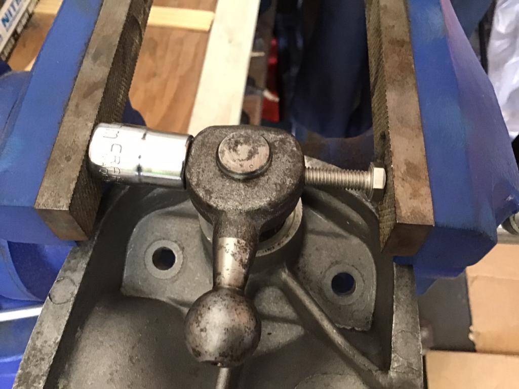

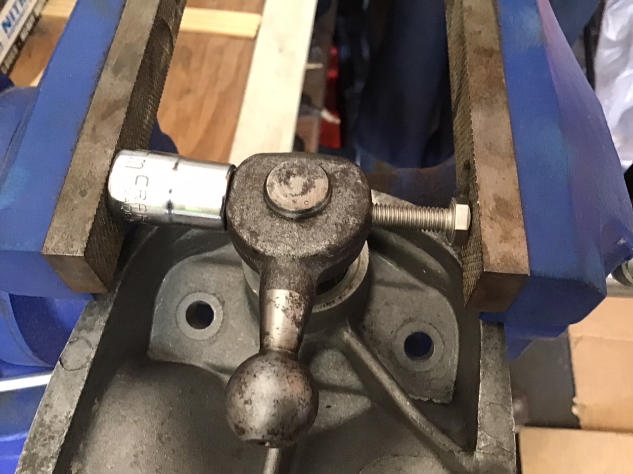

After replacing some of the seals on my side shift trans yesterday, I decided today to tackle the small shift rod seal. This little bugger gave me about a 2 hour plus fight. First I tried a seal puller with no luck, too big for this small seal. I tried a small screw driver, a pick, I drilled a small hole in the top of the seal (very carefully) inserted a screw and tried to pull it out, no go. I used my Dremel tool to carefully cut two notches 180 degrees apart, and then inserted a washer into the notches and slid a long punch through the washer and tried to twist it out, no go. Next, I got the torch out and put some heat to it, tried prying again with several different tools, no go. Finally, I put it in the vise with thin wood strips to protect the part, more heat more prying and it finally gave up.
I started by pressing the roll pin out with a small bolt on one side and a socket on the other. This worked perfectly. I was careful not to press the pin all the way out, as these can be a bugger to get back in.

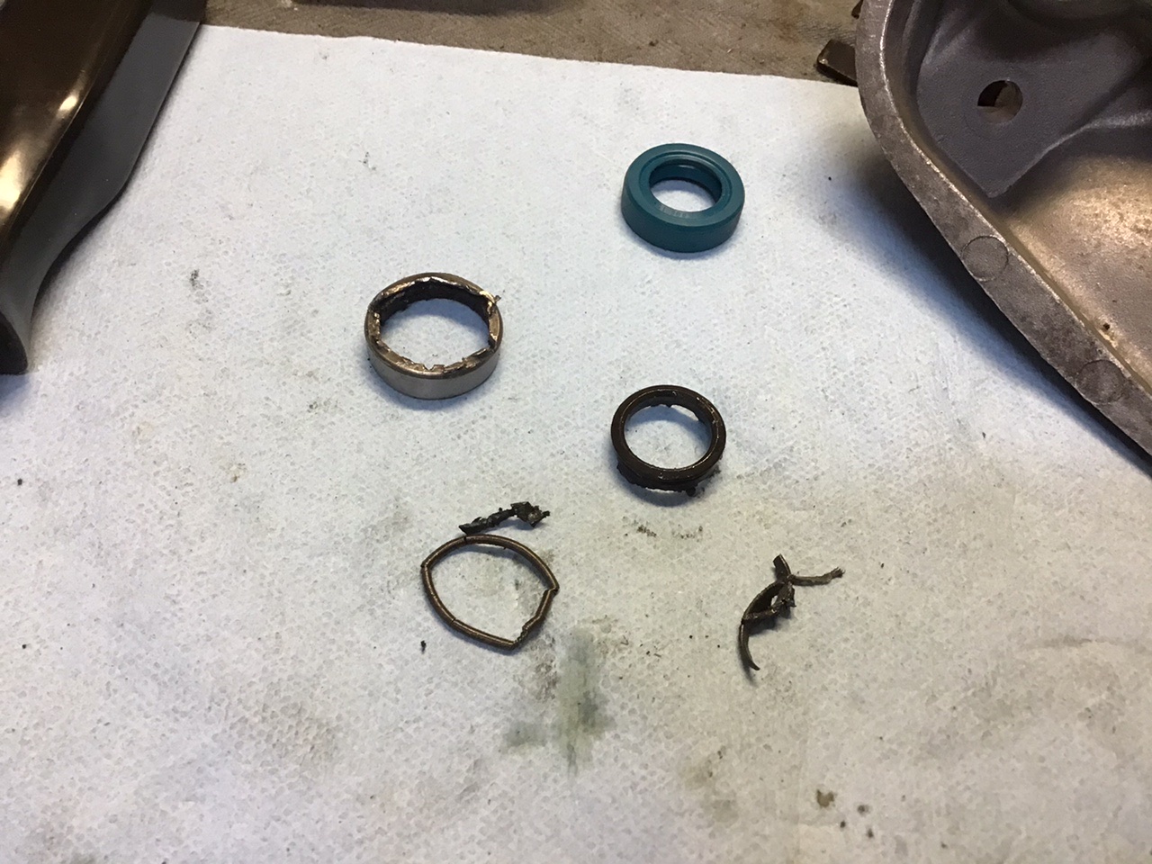

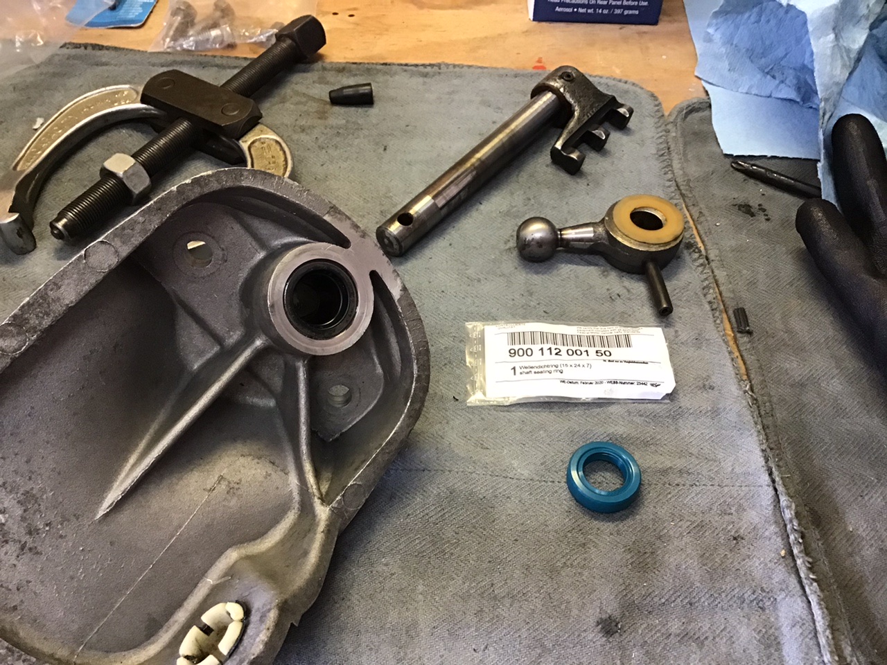

After removing the shift rod, the process of removing the old seal began.

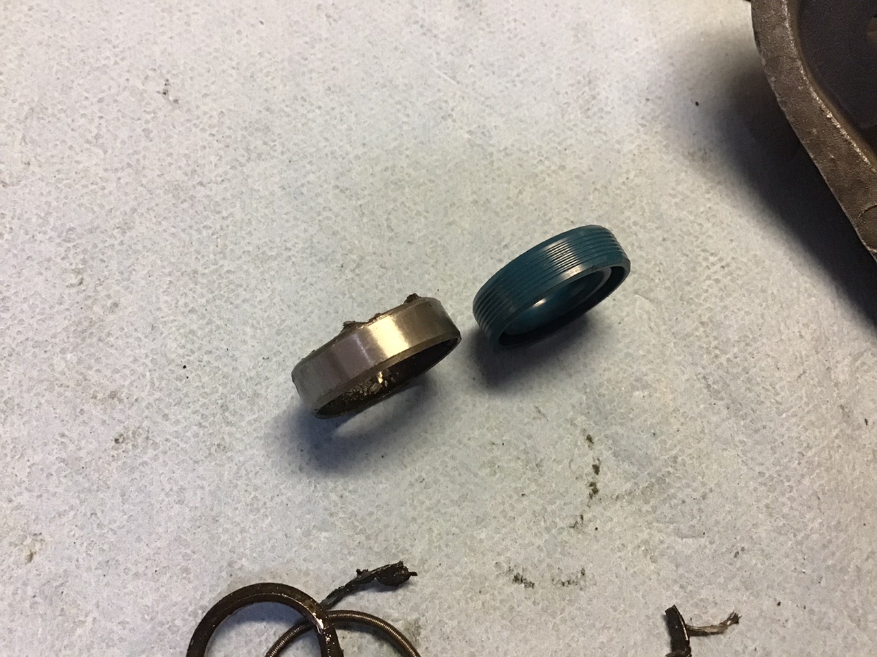

This is what was left after getting the seal out. Notice that the old one was not rubber coated on the side like the new one. Perhaps this is why it was so difficult to get out.
I will install the new seal tomorrow
