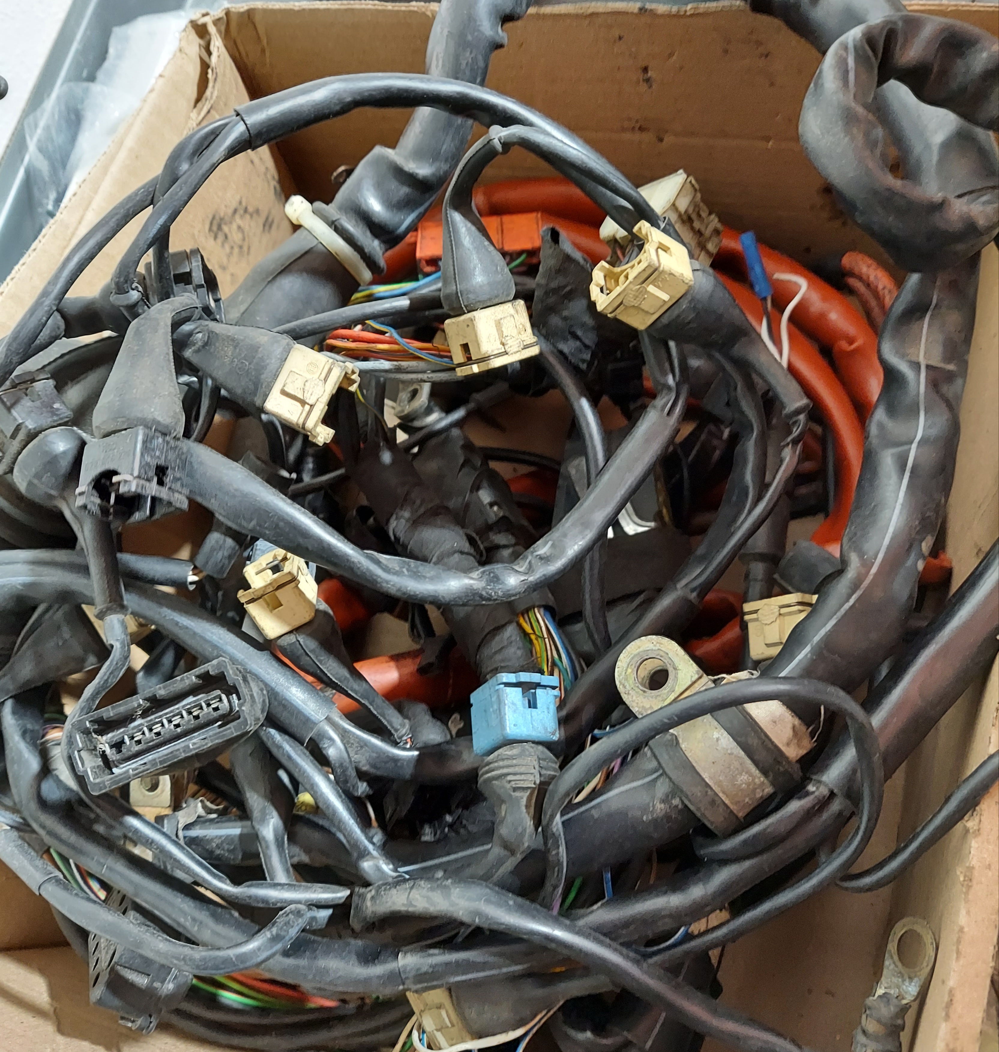

And some replacement harnesses.. I need to check them out and repair as needed but nice to be all set.. I think I might need another harness yet but close. Attached Image

QUOTE(mb911 @ Jan 22 2021, 01:21 AM) *
That is much worse than mine was, but all do able. Looks like it might have been the main positive lead to the charging post that caused it, its not fused and can contact the frame, (the protective sleeve cracks) you get alot of heat fast, and return fuel line is right beside. common enough cause on 928's

QUOTE(ddire333 @ Jan 22 2021, 09:12 AM) *
Likely for sure.. I need to make sure I have all the harnesses I need. Going to make sure the ones going in are in good condition and repair what needs to be done.. I can't wait for spring to at least wash off all the nasty fire damage.
