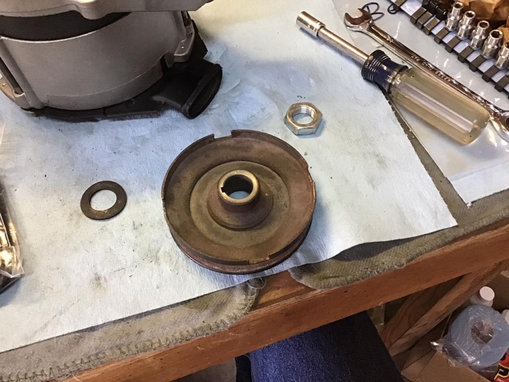

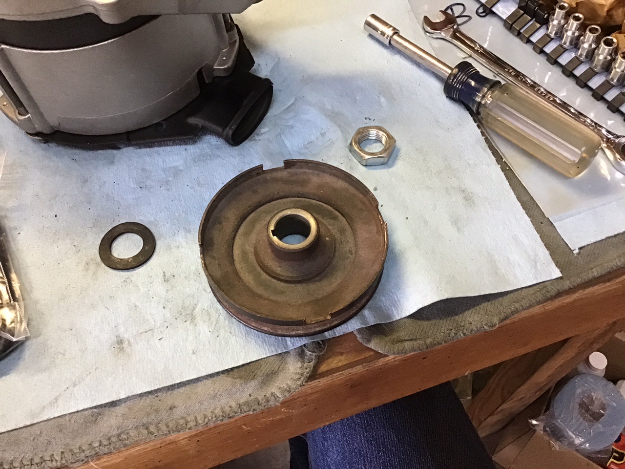

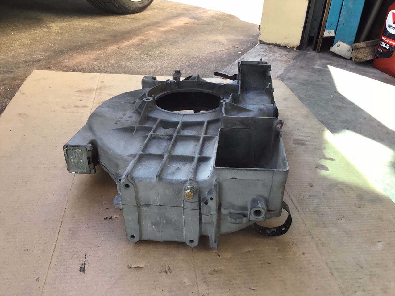

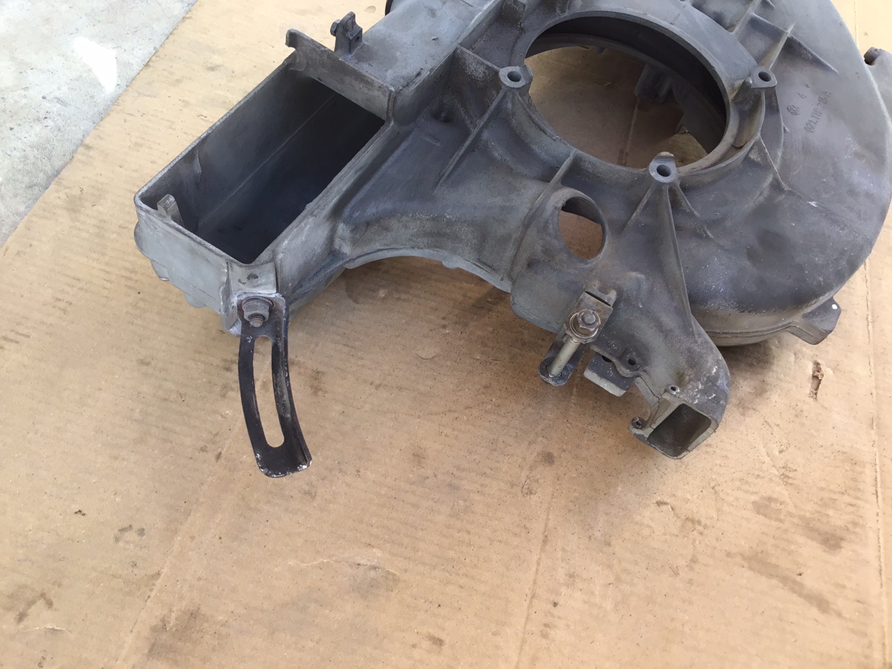

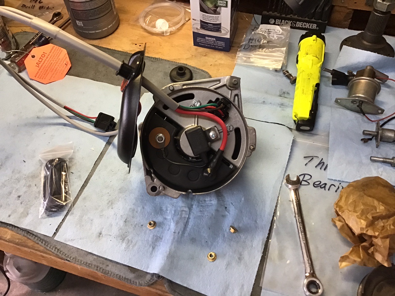

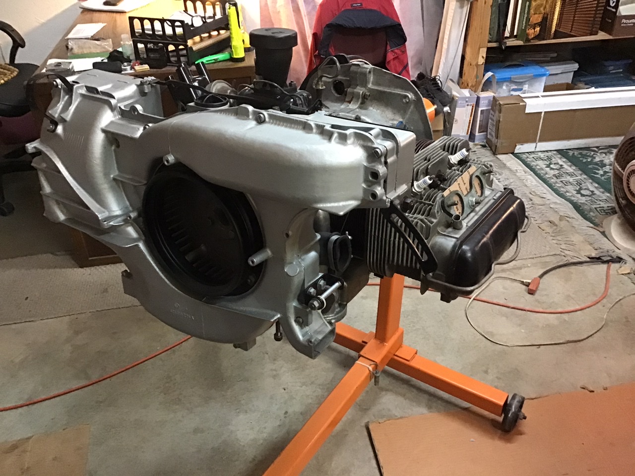

Time to get the fan shroud cleaned up
Decided to pull the trigger on the 123 Dizzy

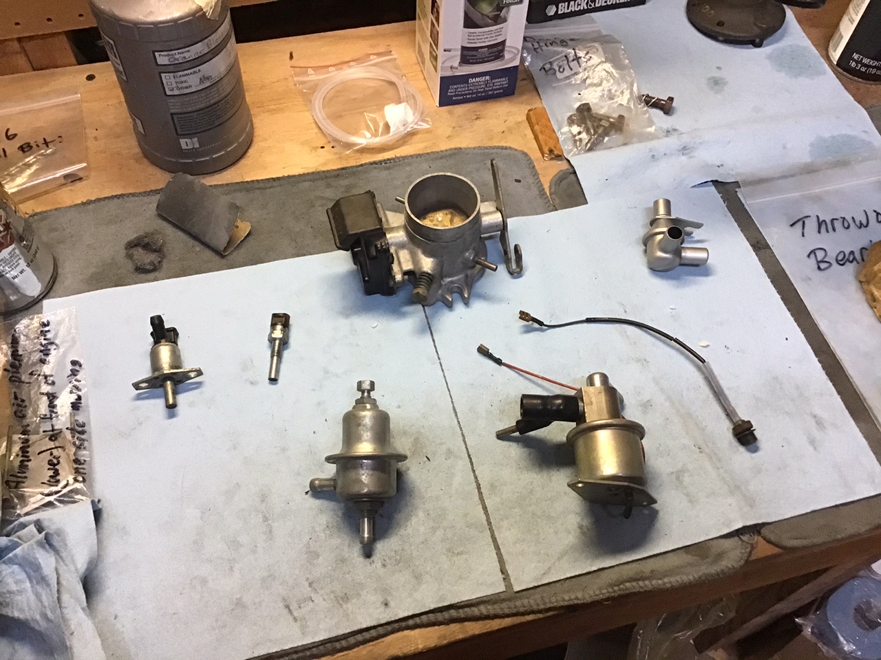

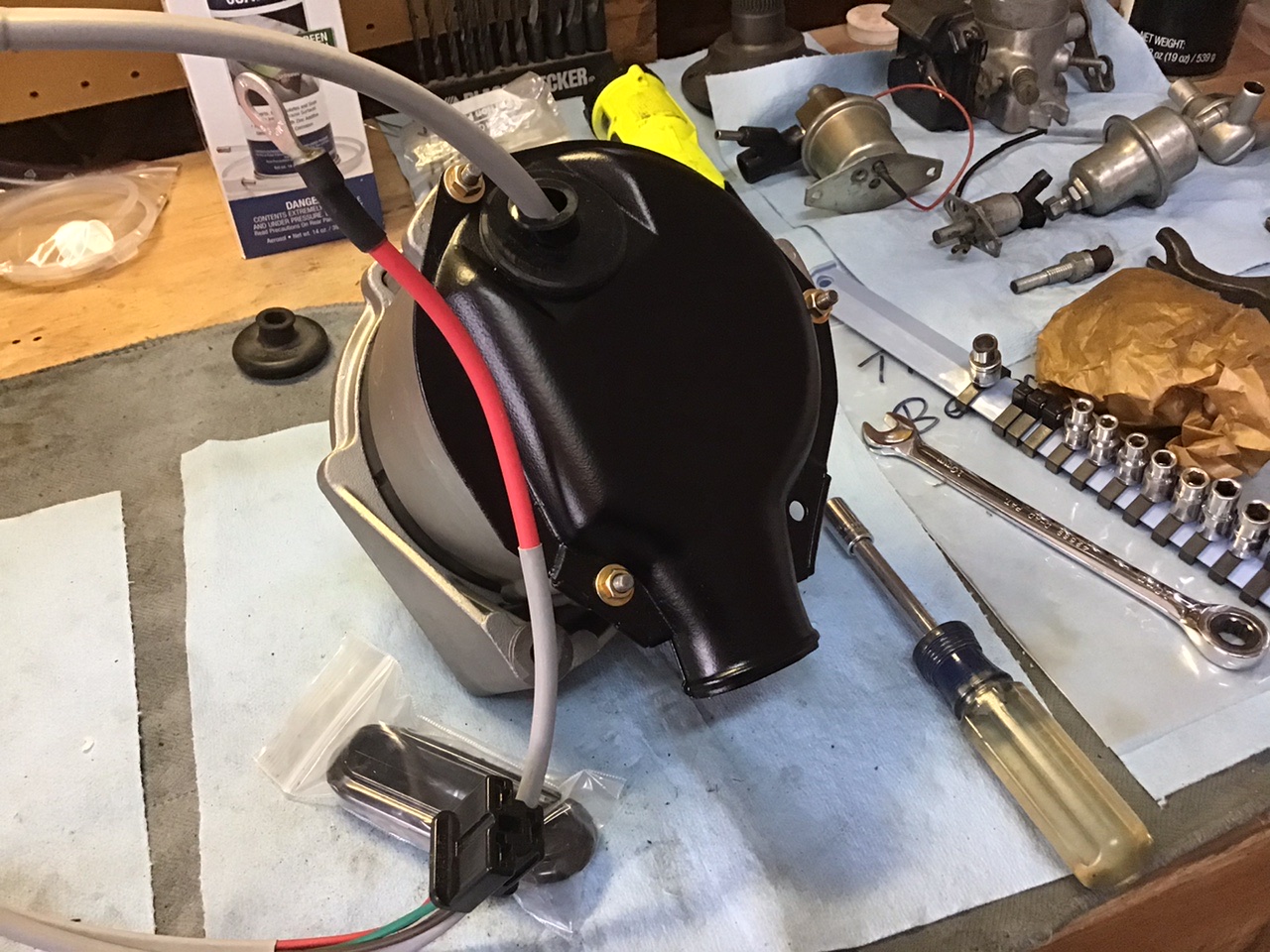

I’m trying to figure out if I have all my bits and pieces for this 2.0 L , I purchased this engine in pieces so I do not have the luxury of photos or bagging and tagging.
Connecting the new alternator wiring harness to the alternator. I love working with clean new parts! I will clean up the pulley and prep for paint.

Morph914   Time to get the engine off the stand so I can marr...   Apr 17 2021, 08:34 PM
bbrock   Looking good! You made the right call install...   Apr 17 2021, 08:48 PM
Morph914   Looking good! You made the right call instal...   Apr 18 2021, 01:39 PM
bbrock   Looking good! You made the right call insta...   Apr 18 2021, 02:17 PM
930cabman   Looking good, keep the progress reports coming, in...   Apr 18 2021, 01:50 PM
930cabman   If it was easy, our kids would do it. Lucky is t...   Apr 18 2021, 02:30 PM
Morph914   I’ve been working on the engine last couple of d...   Apr 28 2021, 07:18 PM
bbrock   Looks like you have the green hose plugged into th...   Apr 28 2021, 09:25 PM
