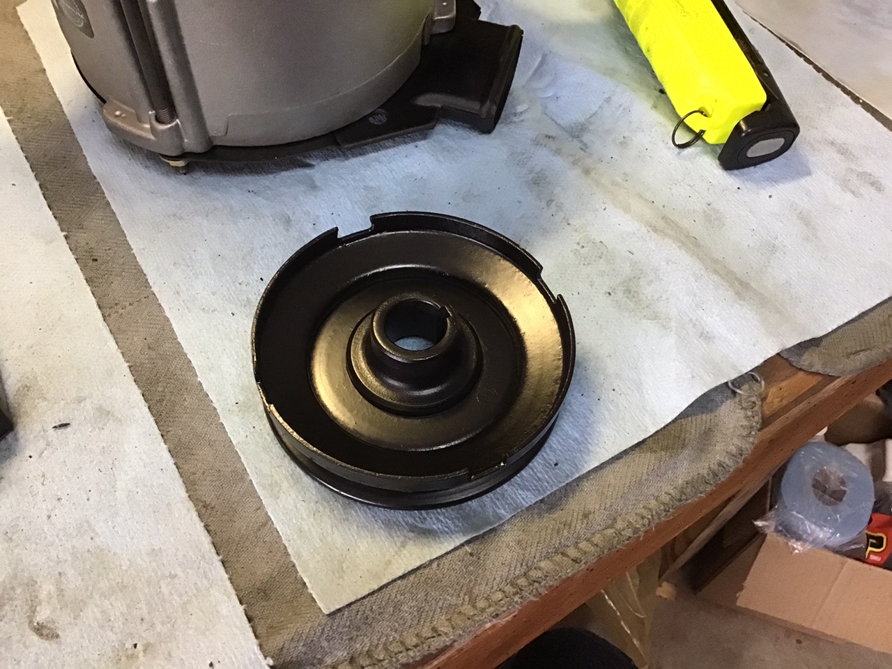

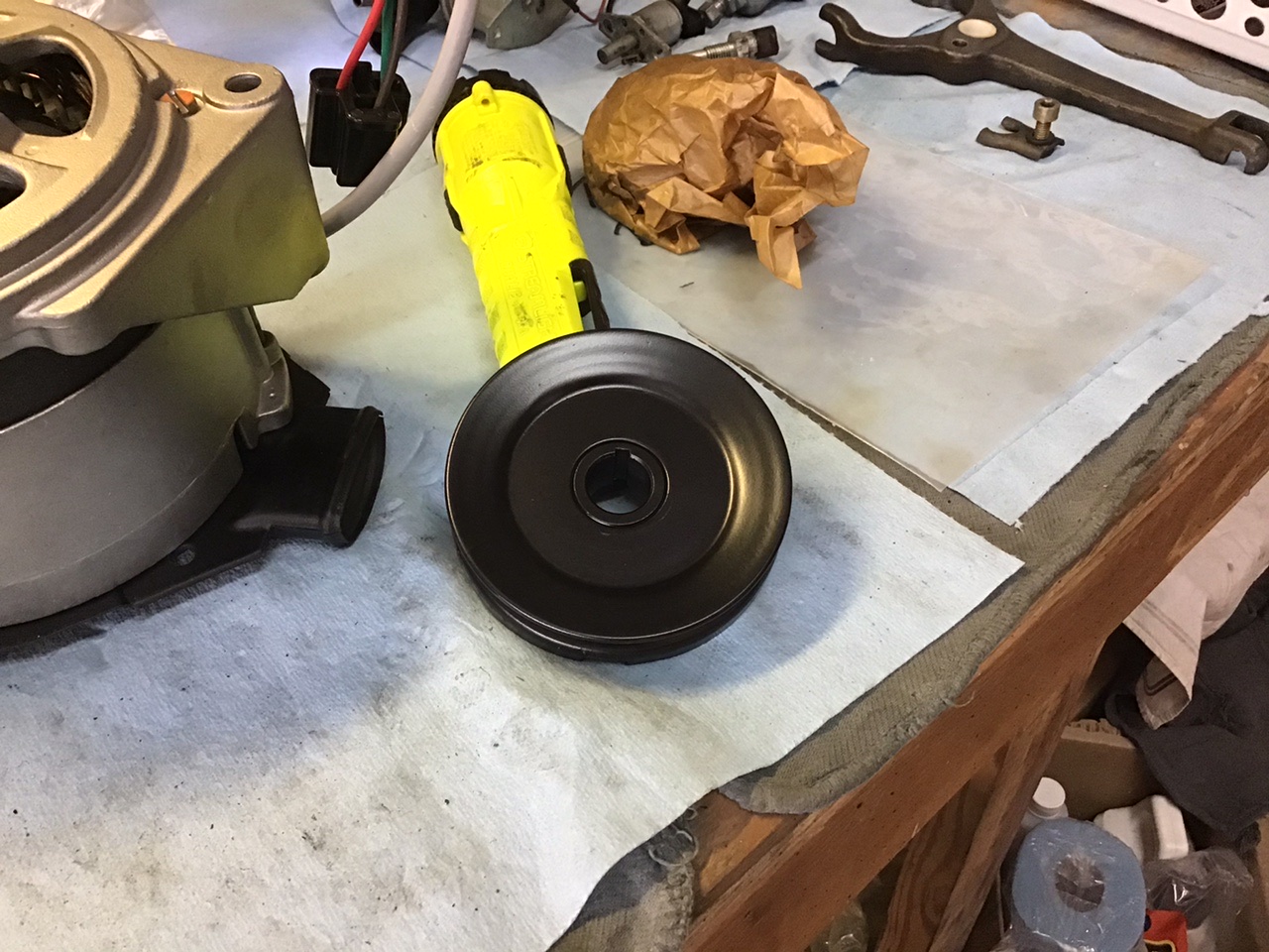

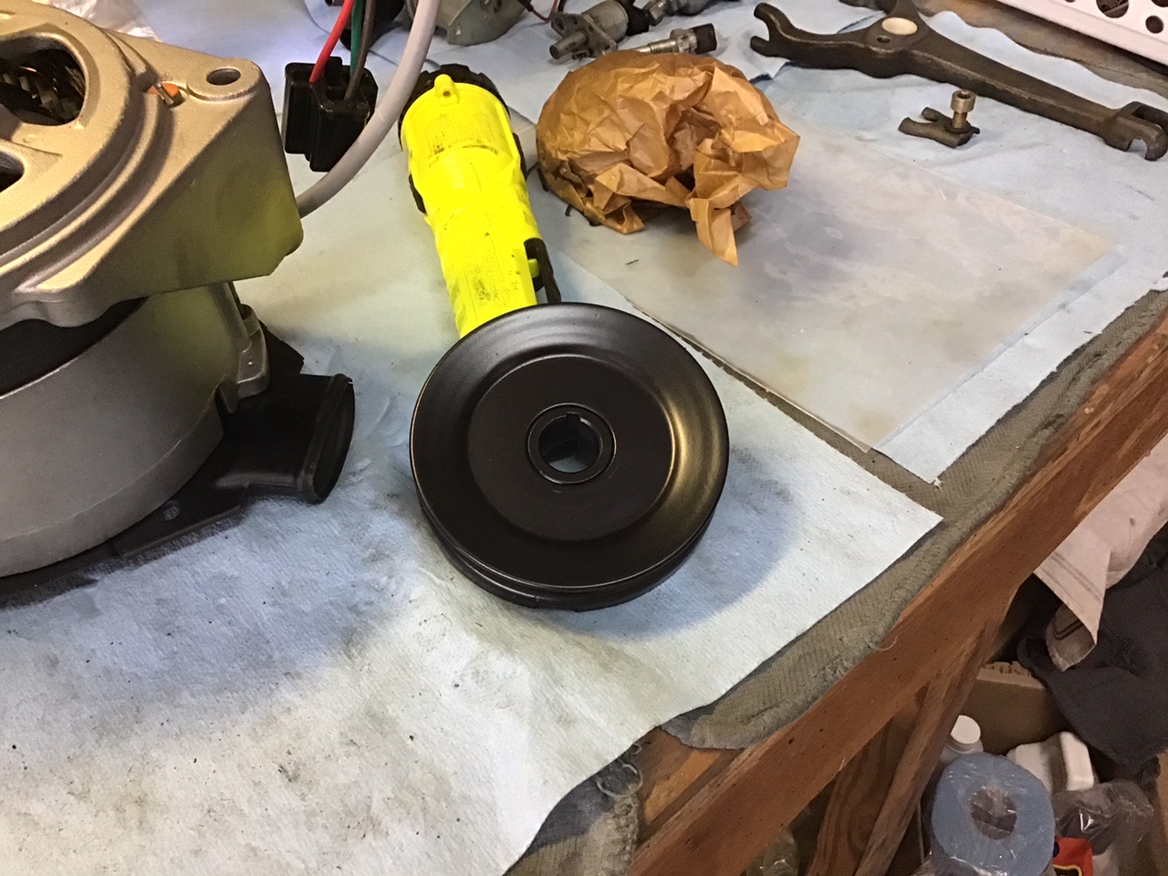

The pulley after fresh paint

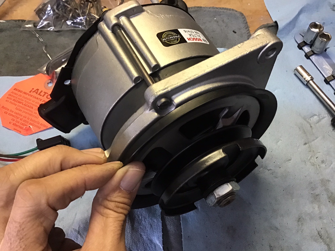

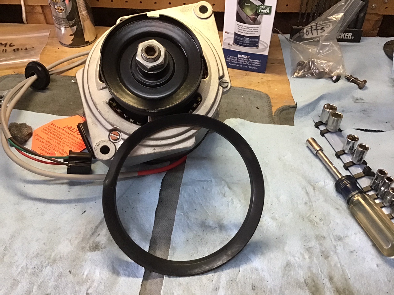

I can’t remember where this plastic piece goes, I seems to fit well here. It did not show in the book so will have to wing it as I assemble.

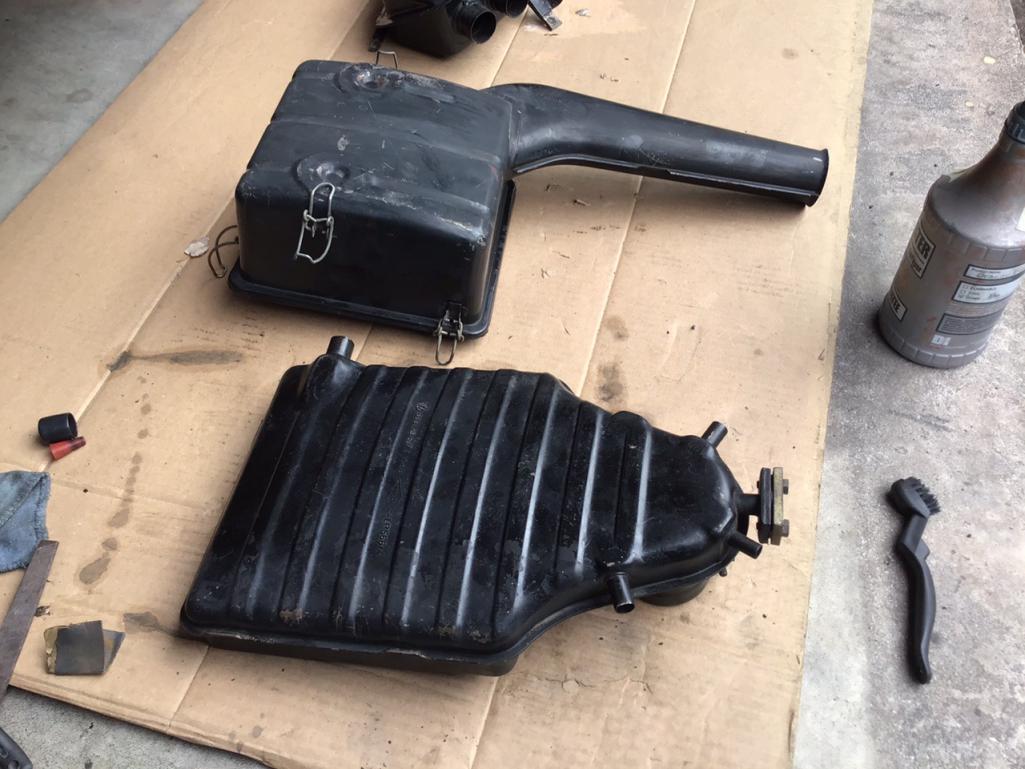

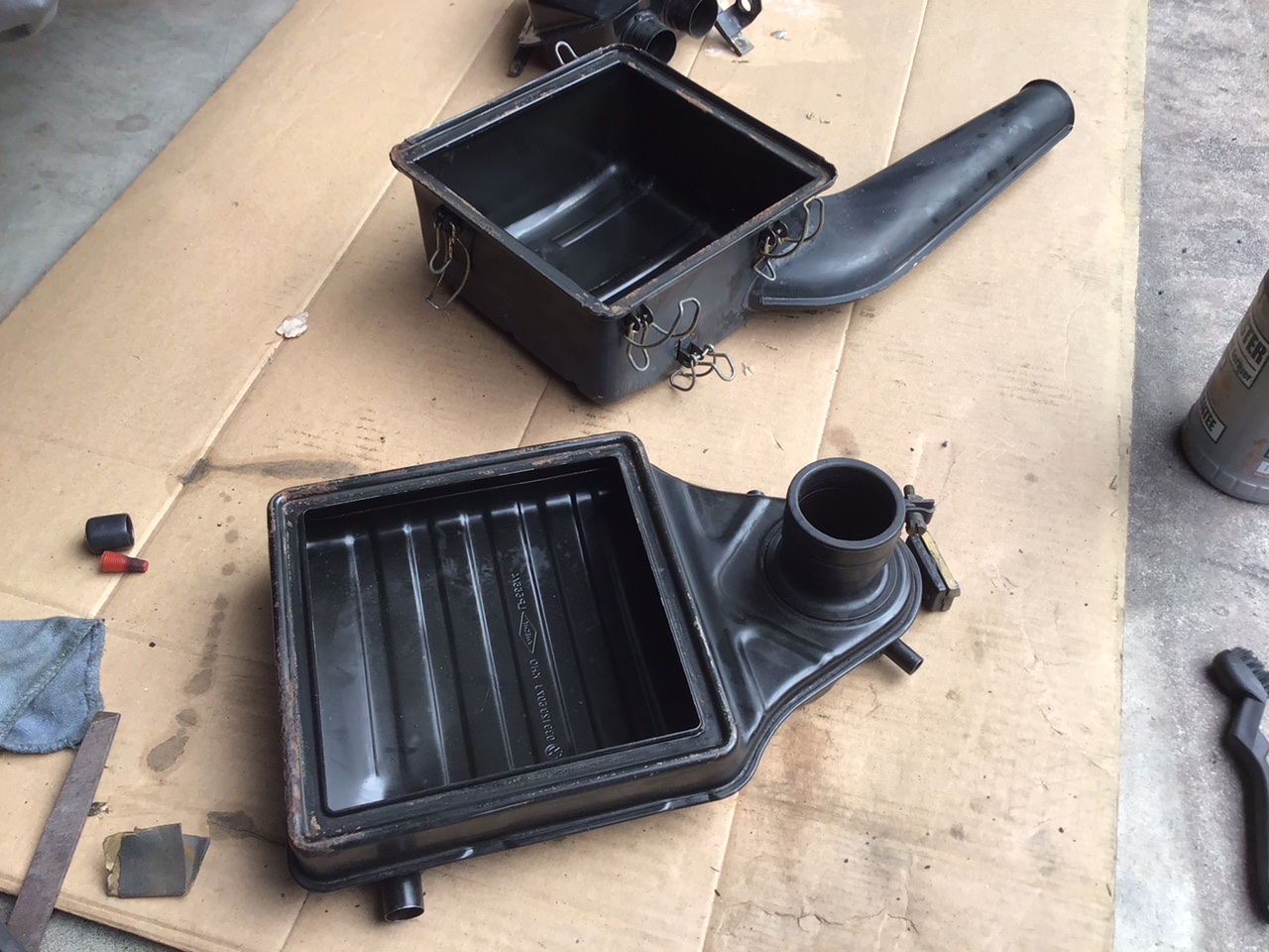

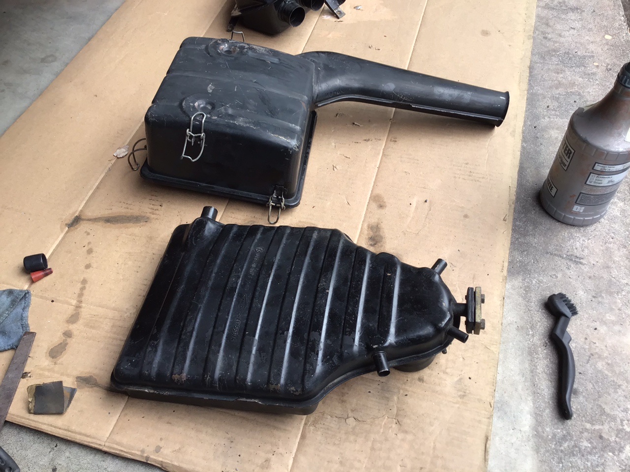

Now getting the air filter housing ready for paint, this should be the last big piece to clean and paint other than the targa top. (IMG:style_emoticons/default/aktion035.gif)

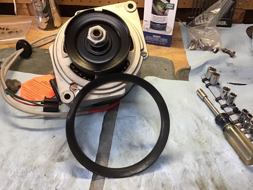

Morph914   Time to get the fan shroud cleaned up Decid...   Jan 24 2021, 05:16 PM
Morph914   The pulley after fresh paint I can’t remem...   Jan 24 2021, 05:33 PM
