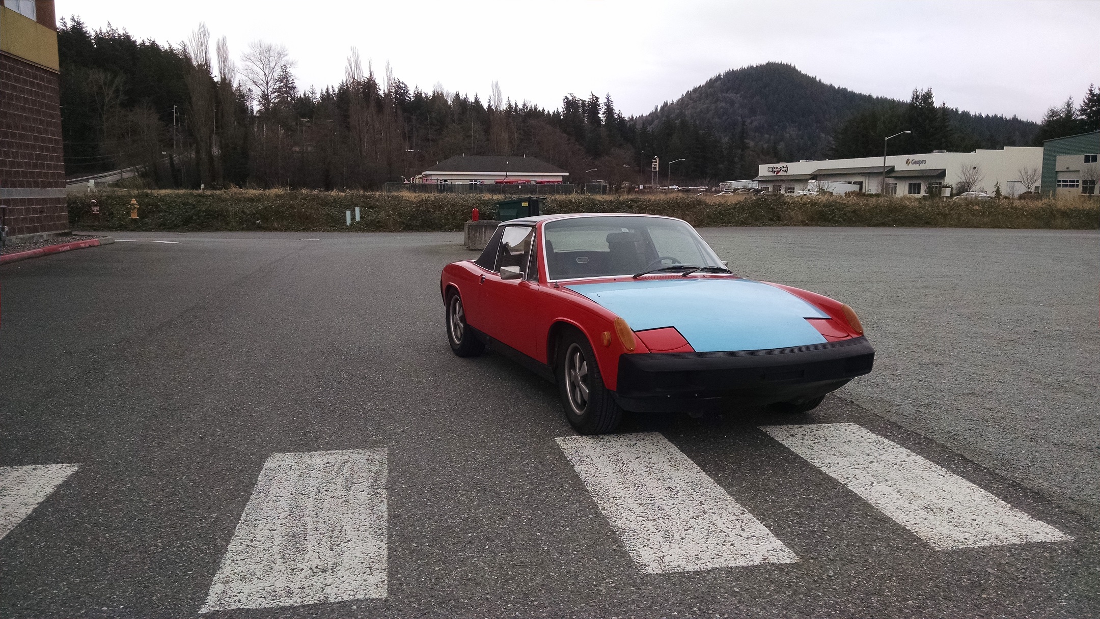

Michelle and I picked up our new to us 914-6 over the weekend. We practiced social distancing and kept safe. Two days home, 920 miles, the 914 never missed a beat.
Here's a picture at a rest stop about 30% of the way home.

Sourced a nicer hood as the original hood would have required a lot of work. Thanks Rich @914Werke for the parts.
Looking worse before it'll get better with paint. Getting closer to taking it all apart for body work.
Nice to drive it over the weekend.
