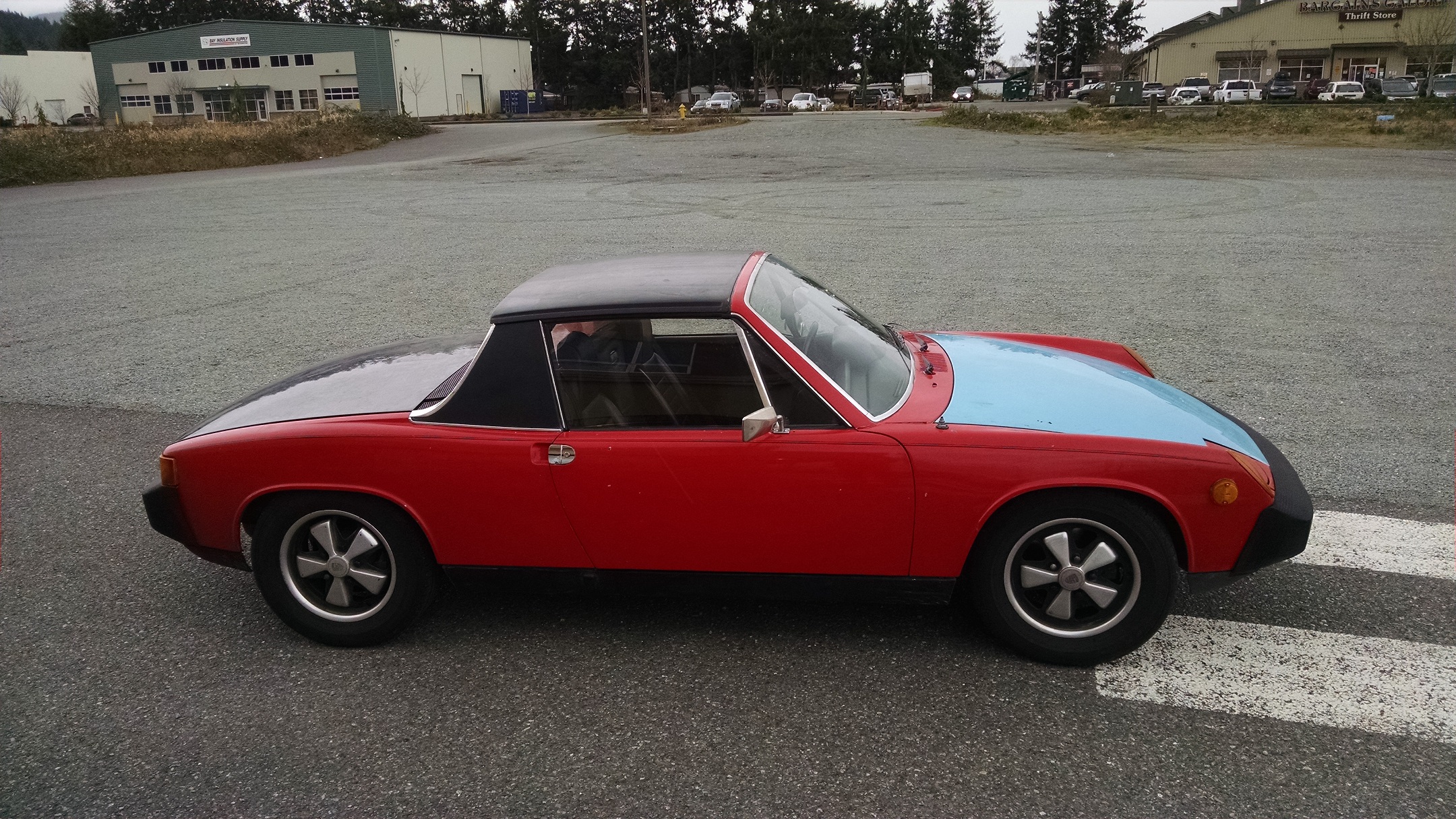

Michelle and I picked up our new to us 914-6 over the weekend. We practiced social distancing and kept safe. Two days home, 920 miles, the 914 never missed a beat.
Here's a picture at a rest stop about 30% of the way home.

Another picture showing all the colors. (IMG:style_emoticons/default/smile.gif)
