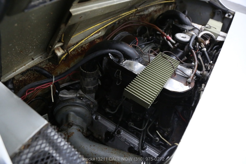

I ran across a listing on EBAY Item #224348635275 on a 1974 Porsche 914 with a 1967 911S 2.0L engine installed etc. The 67 911S engine was a sportier 2.0L engine Porsche that put out reportedly 180 hp, with 144 lb torque. Looking at the overall car it looks pretty rough! Looks like someone has put the oil tank in the front compartment and not real sure whats going on in the engine compartment. If someone has the time could they look at this listing and give me your thoughts. I have asked the seller to clearify what’s going on in the engine compartment and some engine numbers, no reply.

dr914@autoatlanta.com   total disaster, but worth the money for the parts....   Feb 13 2021, 01:36 PM

PlaysWithCars   Wow. Somebody started quite the science project on...   Feb 13 2021, 01:41 PM

gandalf_025   Seriously doubt it is a 67 S engine.. Mechanical F...   Feb 13 2021, 02:42 PM

rhodyguy   What's in that package above the trailer hitch...   Feb 13 2021, 02:53 PM
9144me2enjoy   I made contact with a salesman who is suppose to g...   Feb 13 2021, 03:08 PM

sixnotfour   The Oil Tank is a one year only 1972 911, Too bad ...   Feb 13 2021, 03:54 PM

mb911   Would it be an aluminum case 2.0?   Feb 13 2021, 04:11 PM
Cairo94507   Beverly Hills Car Club never saw a POS that in the...   Feb 13 2021, 04:12 PM
9144me2enjoy   I believe in 67-68 they were Aluminum cases. If so...   Feb 13 2021, 04:18 PM
mb911   I believe in 67-68 they were Aluminum cases. If s...   Feb 13 2021, 04:19 PM
mepstein   I believe in 67-68 they were Aluminum cases. If s...   Feb 13 2021, 04:21 PM
sixnotfour   I believe in 67-68 they were Aluminum cases. If ...   Feb 13 2021, 06:21 PM
stownsen914   Why do the underside pics show what looks like a 9...   Feb 13 2021, 08:40 PM

sixnotfour   I didn't see a reference to S.. a 67 case is w...   Feb 13 2021, 05:37 PM

bretth   Maybe it is one of those 500hp 2.1 RSR turbo race ...   Feb 13 2021, 08:40 PM
roblav1   I'll take a swag that it's not an aluminum...   Feb 13 2021, 09:00 PM

PlaysWithCars   Why do the underside pics show what looks like a ...   Feb 14 2021, 01:38 AM

stownsen914   I'm guessing the engine is a mongrel. If the c...   Feb 14 2021, 06:27 AM

9144me2enjoy   The only partial numbers I’ve received they said...   Feb 14 2021, 09:19 AM
Tdskip   The only partial numbers I’ve received they sai...   Feb 14 2021, 09:45 AM
rgalla9146   The wheels appear to be flat 6s '72> ...   Feb 14 2021, 10:11 AM
PlaysWithCars   :agree: I was thinking 72 donor car except the th...   Feb 14 2021, 10:30 AM

gereed75   Wow. As unlikely as it first seems, this appears ...   Feb 14 2021, 11:39 AM

9144me2enjoy   Well today I got back with the salesman at BHCC (J...   Feb 15 2021, 08:26 PM
