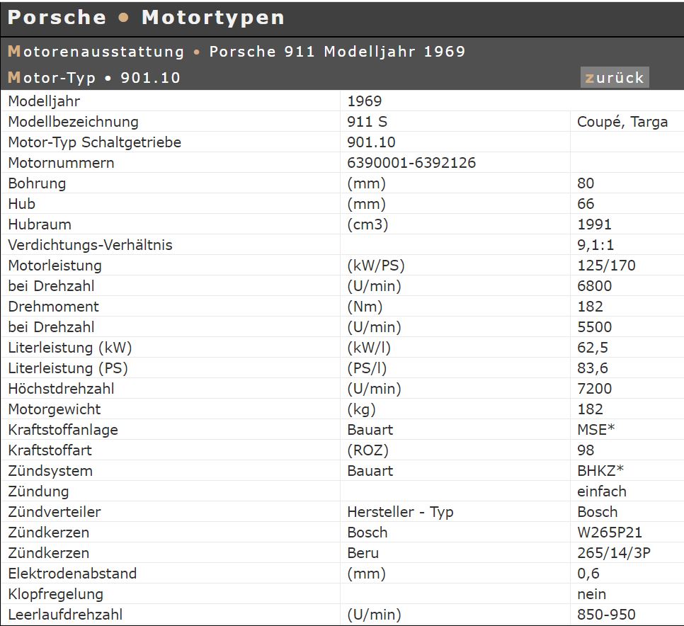

I wonder if my engine is identical as the one you’ve been talking about?
I bought my 914 in May 1970 with a 4-cylinder engine, later I bought a 1969 6-cylinder MFI (engine no. 6390039) in Germany in 1971 and then put that engine in my 914.
After driving the 914 for about 15 years, the car was stored in around 1985
A few years ago I took it out again, completely disassembled it and had it sandblasted.
Lately I have been busy welding in new sheet metal, putting in some new parts and I have been hoping to start driving the 914 again within a few years.
But reading this thread, I’ve started wondering: If my engine is really worth that much, wouldn't I be better off selling this engine and installing a 4-cylinder or a even a cheaper 6-cylinder?
