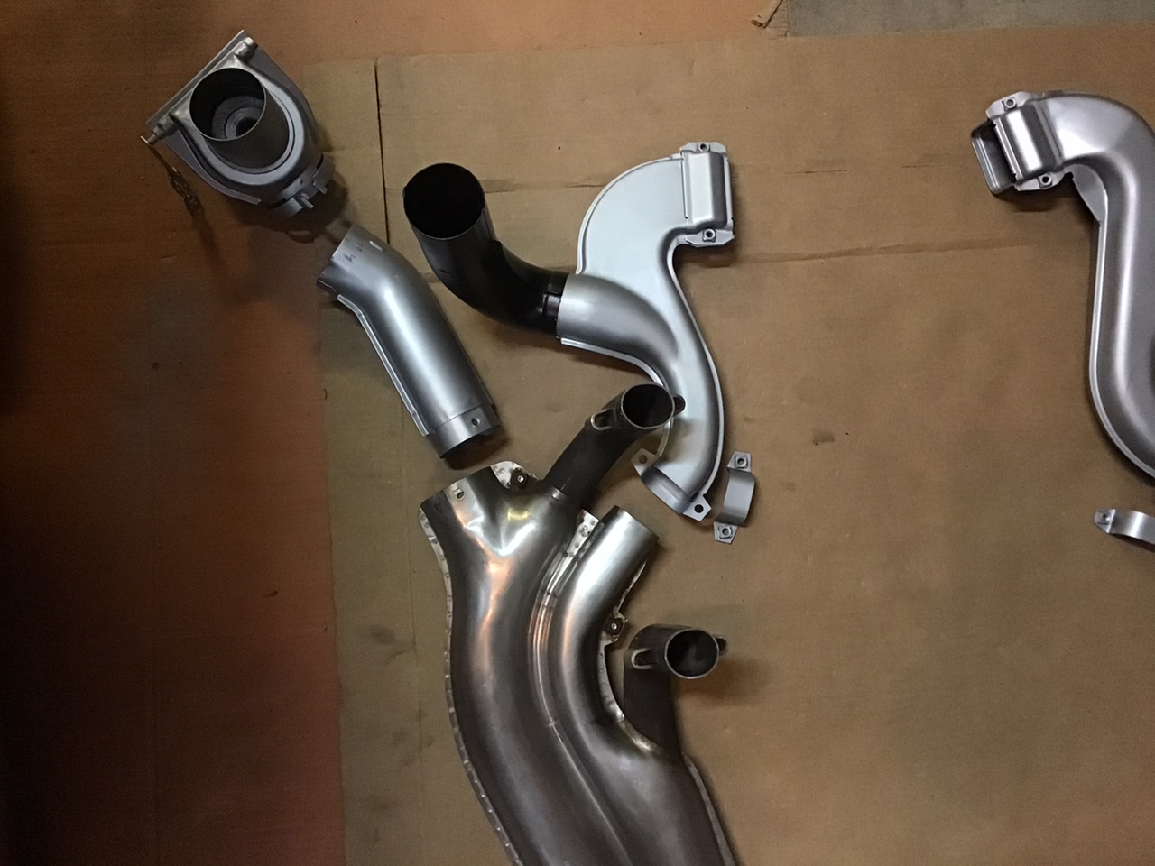

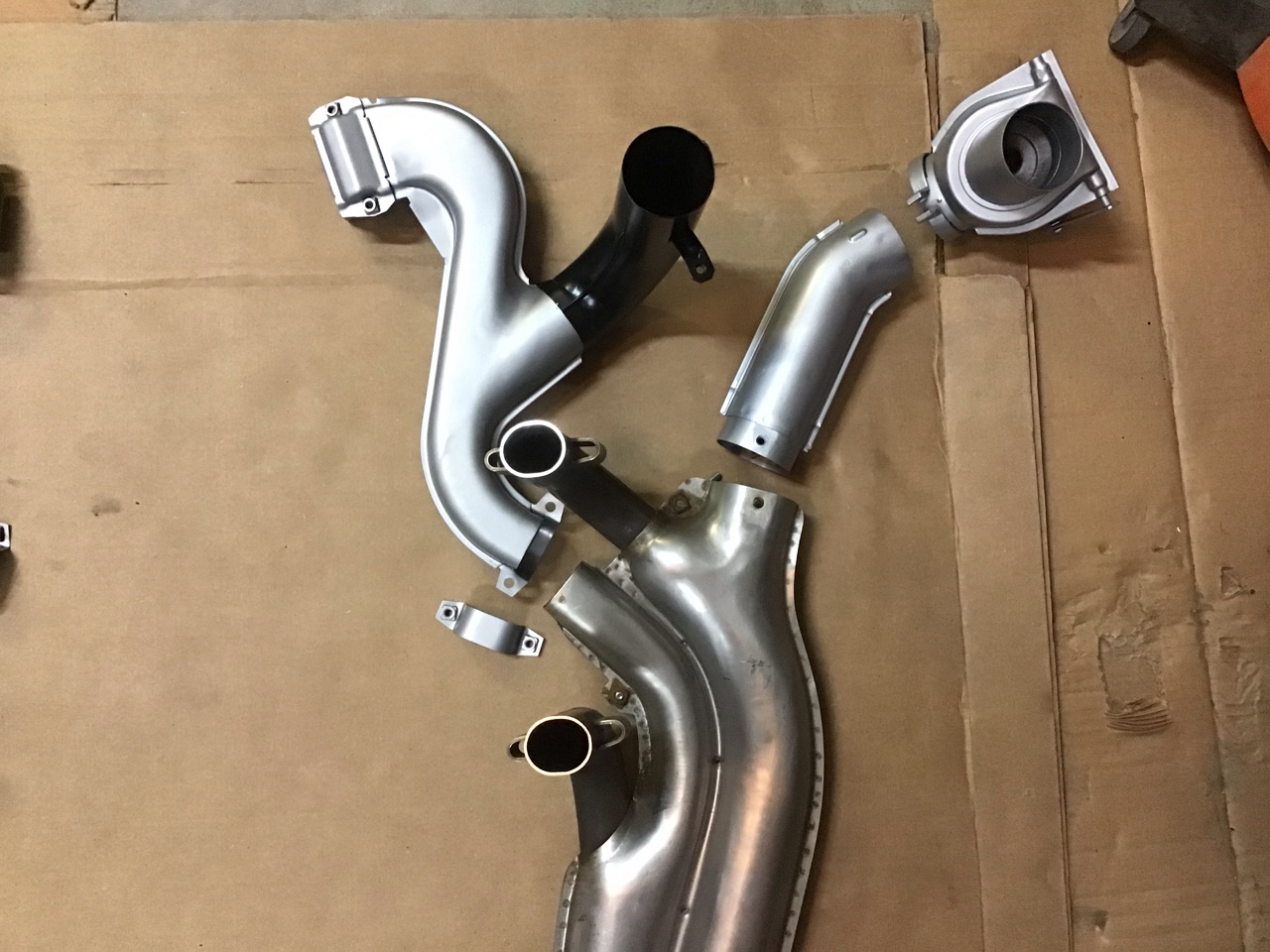

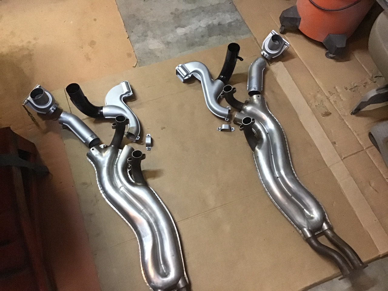

Trying to figure out if I have all my heater parts and pieces.

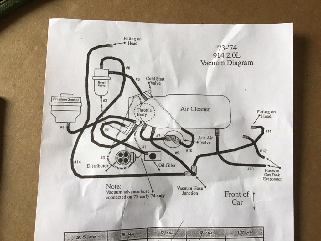

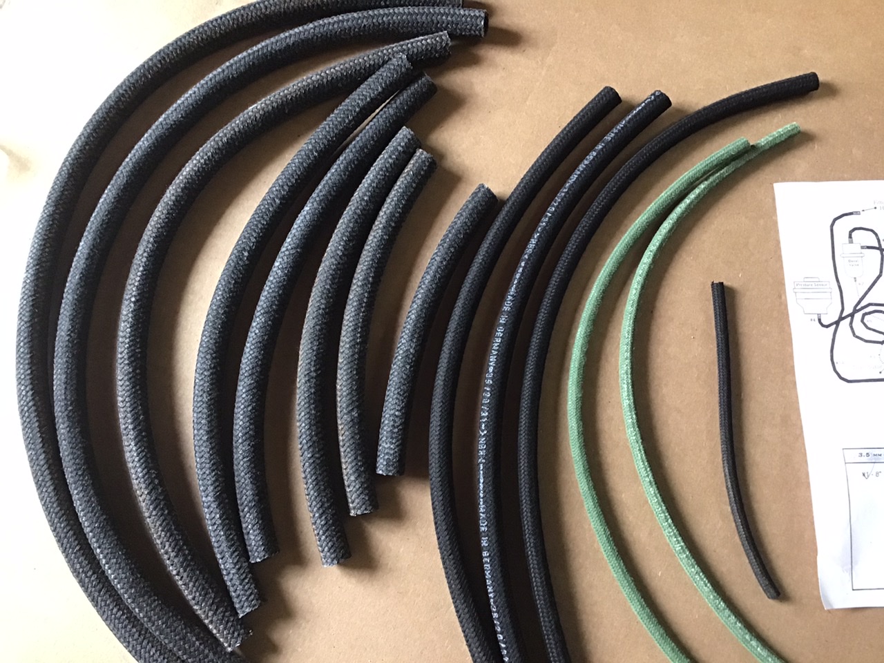

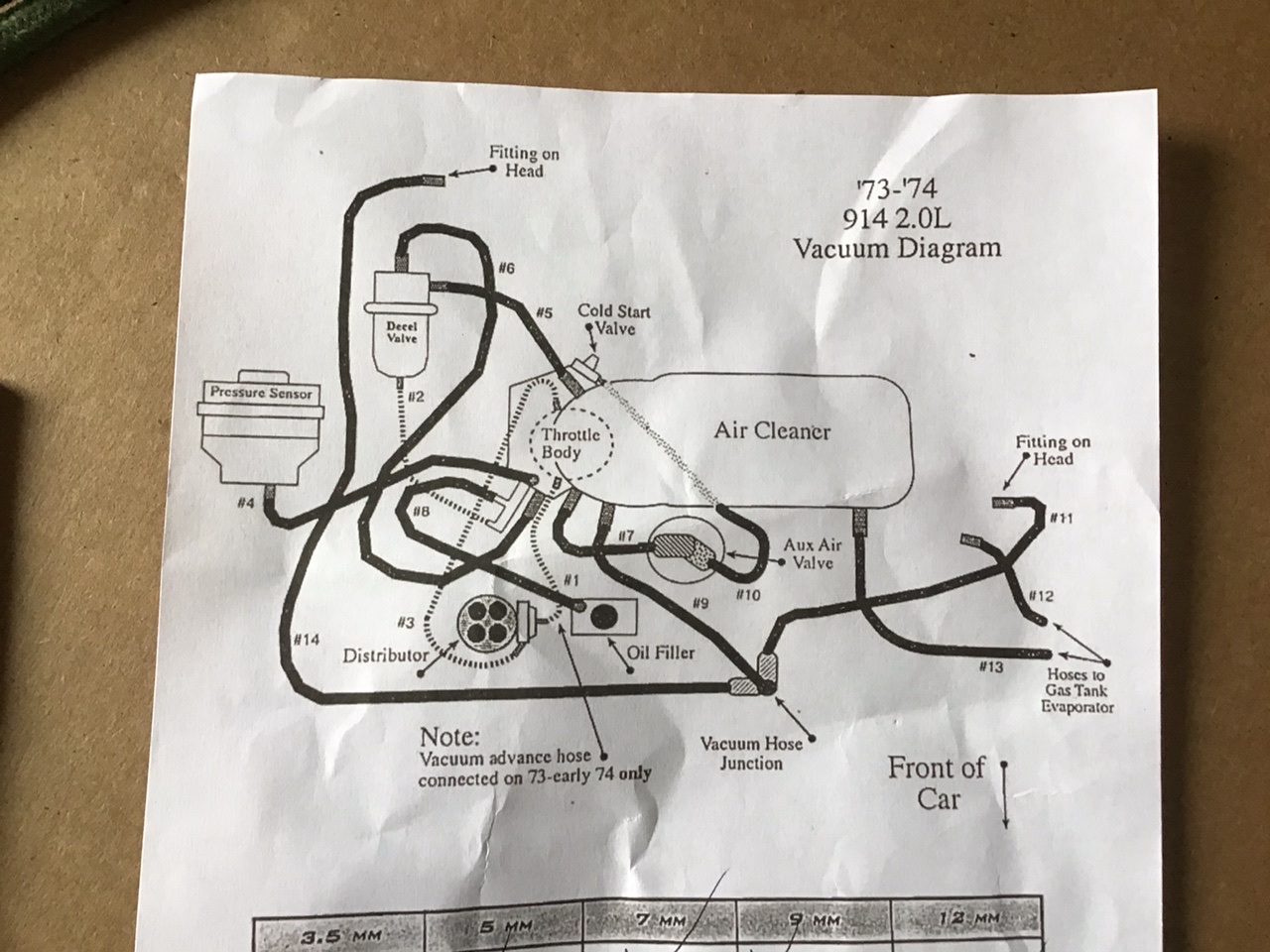

Also got this vacuum line kit for the 2.0L at AA, I wish it had the red lines included. I may have to use bbrocks method for changing these to the red color.
I think 914 Rubber may now be carrying the red lines...
I wish this diagram was color coded so I know which lines need to be red.
