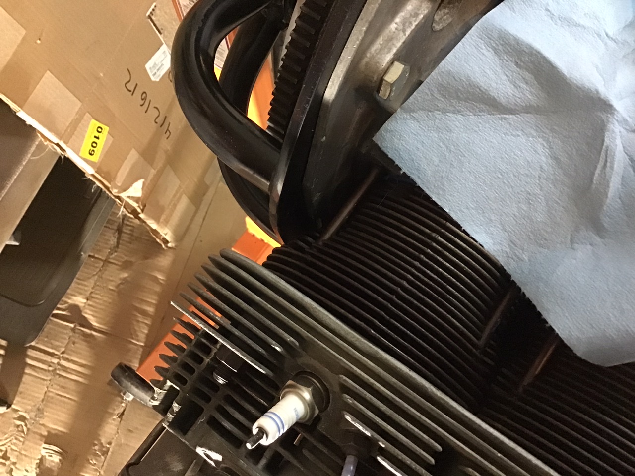

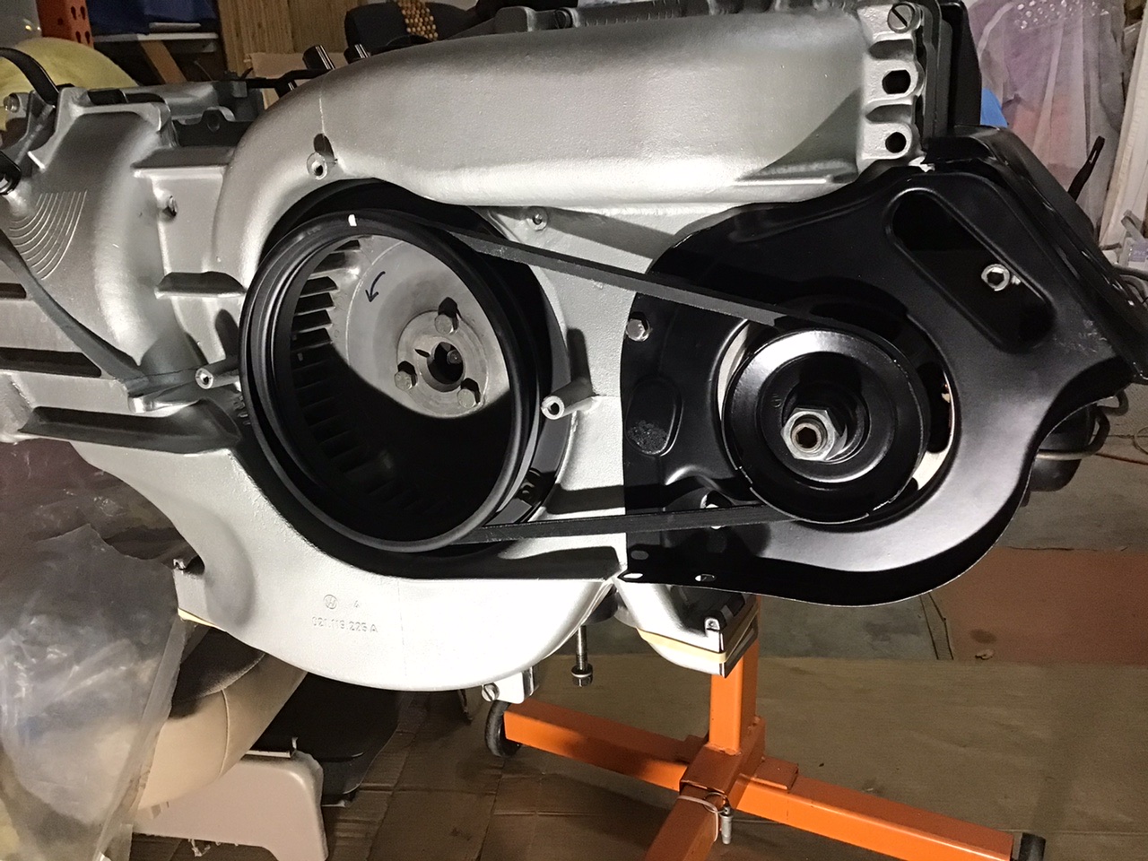

I was making fairly good progress today until my four arm engine attachment interfered with the right side tin going on.
I was able to get the alternator, some of the left side tin, the 123 distributor installed before the road block. I will need to get some kind of hoist to lift the engine off the stand so I can rotate the arm 180 degrees and then put it back on the stand. I’ll then continue with the assembly.

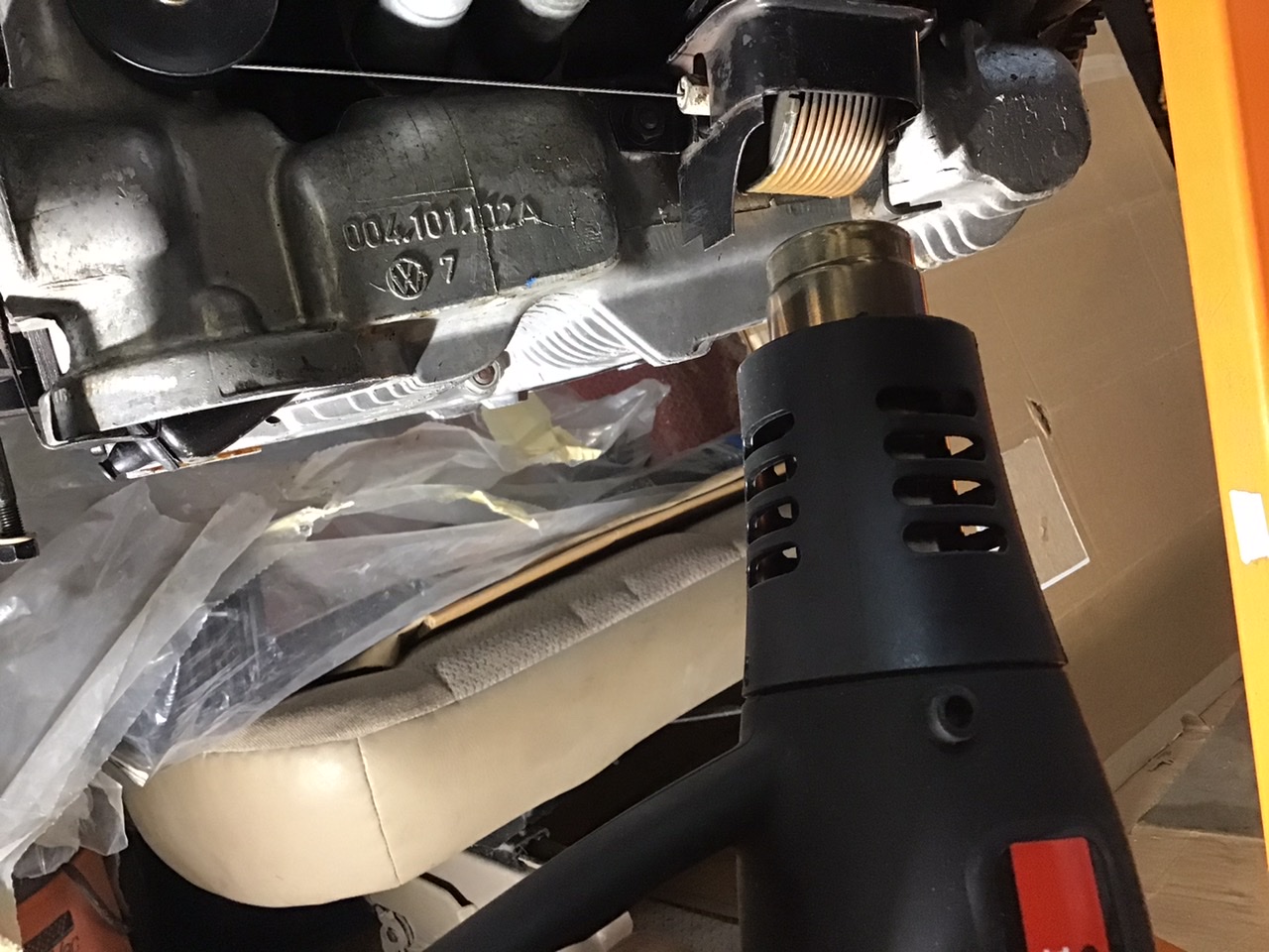

I tested the thermostat with a heat gun to make sure it works, and it was satisfying to see it work as designed.

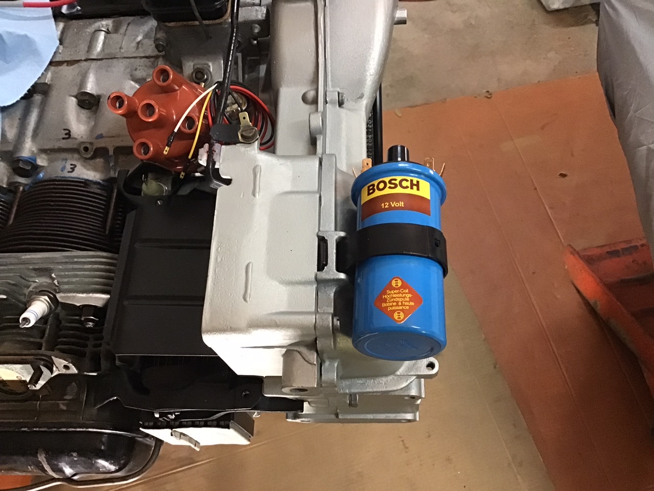

Is there any benefit to mounting the coil here versus on top of the tin? I have both mounts, so I can go either way. I kind of like this one better.
John, do you have a part number for the fan shroud coil mount?

barefoot   Is there any benefit to mounting the coil here ver...   Mar 3 2021, 07:11 AM
anderssj   Is there any benefit to mounting the coil here v...   Mar 3 2021, 09:50 AM
Morph914   Is there any benefit to mounting the coil here ...   Mar 3 2021, 07:45 PM
