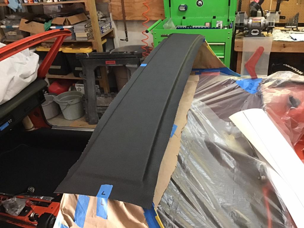

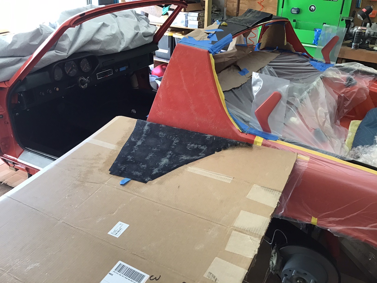

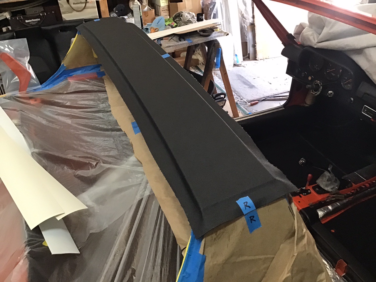

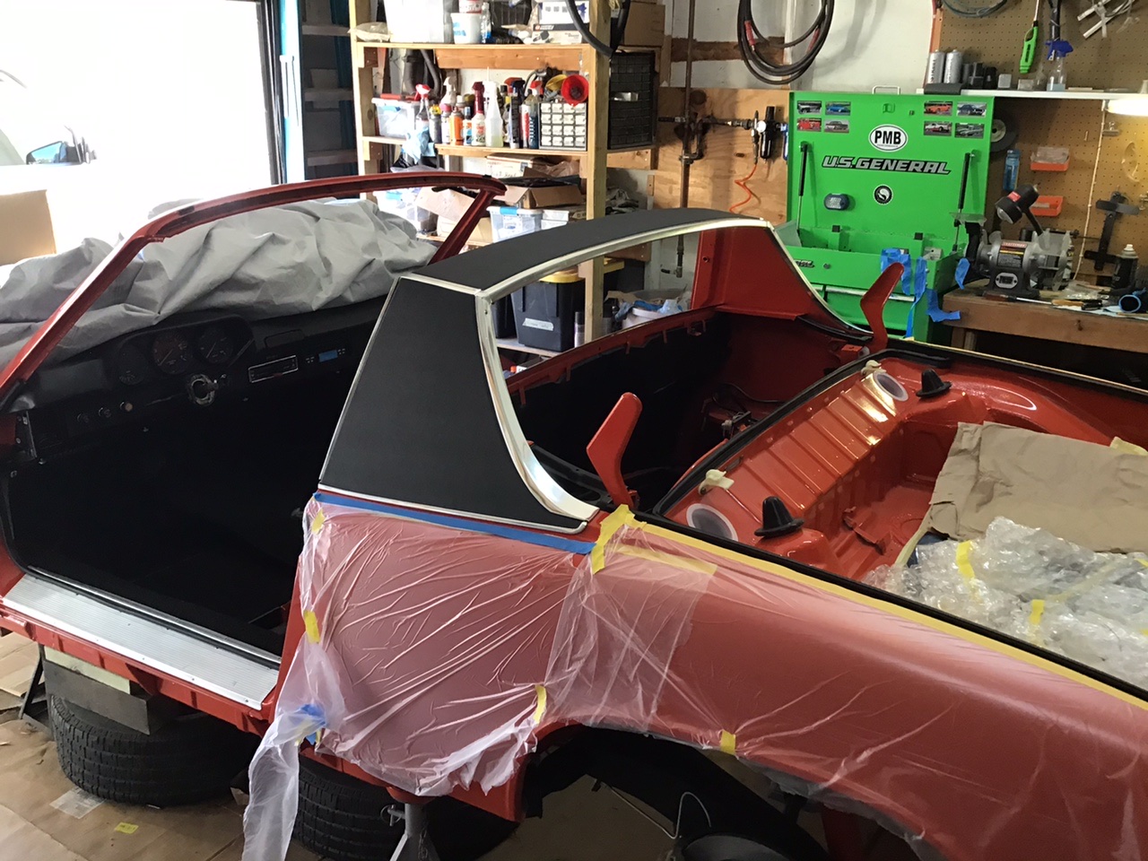

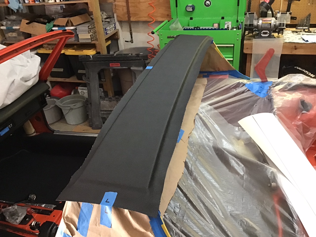

Started on the vinyl last week, the weather has been in the 70s with low humidity, so need to take advantage. I am trying to finish anything that needs to be painted or glued before the heat and humidity set in.
I was super stoked on how the vinyl turned out and happy to have that behind me.

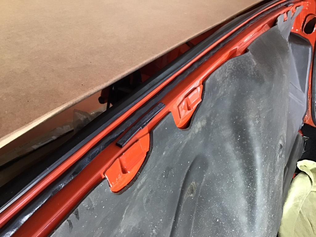

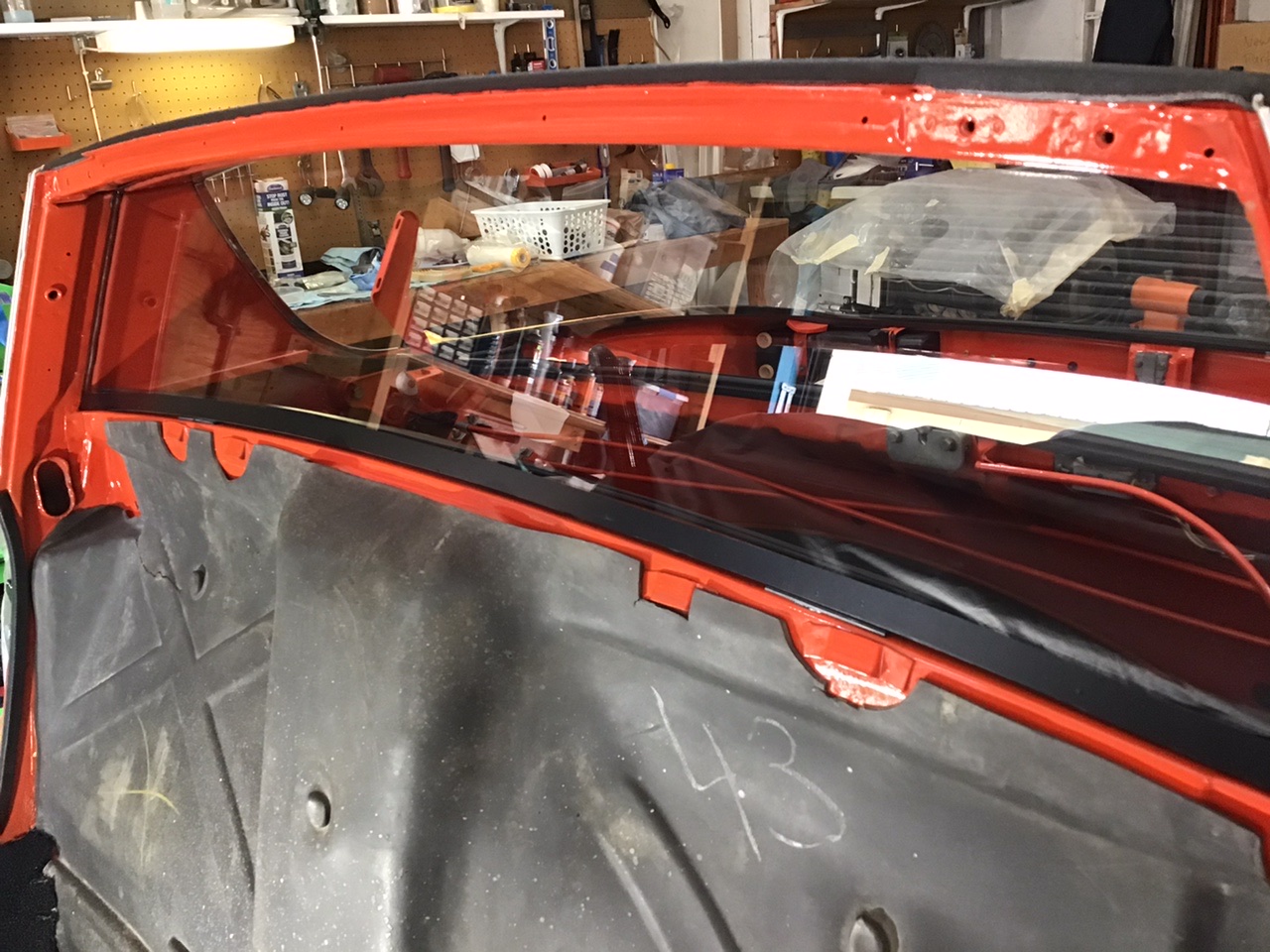

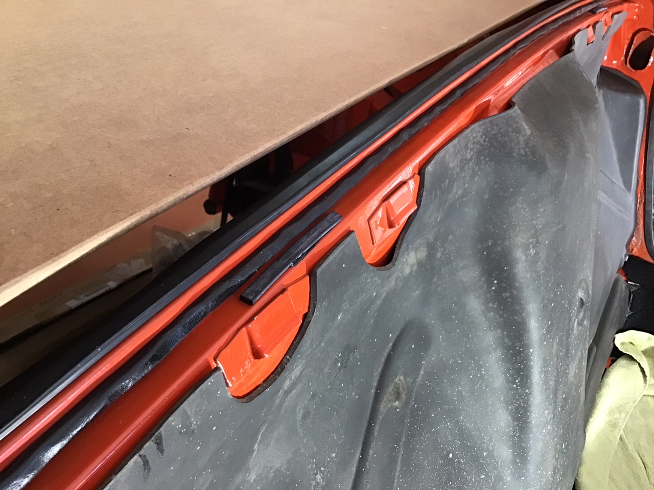

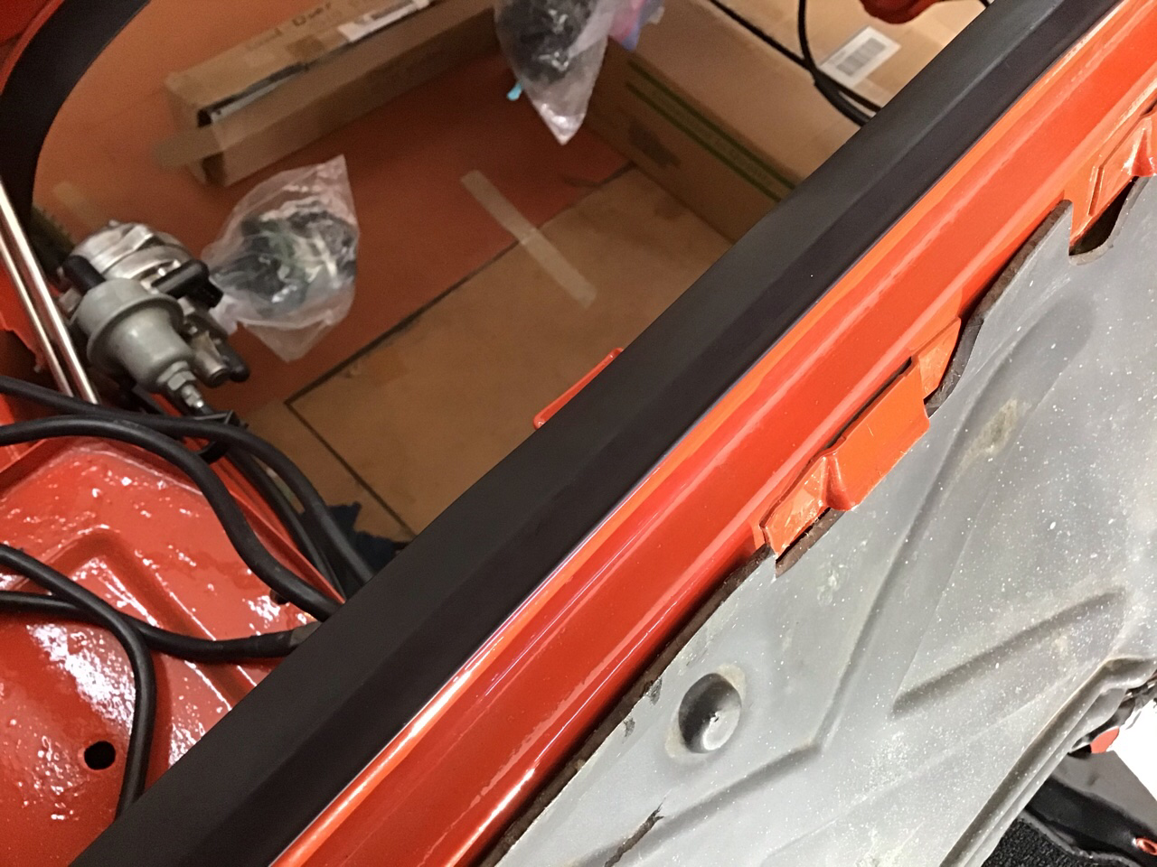

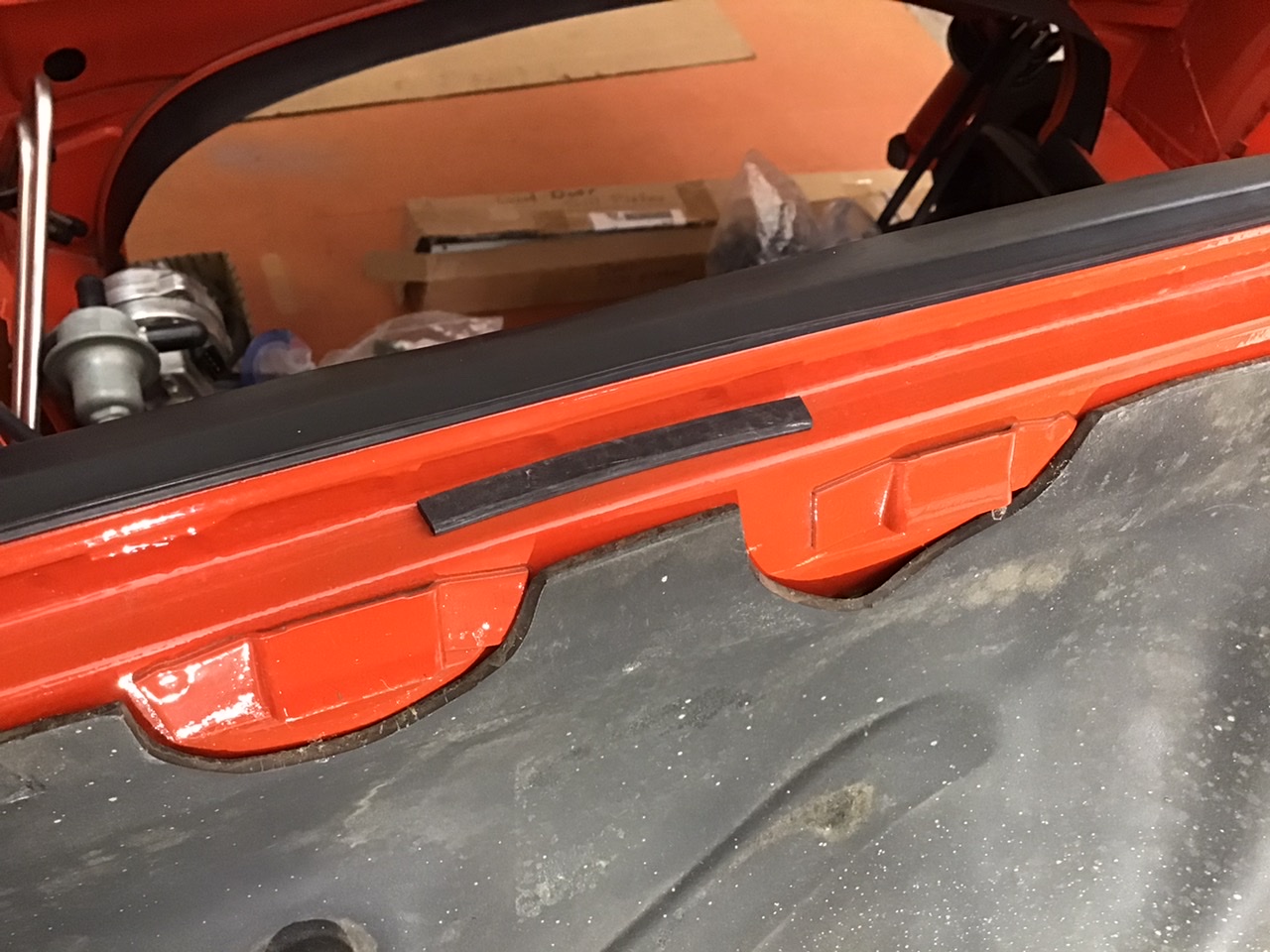

Today was rear window install day. First off I replaced the engine lid to glass seal.
Set the spacers at the bottom
Install the butyl rope
And then the glass. It went ok, but I’m not at all satisfied at this poor design of having nothing to keep the glass in place other than the butyl. I’m going to try and come up with something...
