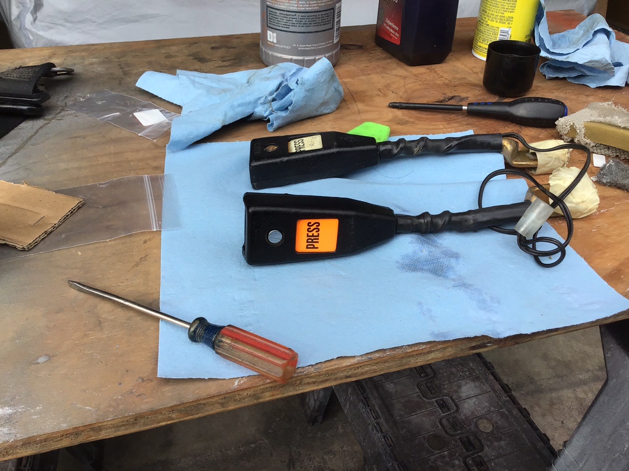

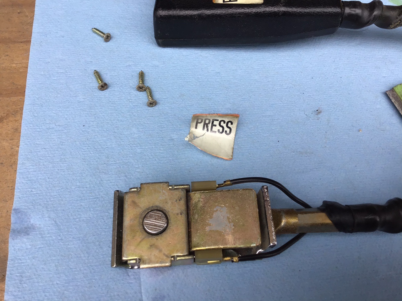

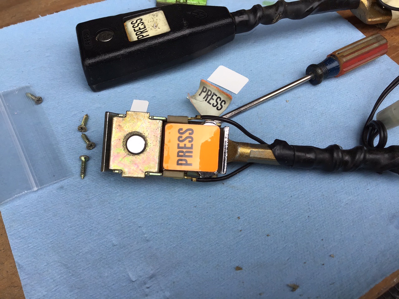

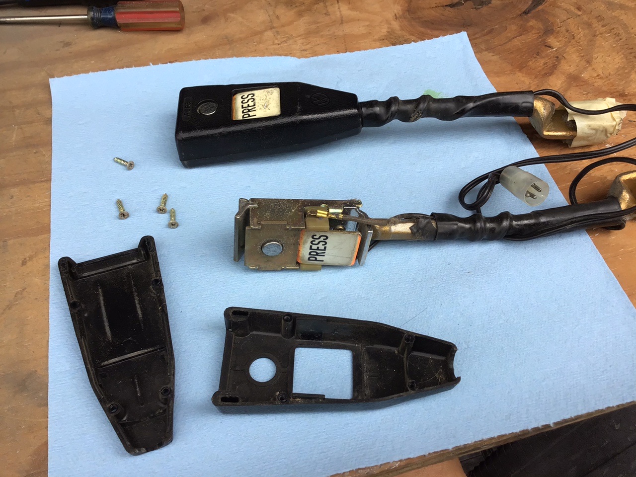

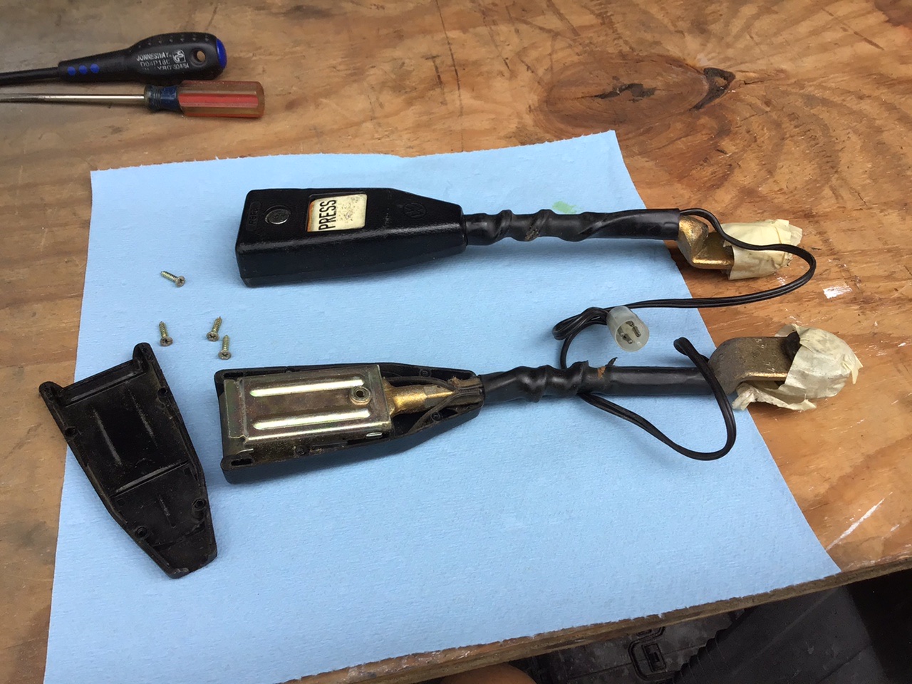

Time to clean and inspect the seat belt bits and pieces.
Off with the old PRESS sticker
And on with the new sticker

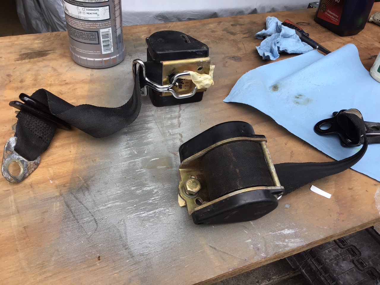

And now for the retractors

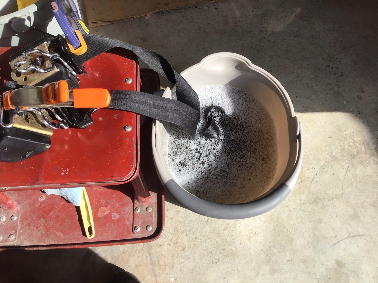

The belts seemed pretty dirty, so I decided to give them an overnight bath
After soaking and manually agitating the water was black, so I dumped it out and soaked again in water only. The water was only slightly dirty, so I called it good. After this, I hung them up over night to dry. They seem to be working much better now. (IMG:style_emoticons/default/aktion035.gif)

Nice touch with the new stickers. Where did you get them? And I assume you have to take them apart to remove/replace them?
