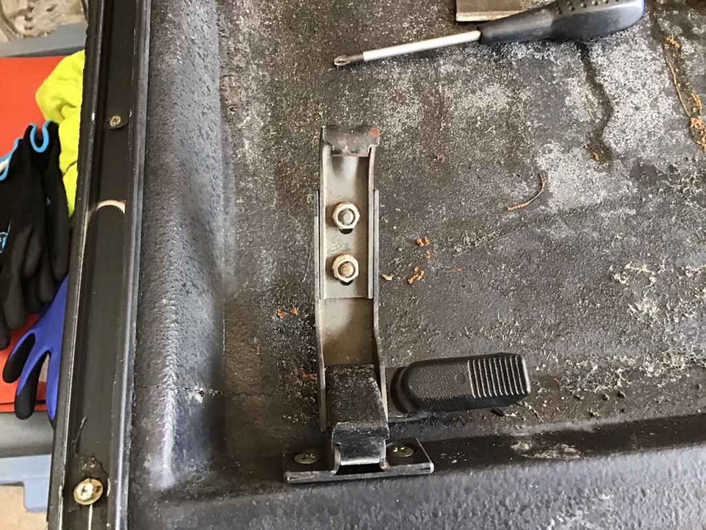

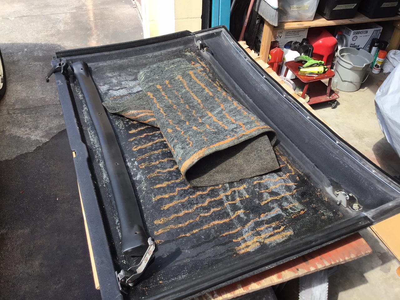

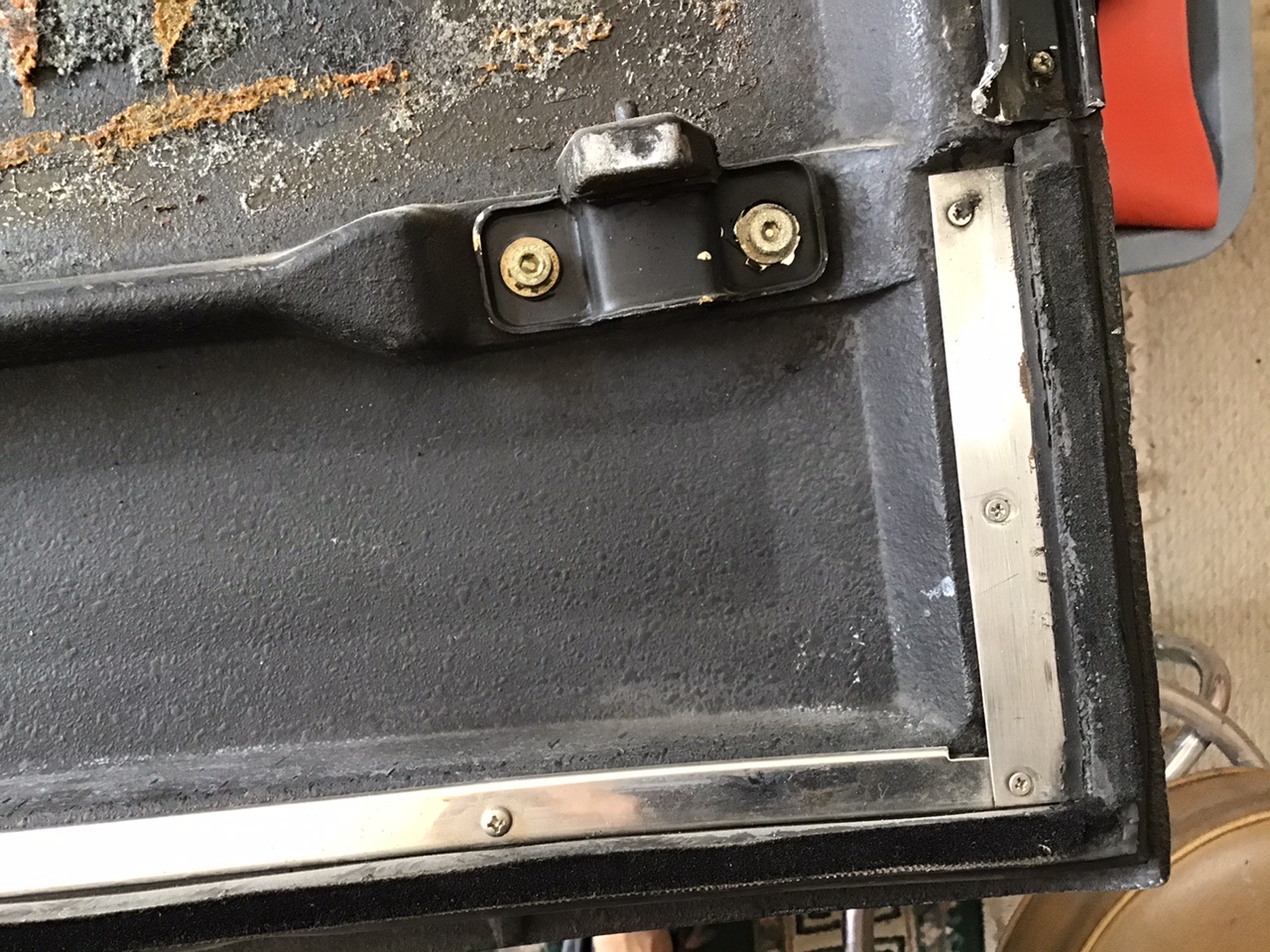

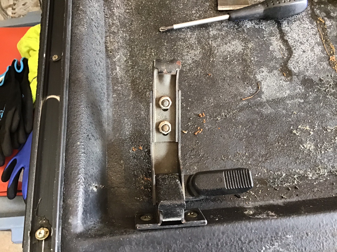

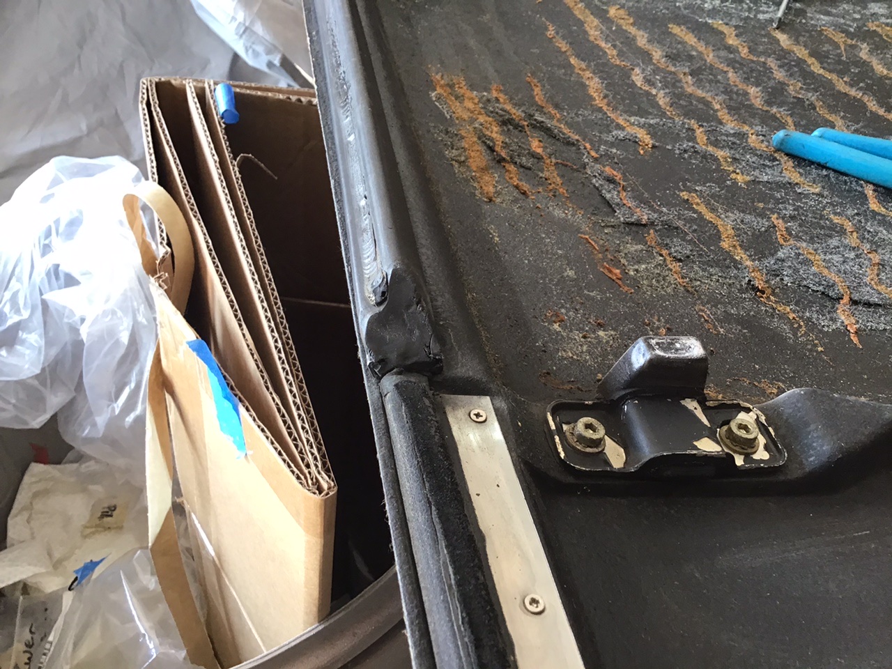

I pulled the targa top out to check the condition. It will need a complete restore. Off with all the old bits and pieces.

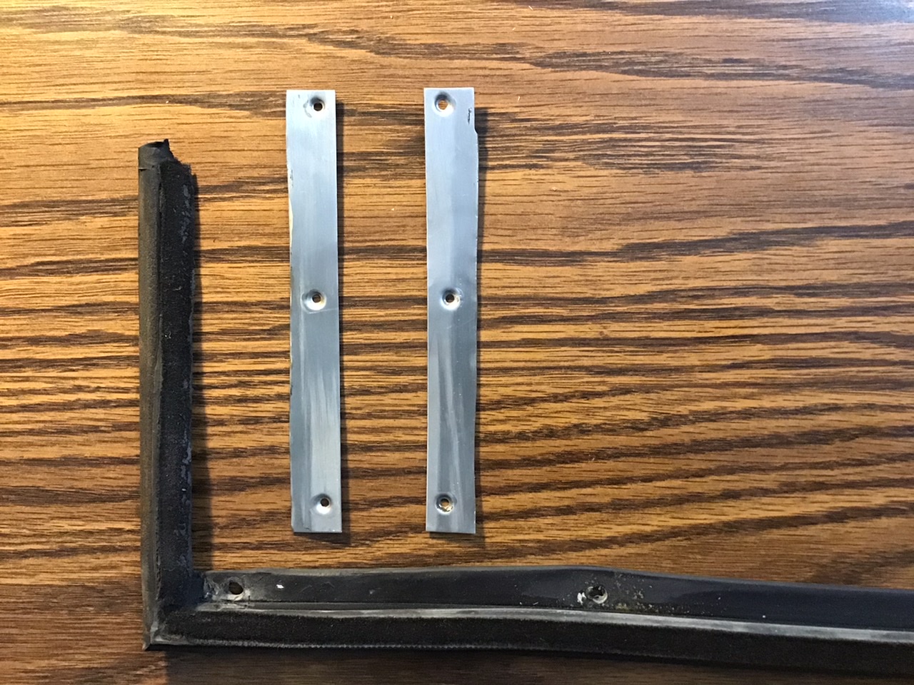

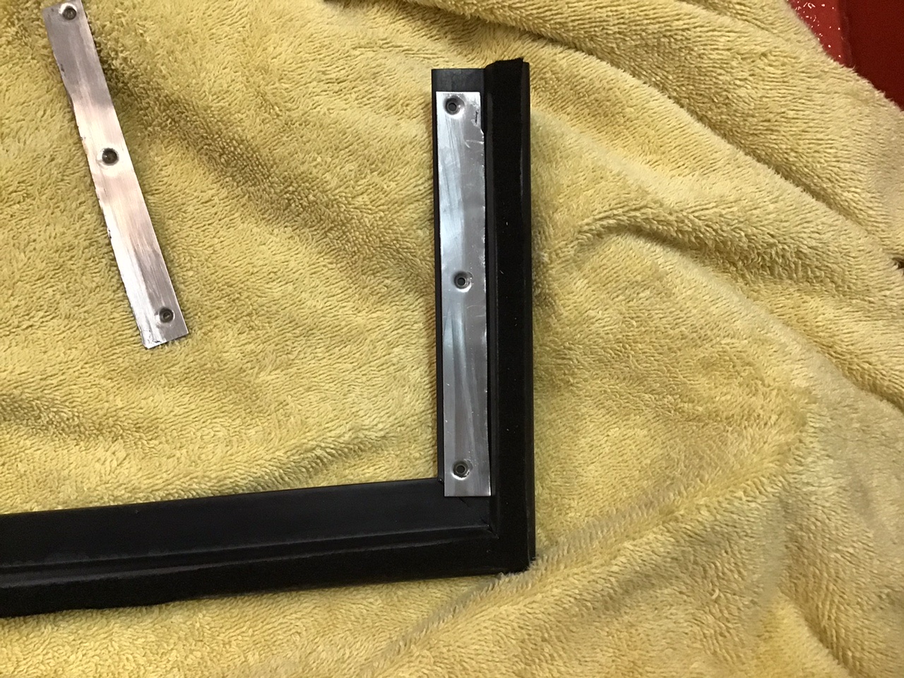

The short side metal pieces are not included in the new 914 Rubber seal with the fuzzy trim, so I had to dissect them off the original seal. This is not an easy task, but it was better than finding a piece of steel and and cutting, etc.
These are the harvested pieces, not great but they will do.
This will be its new home.
