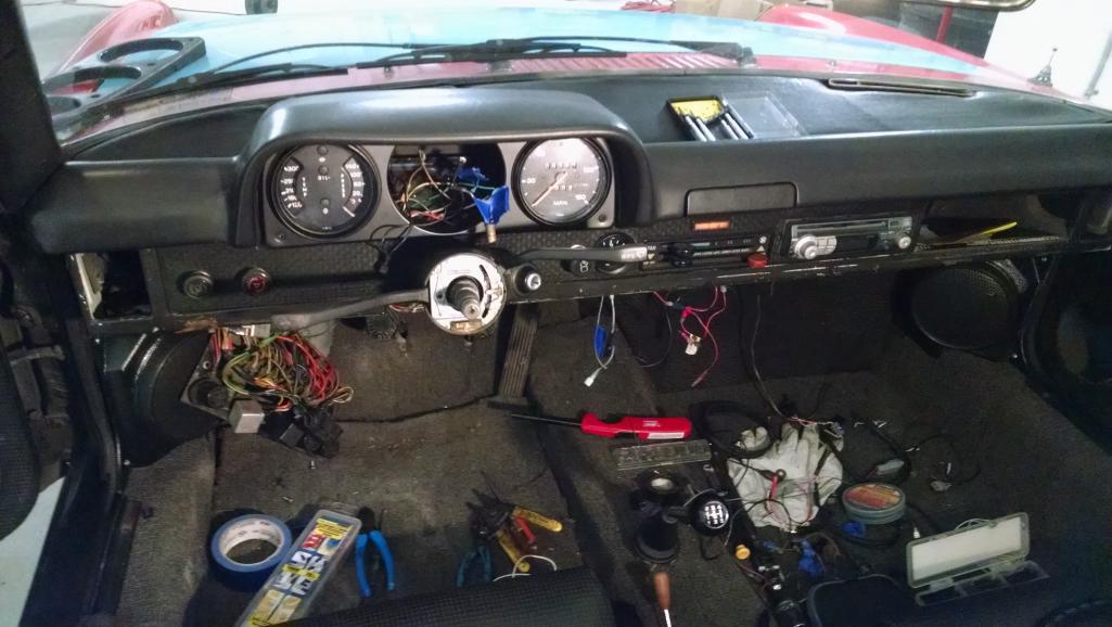

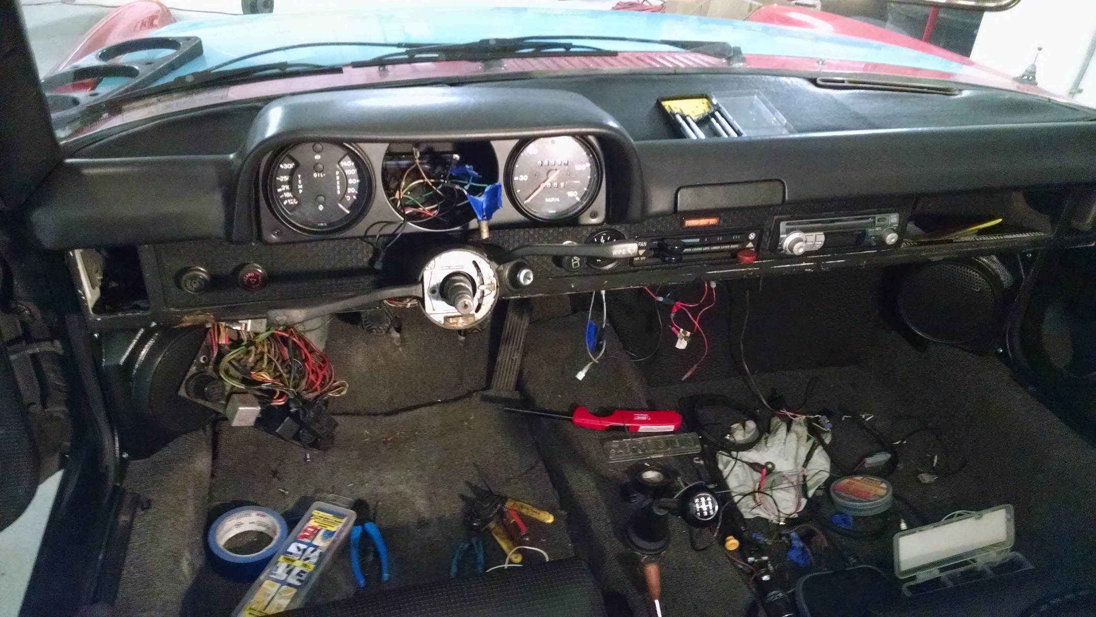

After almost exactly one year after driving the 980 miles close to home, the 914 is home.
I now have more time to actually work on it.
Today was about fixing wiring.
Installed a 911 Combo gauge, fuel gauge you can see by the cig lighter. This allowed me to remove the 4 gauges hanging below the dash.
Wiring is a little hacked up here and there. I'm making it better, but not show quality. Just ensuring everything is grounded, wire colors are mostly correct etc.
One of the more impressive things he did was install an MK1 column. Electric washers and wiper delay are part of the conversion. No complaints there!
For the moment, what a mess:
