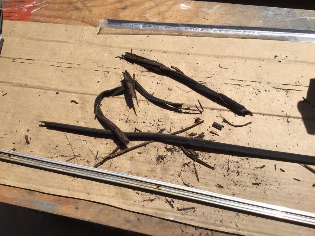

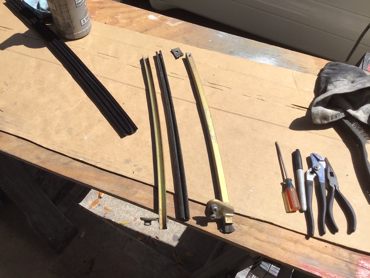

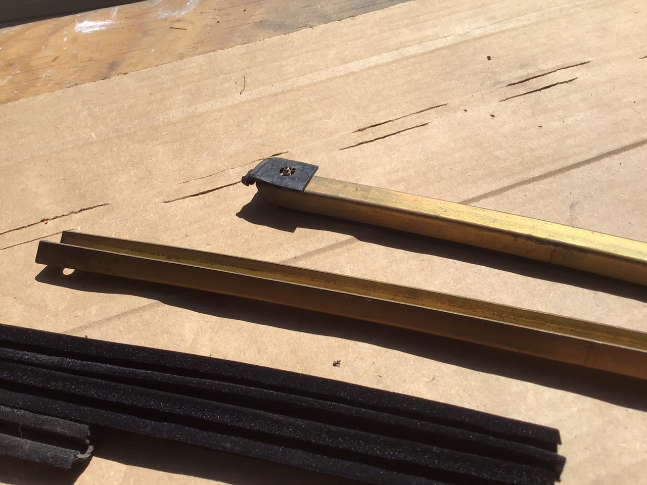

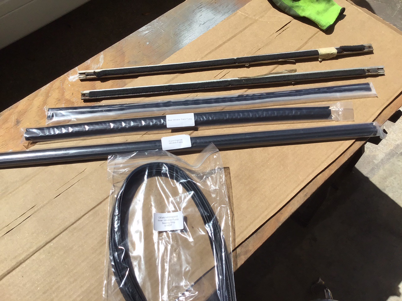

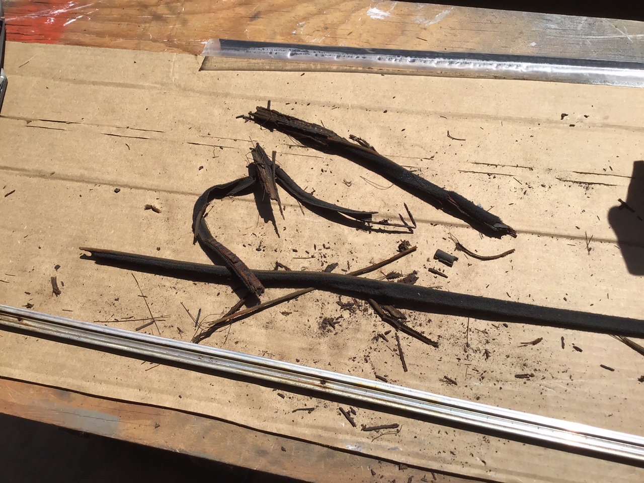

Time for some window seal replacements. The new seals are from 914 Rubber.

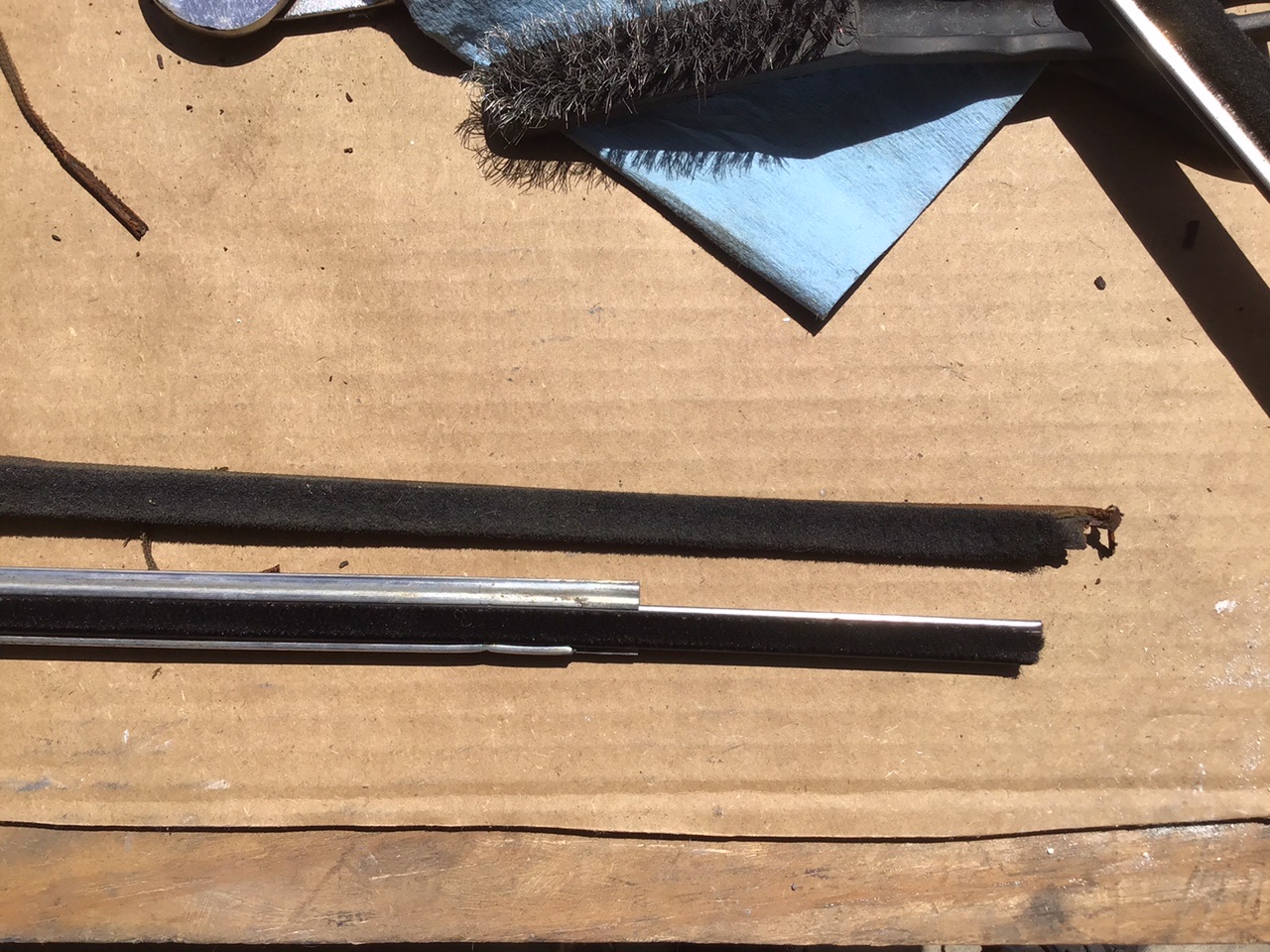

First off was replacing the top fuzzy seal
The first thing I notice is that the original seal or fuzzy strip is much more substantial than the new one. So much so that it won’t even stay in the track, perhaps I got the wrong seals? If not I will have to use some adhesive to keep these in place.
Next were the vertical seals
These seals fit nicely and are plenty long so I will trim later when I install them.
