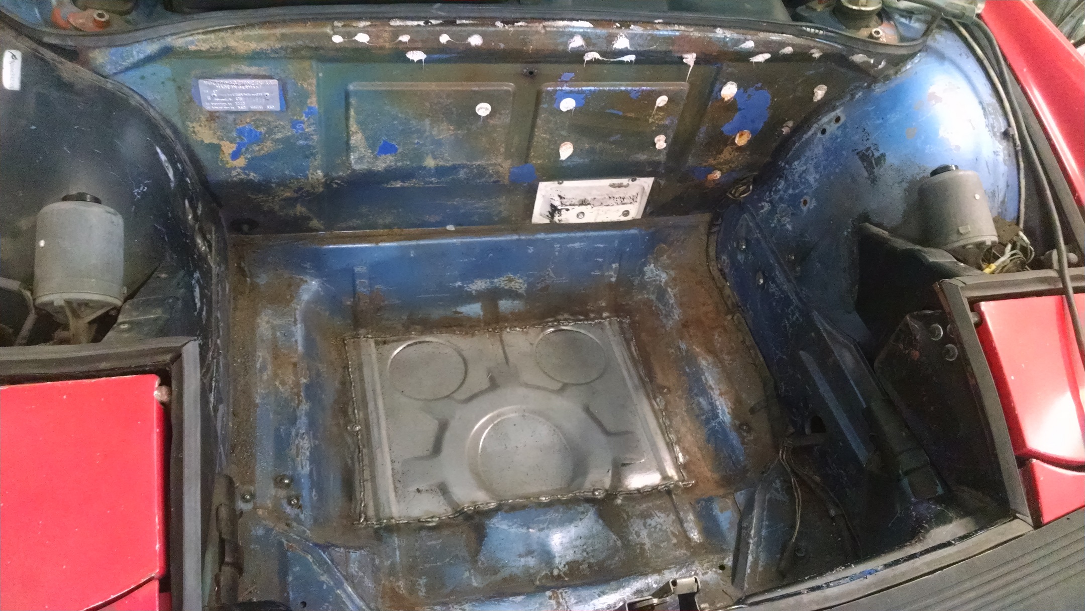

Got around to welding in the trunk floor to patch up the old dealer installed AC system.
Not my cleanest welding, but doesn't need to be. Must have welded up a dozen little holes from screws used to hold in hoses and other AC related parts. Still have a few holes to plug:
