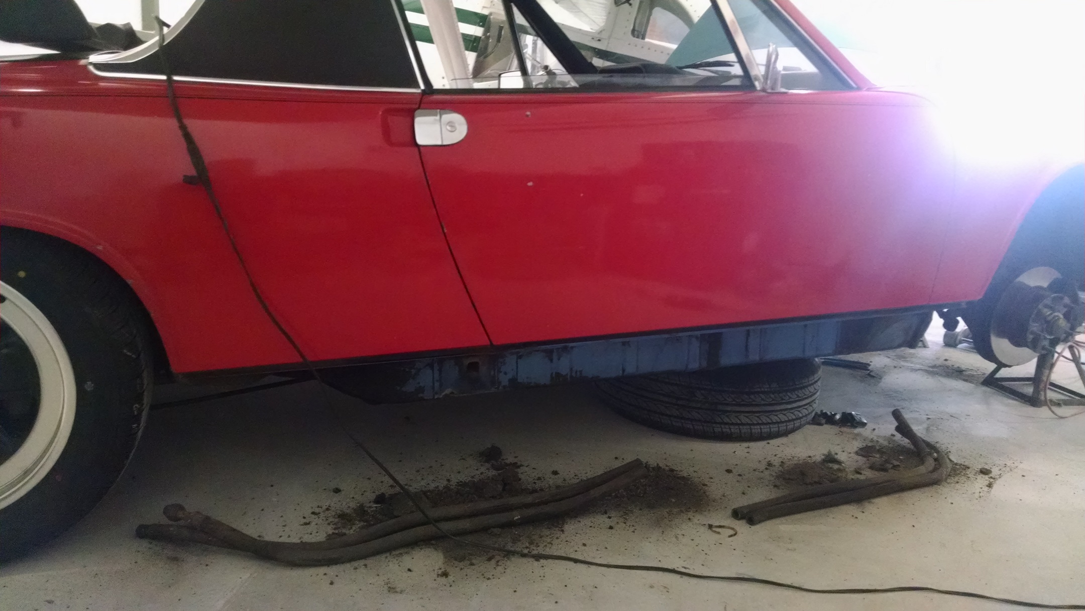

Little nervous about pulling off the passenger side cover. Gotta keep removing AC stuff and check for rust. Was very surprised to see nice clean paint! Everything is really solid. Worst rust is only a bit of surface where the AC lines pass into the front wheel well.
Gotta love a life long CA 914.
Check out how much dirt still came out.
