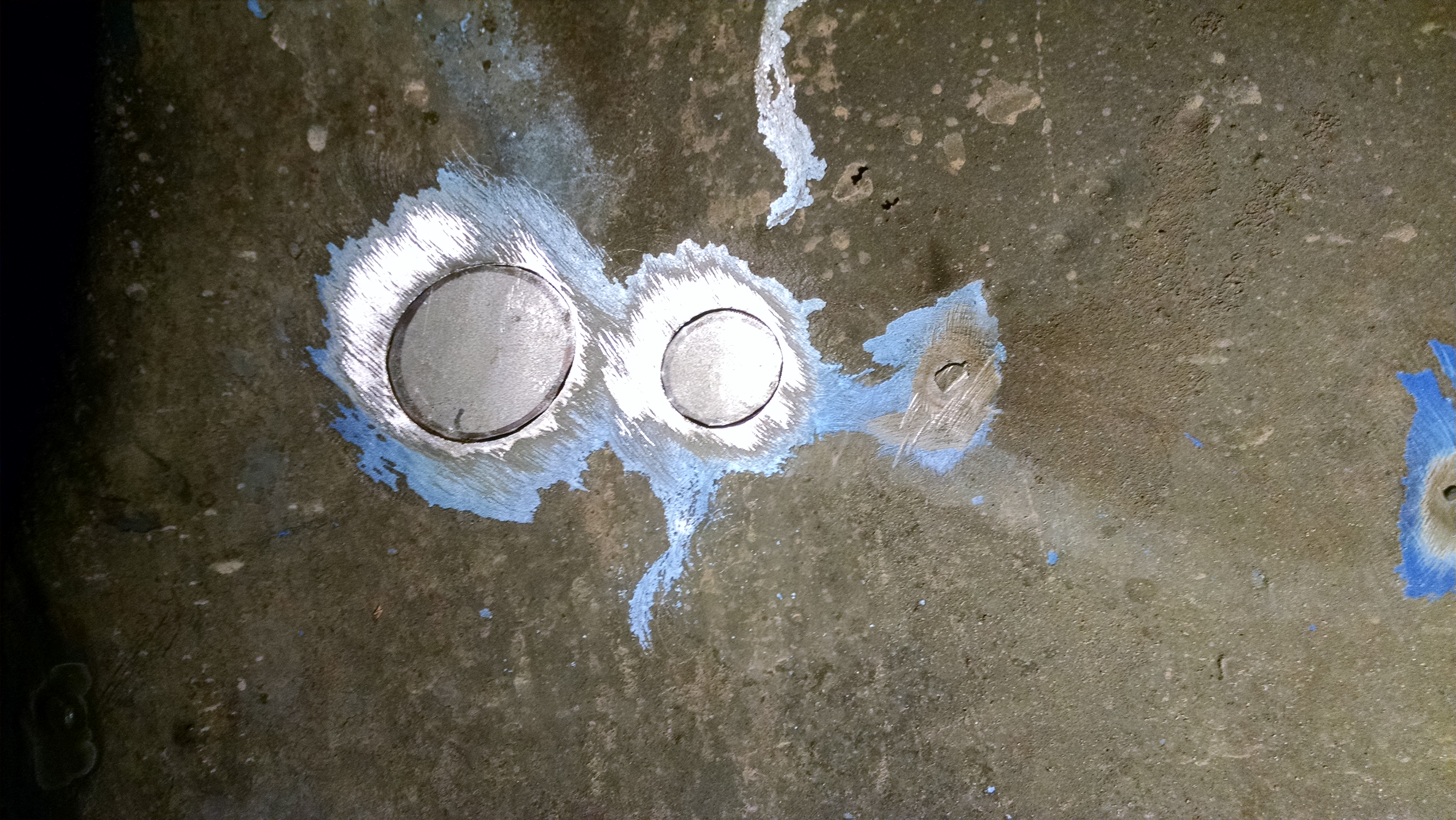

Hard to explain what it takes to undo an AC install. Example is making plugs to weld into AC line holes. So many holes to weld. Got done today which was nice.
