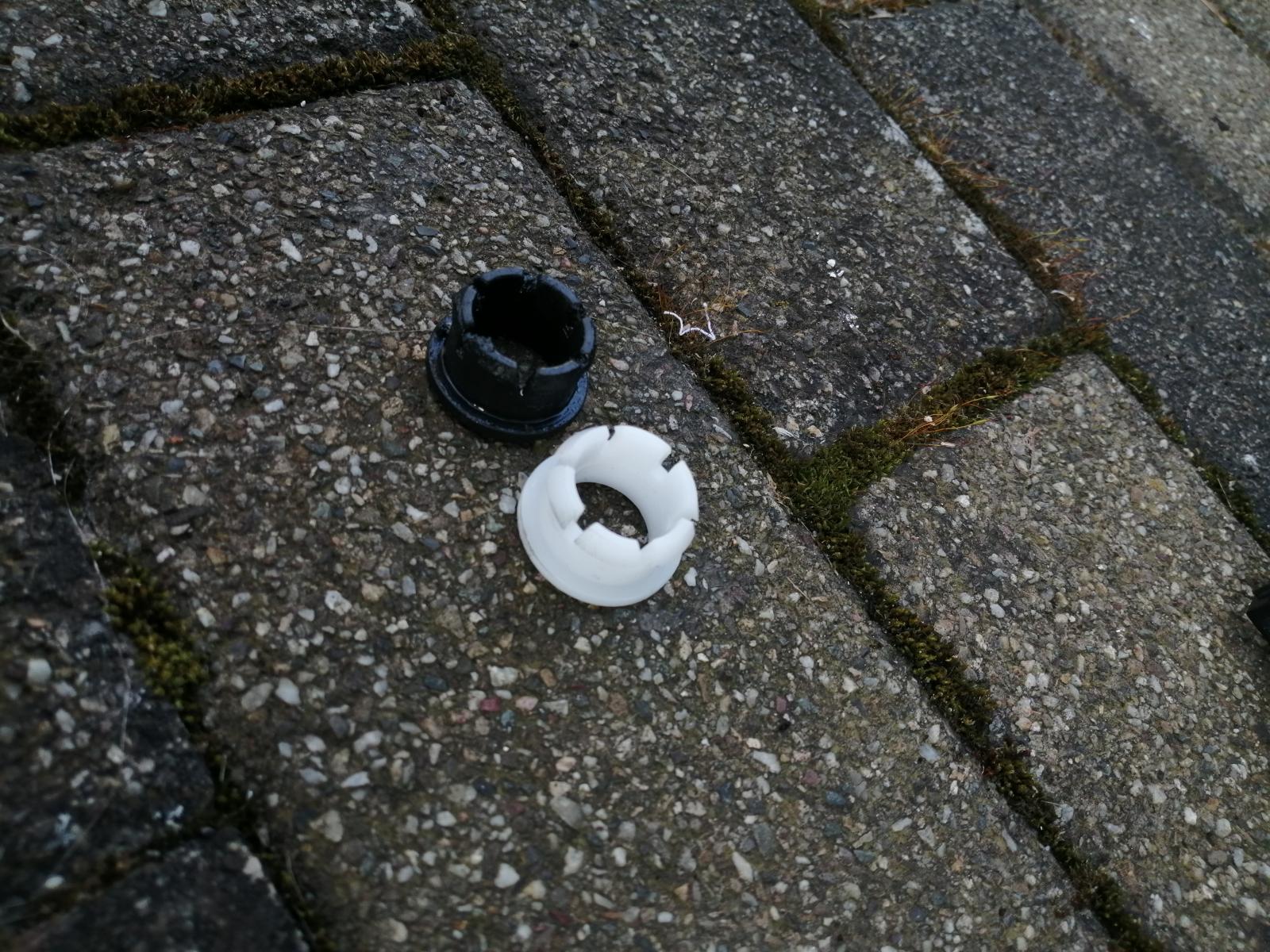

So, I did work more on the car (IMG:style_emoticons/default/sunglasses.gif)

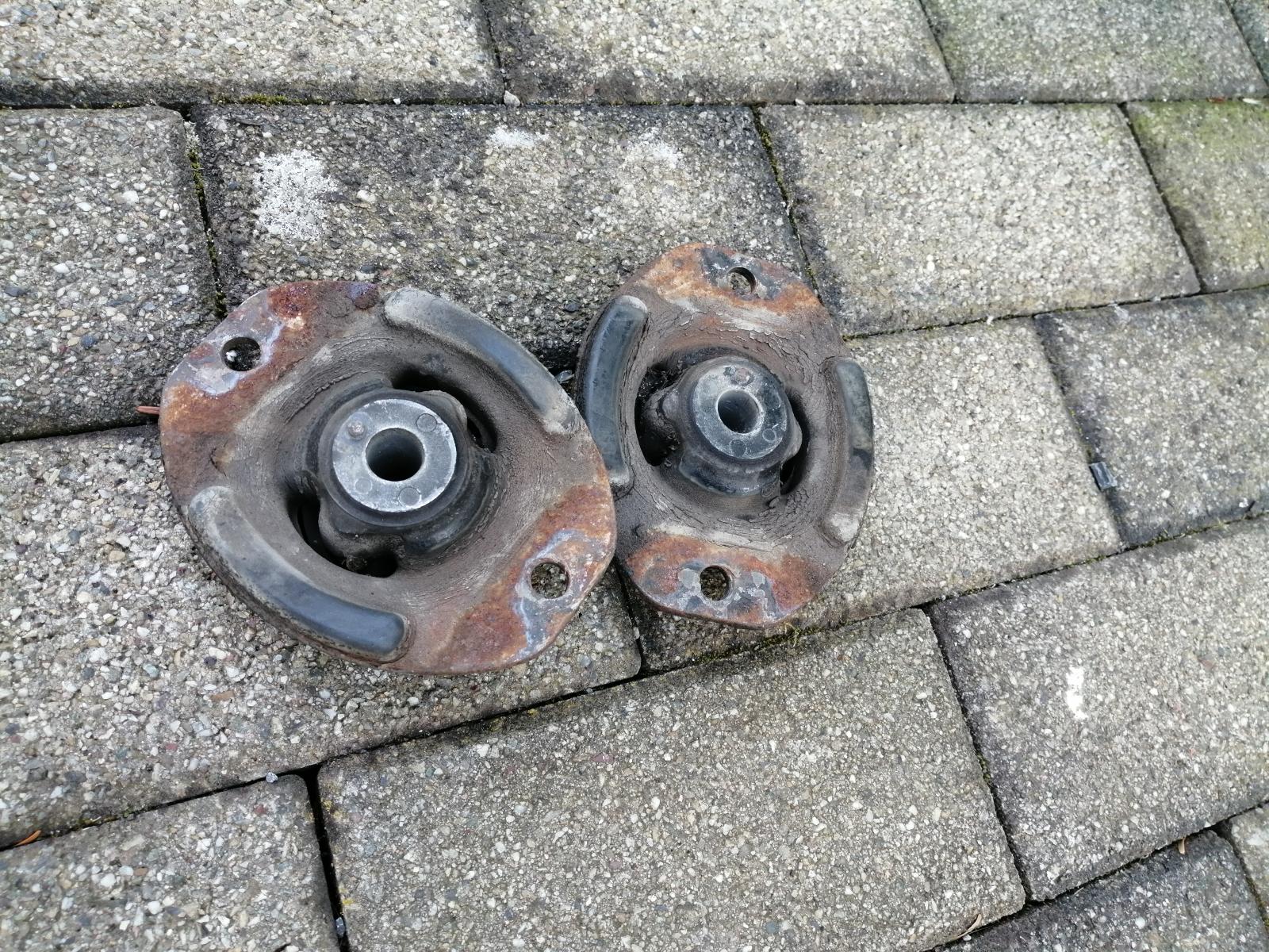

Both (old, porous) gearbox mounts are changed:
(IMG:http://www.914world.com/bbs2/uploads_offsite/www.thesamba.com-24690-1617006111.1.jpg)

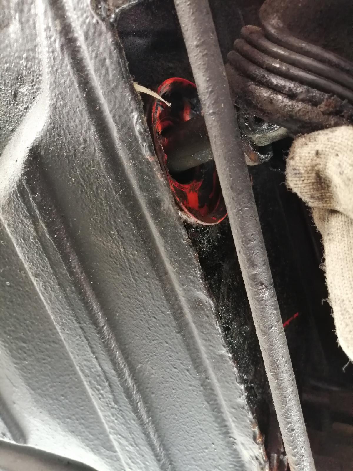

Then I starte with the bushings. First the firewall one.. Or what was left of it (IMG:style_emoticons/default/huh.gif) (IMG:style_emoticons/default/rolleyes.gif) yes, it wasn't in the firewall anymore, but hanging on the rod: (IMG:style_emoticons/default/laugh.gif)
(IMG:http://www.914world.com/bbs2/uploads_offsite/www.thesamba.com-24690-1617006112.2.jpg)

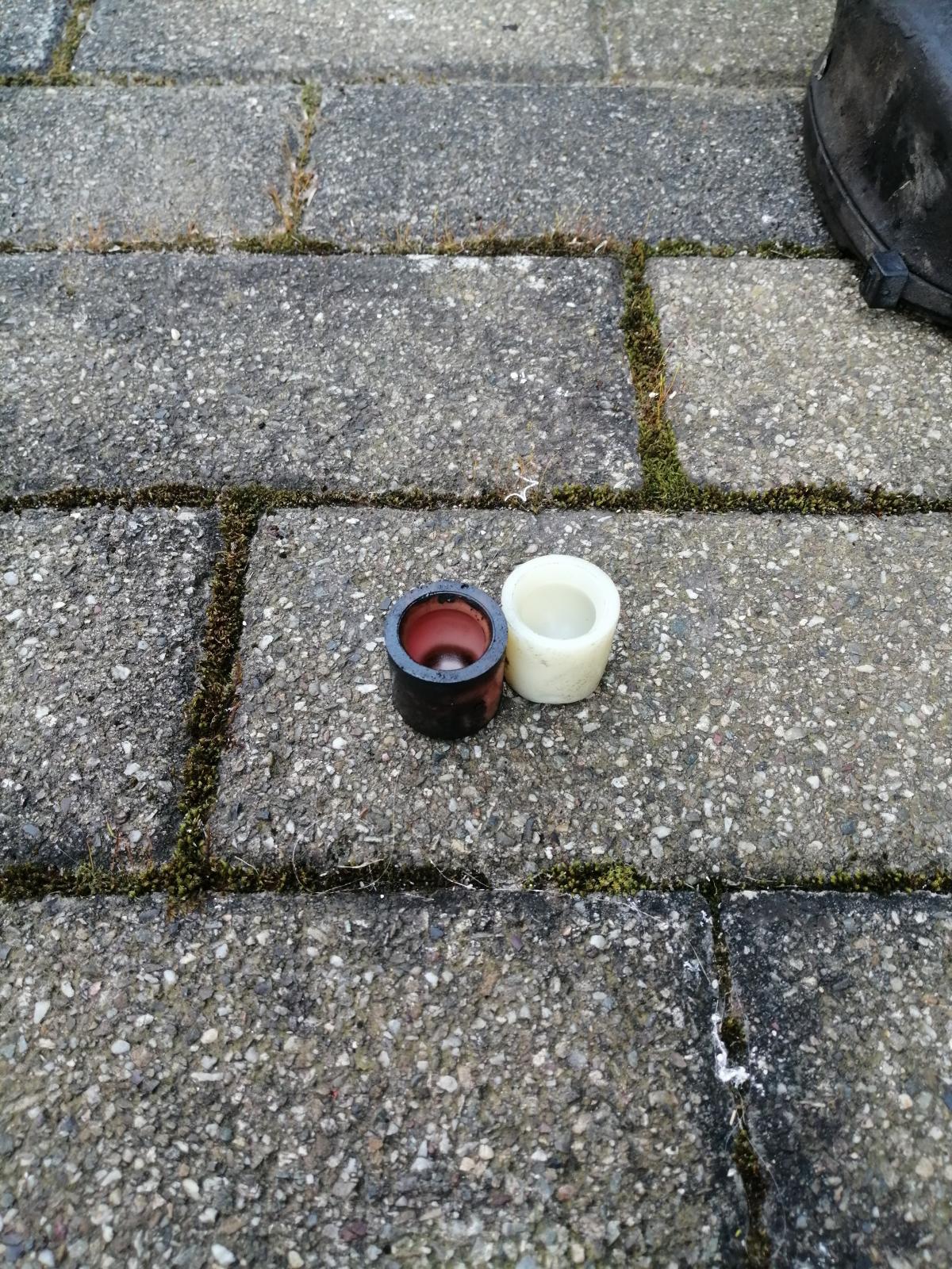

It was quite worn (IMG:style_emoticons/default/laugh.gif) :
(IMG:http://www.914world.com/bbs2/uploads_offsite/www.thesamba.com-24690-1617006112.3.jpg)

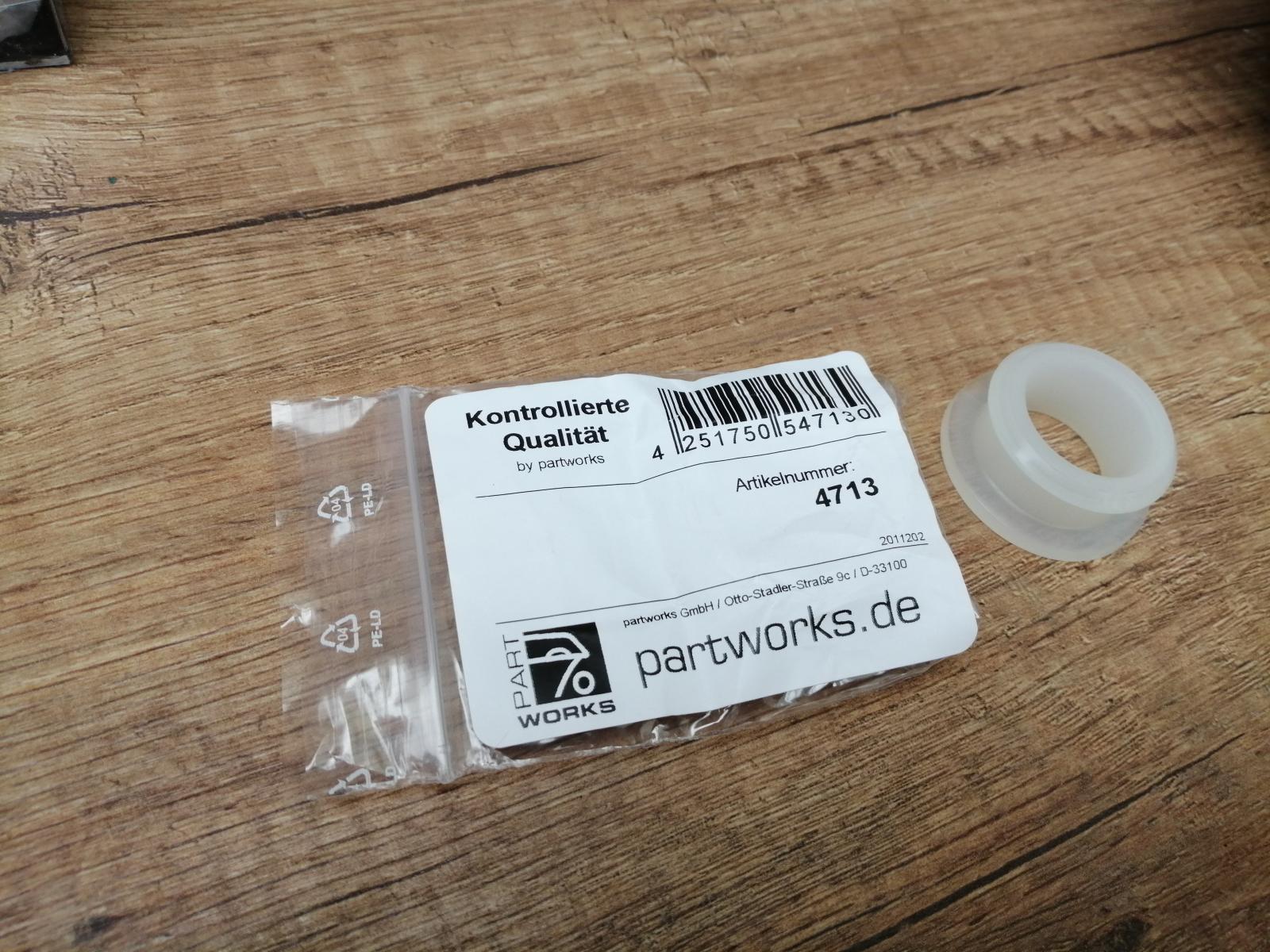

So I tried to replace it with the one from the set I bought:
(IMG:http://www.914world.com/bbs2/uploads_offsite/www.thesamba.com-24690-1617006112.4.jpg)
But no chance. Boiling, grease, oil, violence,.. Nothing worked. So of course I came back here, made a research and.. Tadaaa:
http://914world.com/bbs2/index.php?showtopic=345742

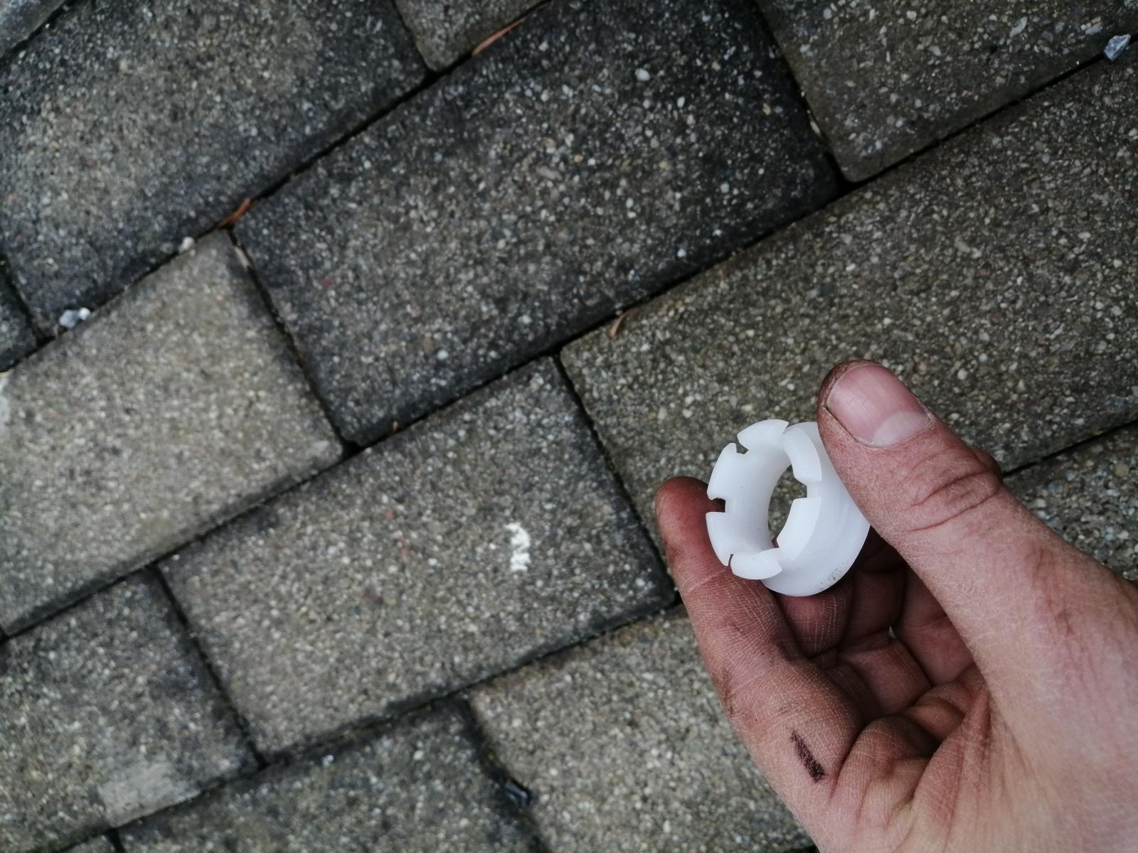

Thanks to @Frankvw I had my answer (IMG:style_emoticons/default/first.gif) so one more order and go:
(IMG:http://www.914world.com/bbs2/uploads_offsite/www.thesamba.com-24690-1617006113.5.jpg)
Boiling, 15sec later it was in (IMG:style_emoticons/default/aktion035.gif)

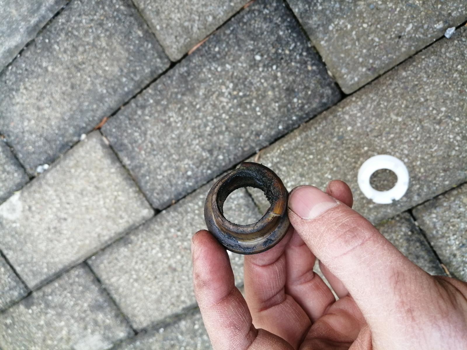

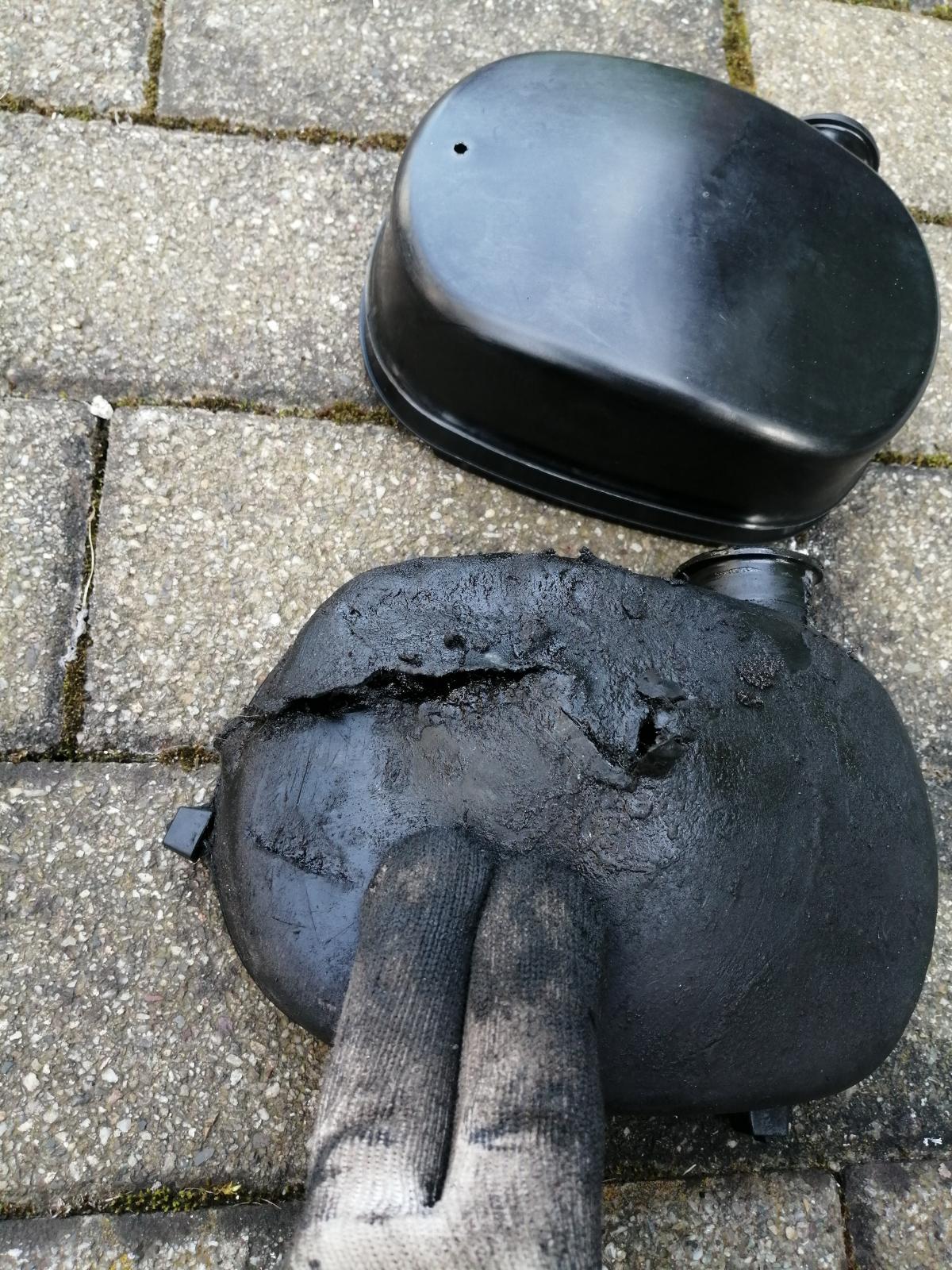

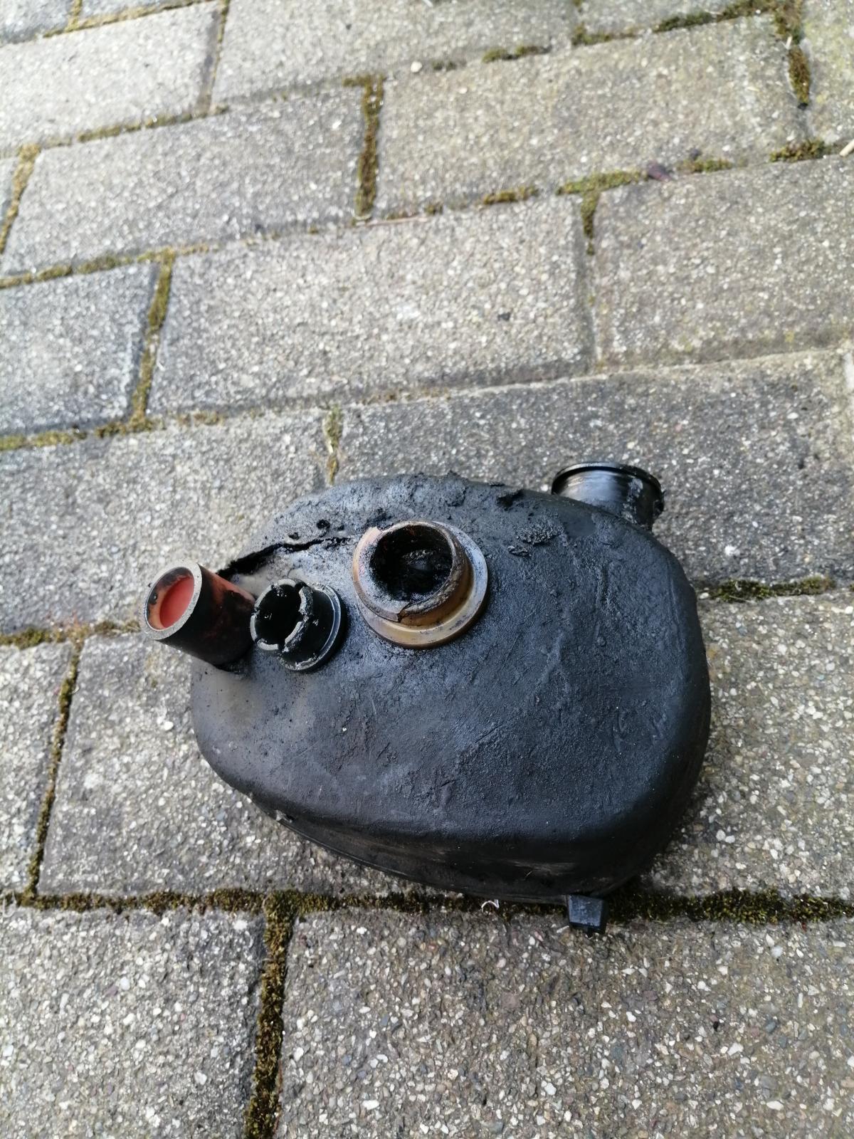

Then I continued with the next ones:
(IMG:http://www.914world.com/bbs2/uploads_offsite/www.thesamba.com-24690-1617006113.6.jpg)
(IMG:http://www.914world.com/bbs2/uploads_offsite/www.thesamba.com-24690-1617006113.7.jpg)
And the cover that needed a change (IMG:style_emoticons/default/lol-2.gif)
(IMG:http://www.914world.com/bbs2/uploads_offsite/www.thesamba.com-24690-1617006114.8.jpg)
And that was it for the worn parts :
(IMG:http://www.914world.com/bbs2/uploads_offsite/www.thesamba.com-24690-1617006114.9.jpg)

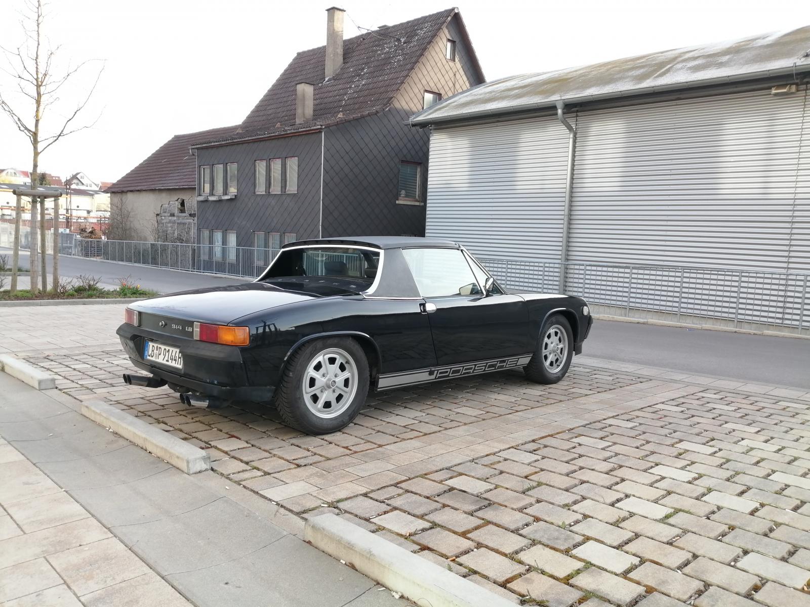

Car is back on the roads, and seems to shift better (but still room for improvements..). Let's enjoy the spring, I took it directly for a small ride with my 5 years old boy that helped for all the changes, giving me the tools or moving things when 2 hands weren't enough :
(IMG:http://www.914world.com/bbs2/uploads_offsite/www.thesamba.com-24690-1617006115.10.jpg)
Cheery
Antoine
