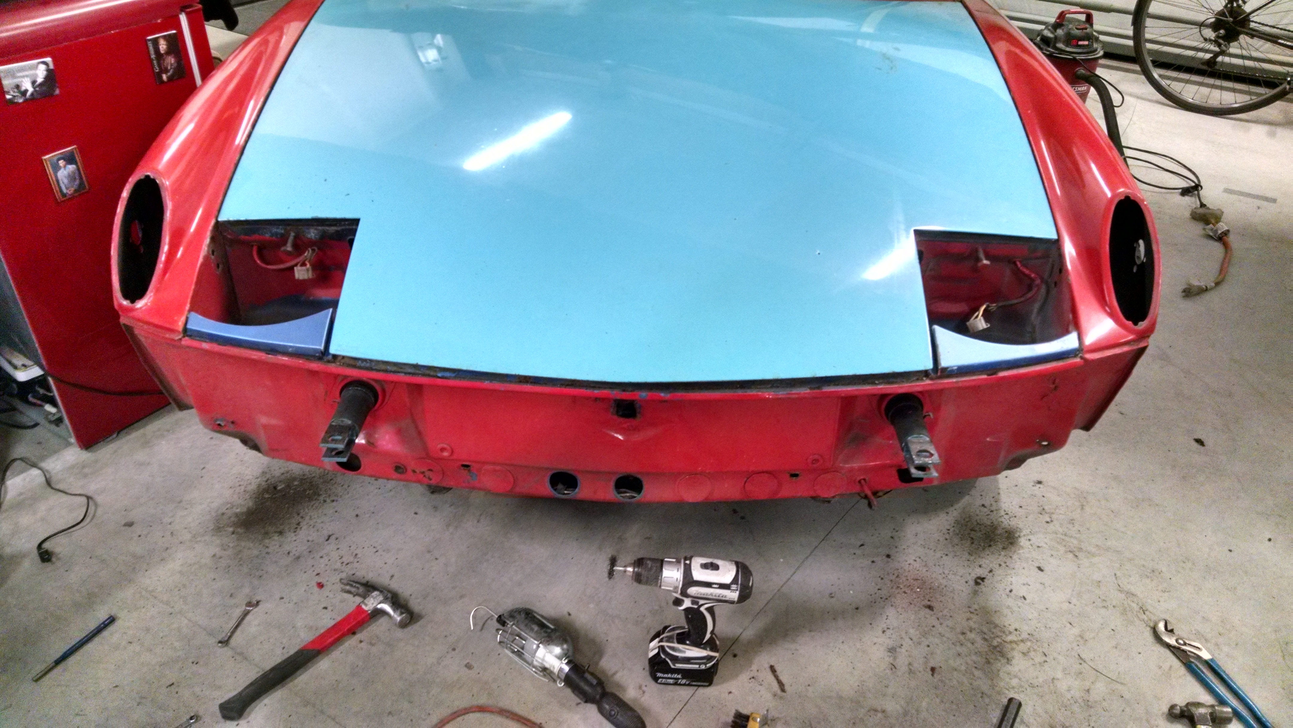

Root_Werks   Sourced a nicer hood as the original hood would ha...   Feb 1 2021, 10:43 AM
