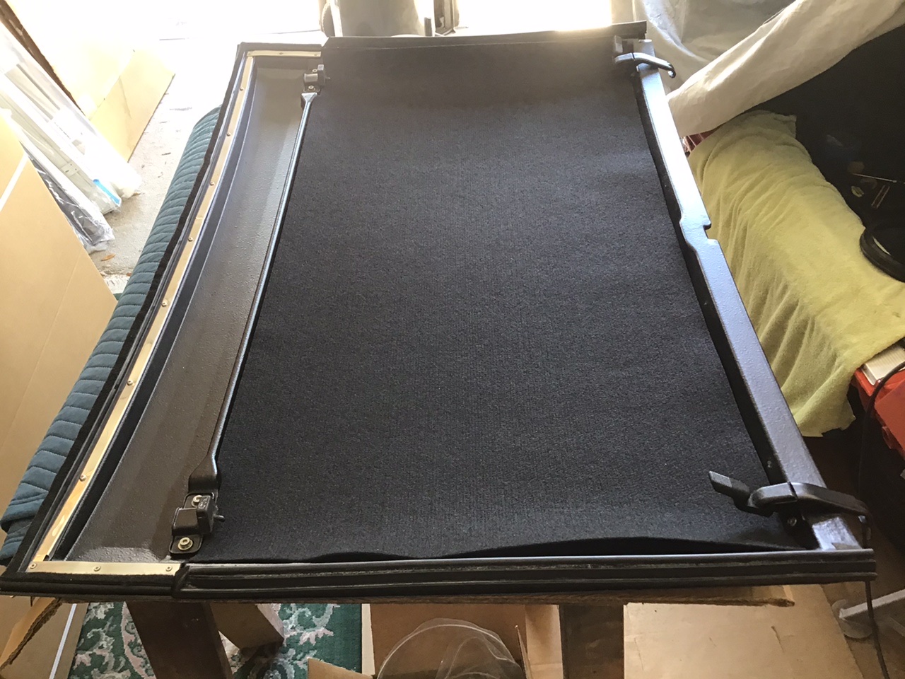

Today I’m continuing with the refresh on my targa top. I will be installing the 914 Rubber headliner. First I just laid the piece in to check the fit, it looks good but I wasn’t sure if it’s supposed to be trimmed on the sides to lay flat or not. I elected to leave it the way it came, because the chances of me getting a good clean straight cut would be slim.

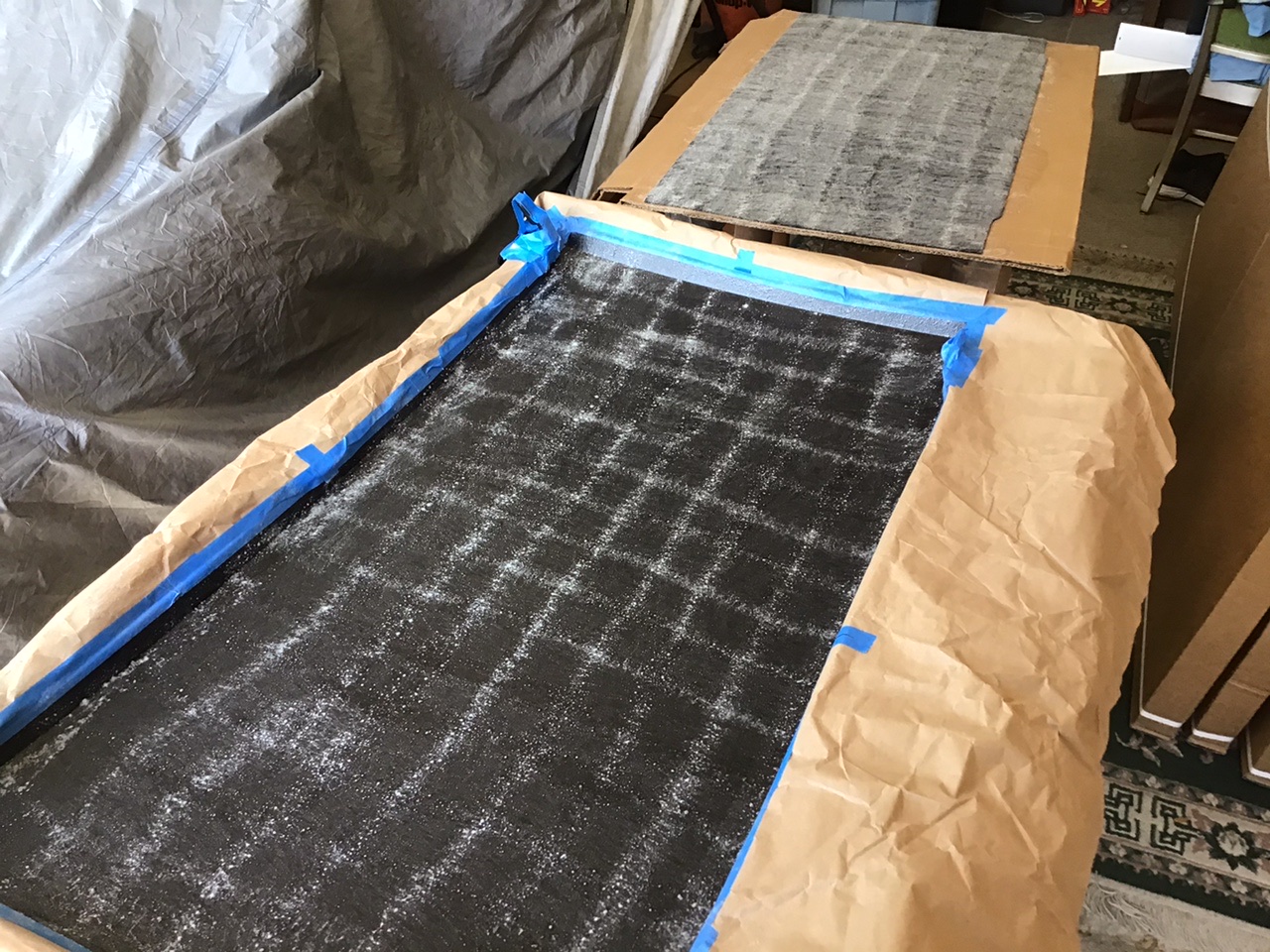

Next I masked everything off that I didn’t want adhesive on, and then applied the 3M adhesive to both surfaces in a criss cross pattern.

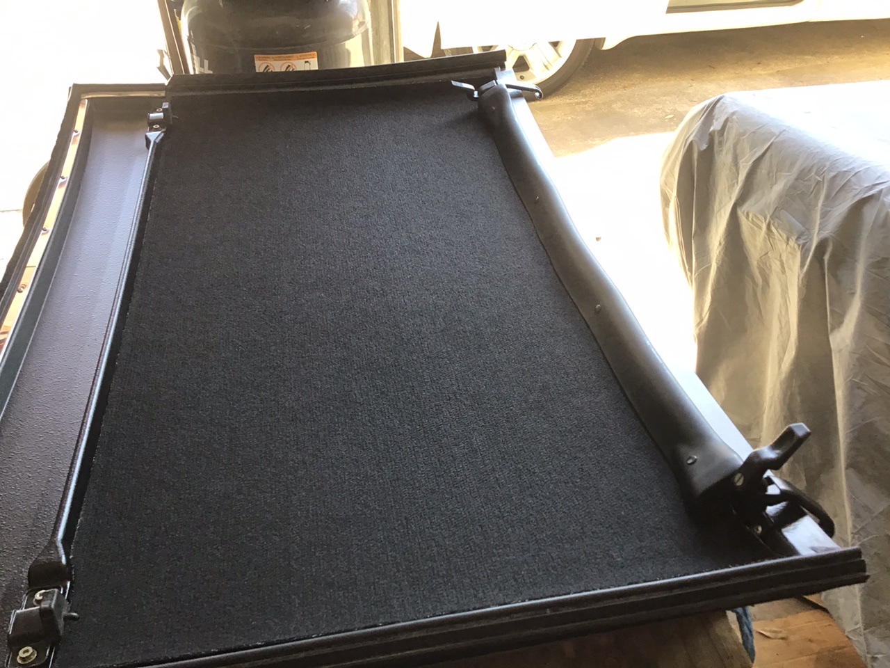

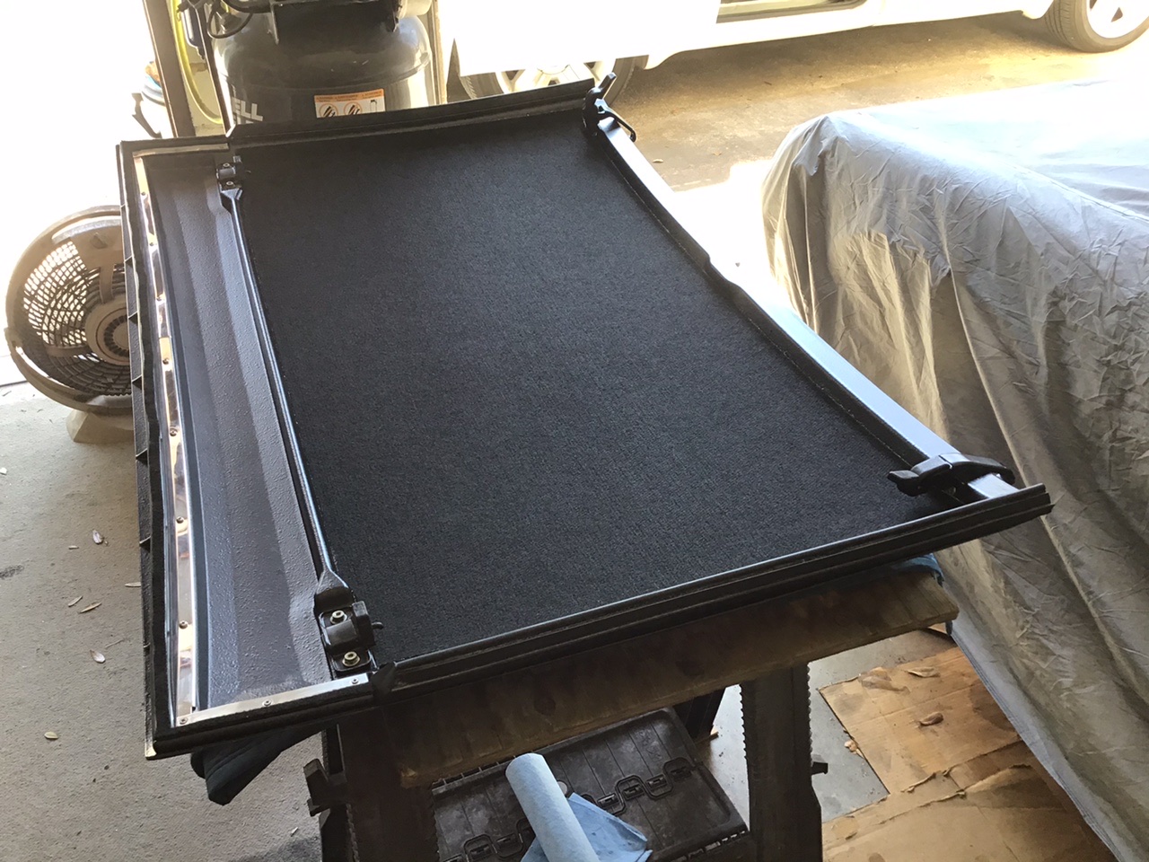

After waiting about 10 minutes, I had a buddy help me with getting it in straight, etc. Super stoked on how good this came out. It was a nice piece, and looks fantastic!

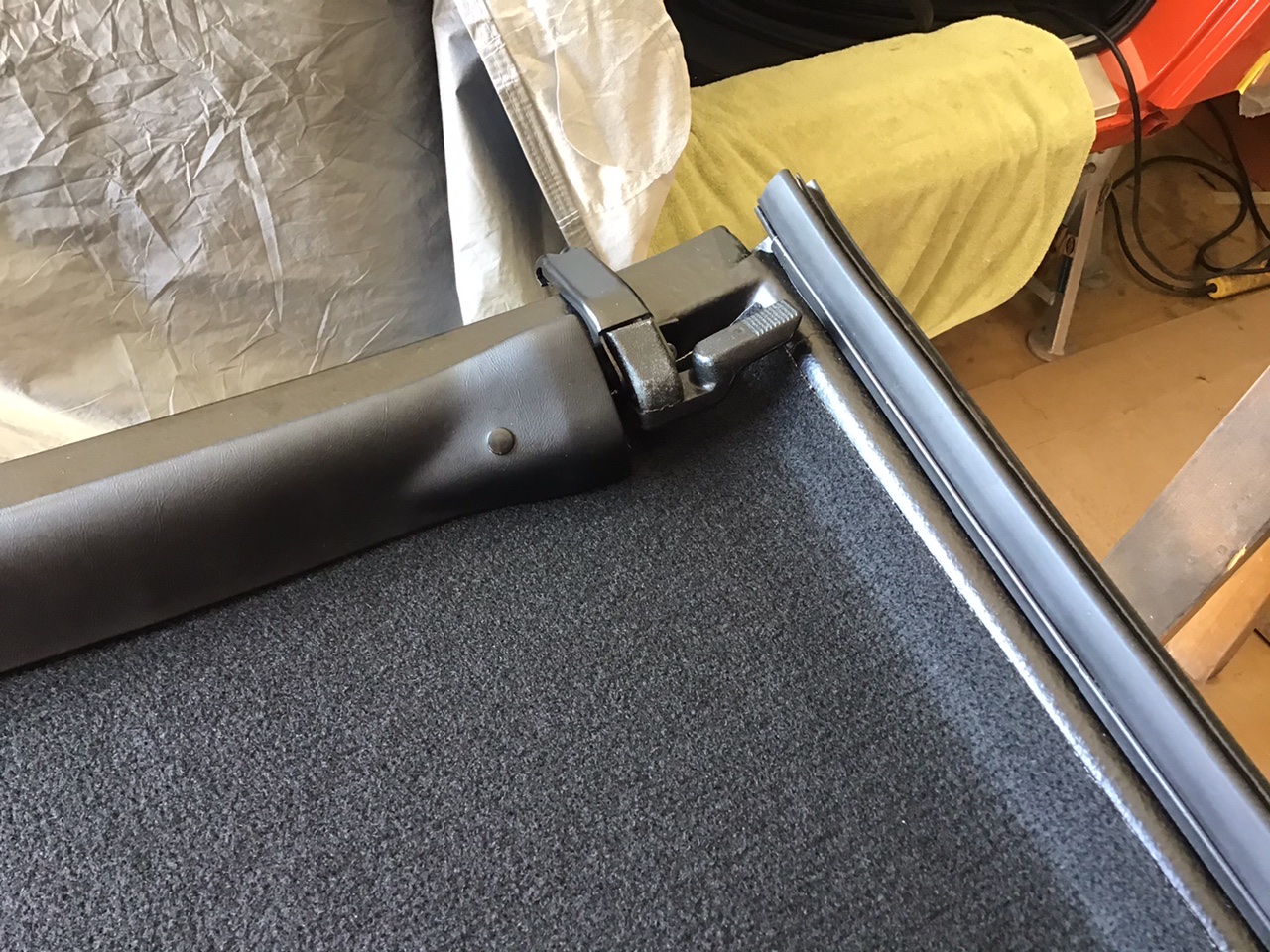

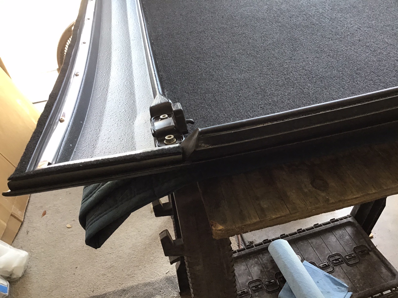

Here’s more after the front pad install.
I left the side seals a bit long and will fit the top if and when I can get my main targa seal in. Then I will trim the seals as necessary.
Happy to have this part refreshed!
