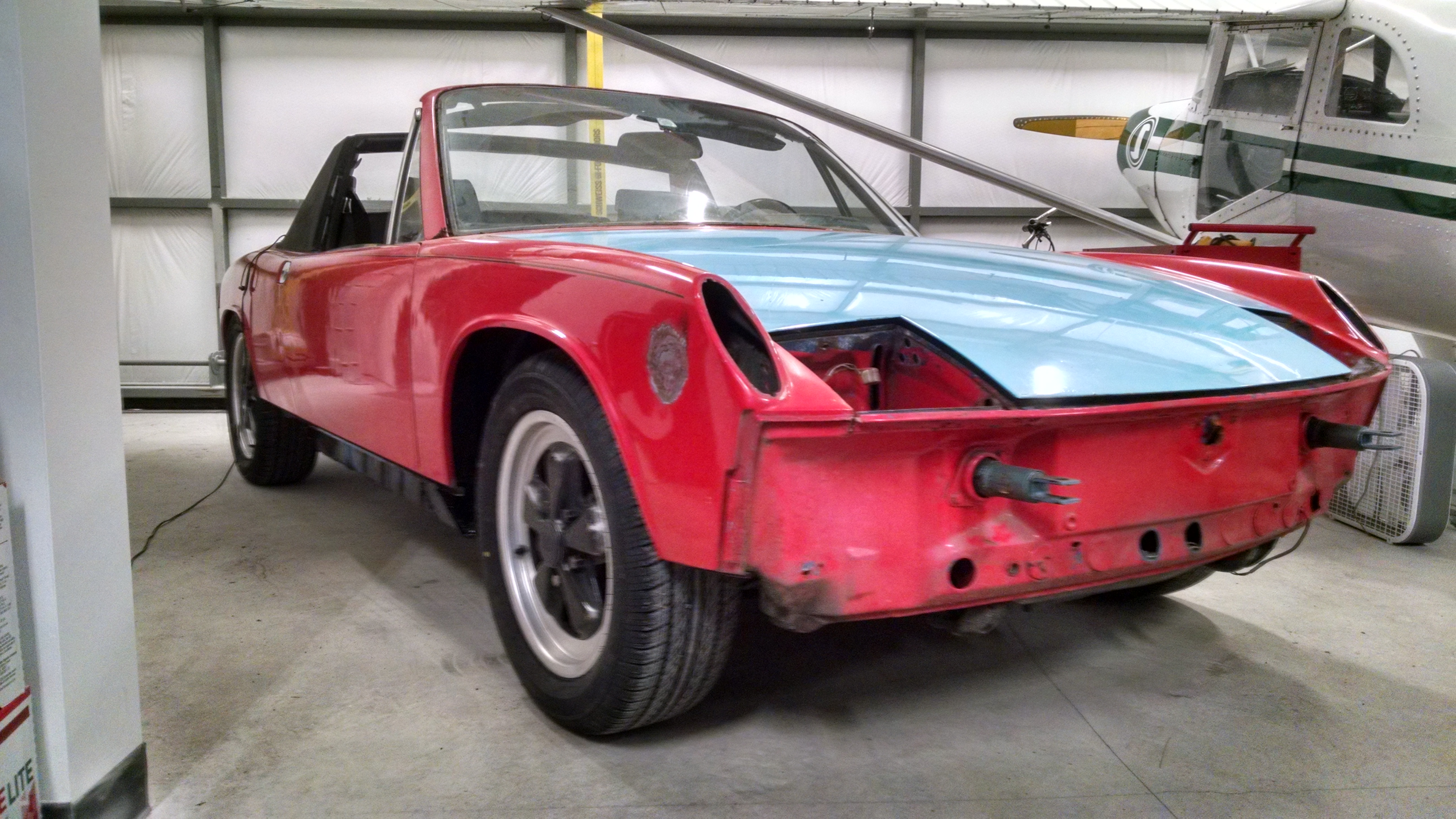

Almost ready for the body/paint shop. Side markers welded up, all holes welded up that would need to be for paint.
Going back to Anacona Blue.

Root_Werks   Almost ready for the body/paint shop. Side marker...   Apr 9 2021, 12:40 PM
