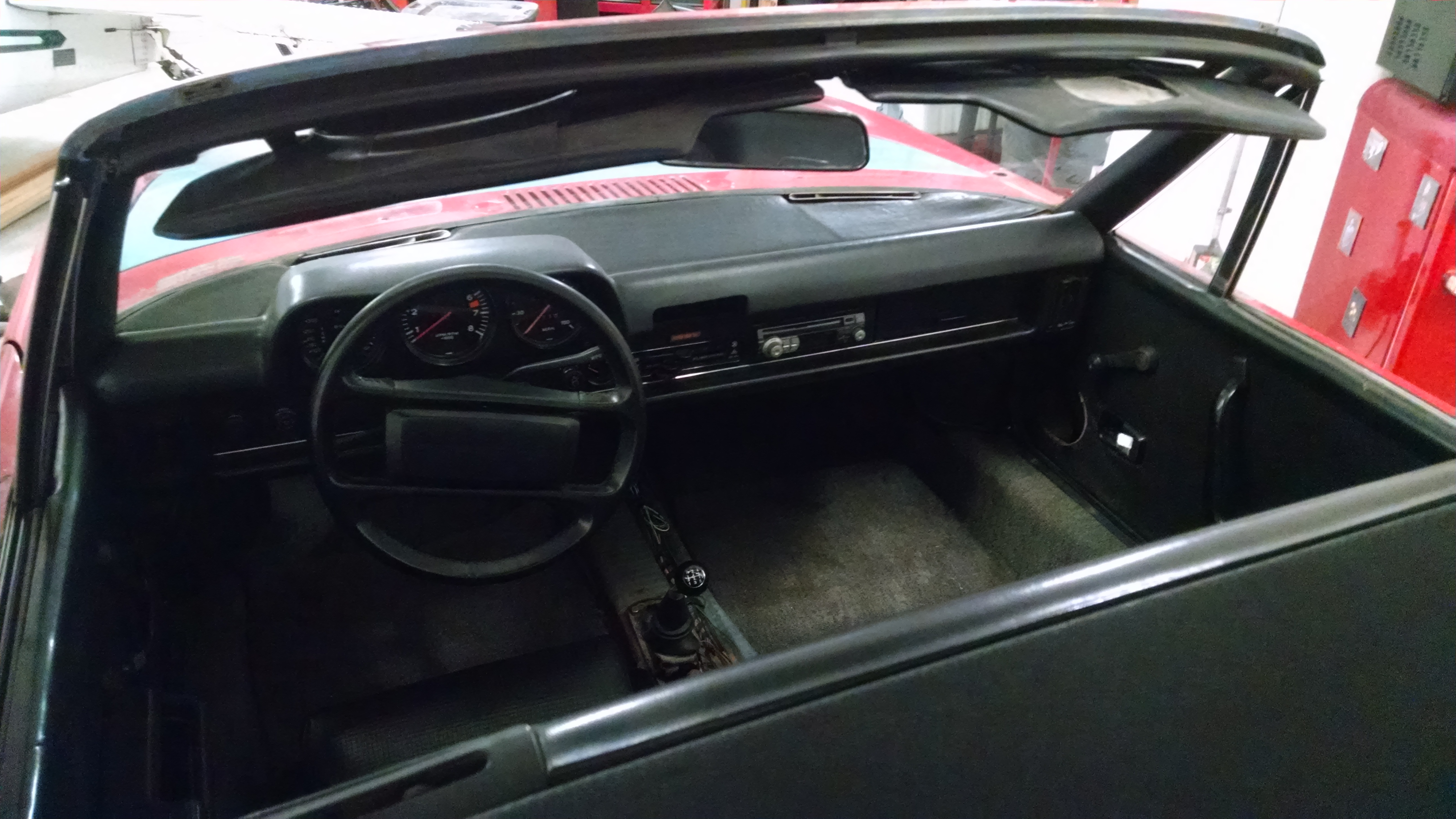

Here's another bad picture of the interior with the gauges all done, steering wheel all done and wiring finished and cleaned up. It'll get new door panels, carpet, all seals of course and probably a different or new backpad.
Was going to replace seats and dash, not now, not for a long time. They are good enough.
