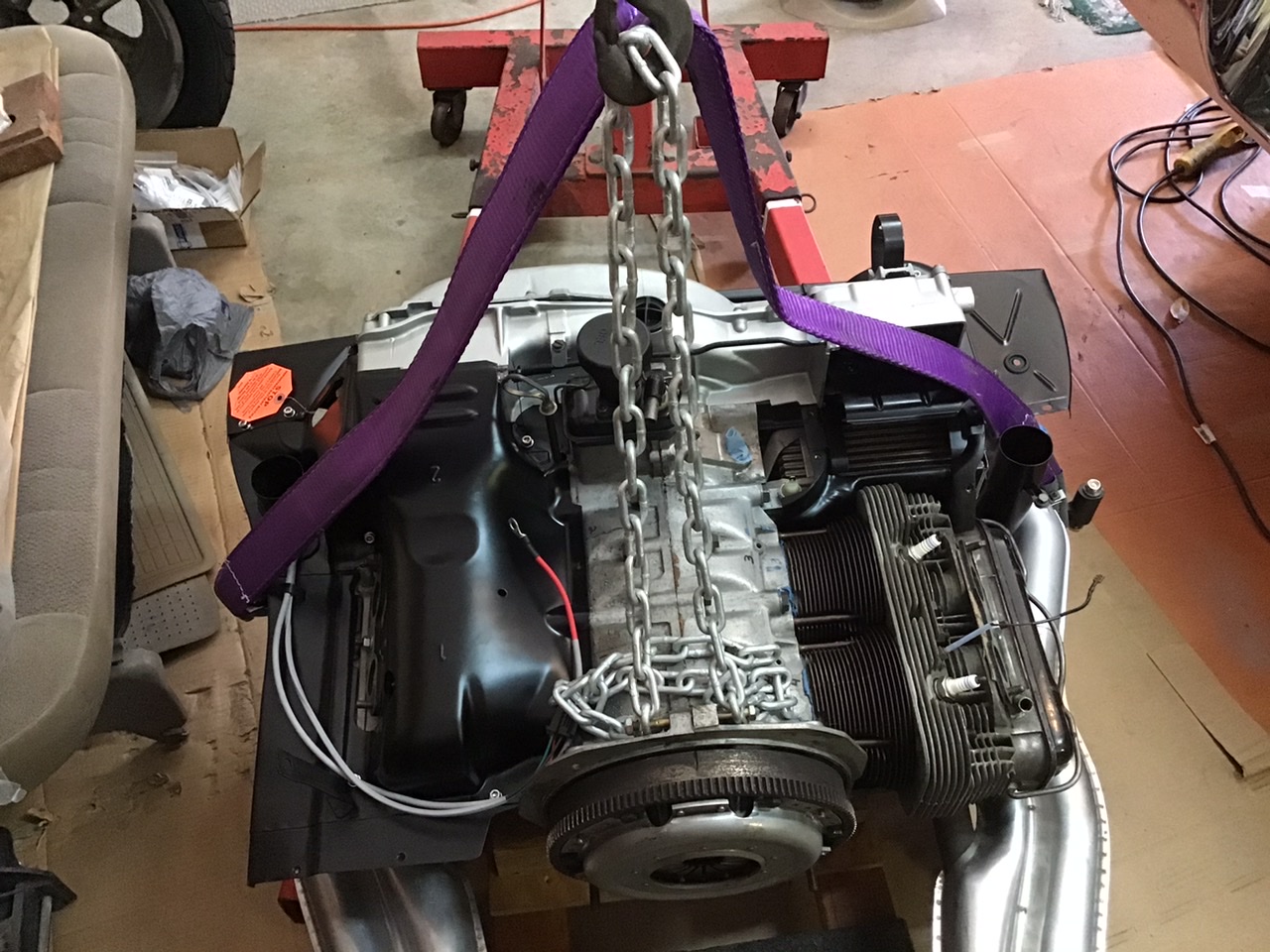

Time to get the engine off the stand so I can marry the trans to it and start putting on all the bits and pieces.
The trans meets its new mate.

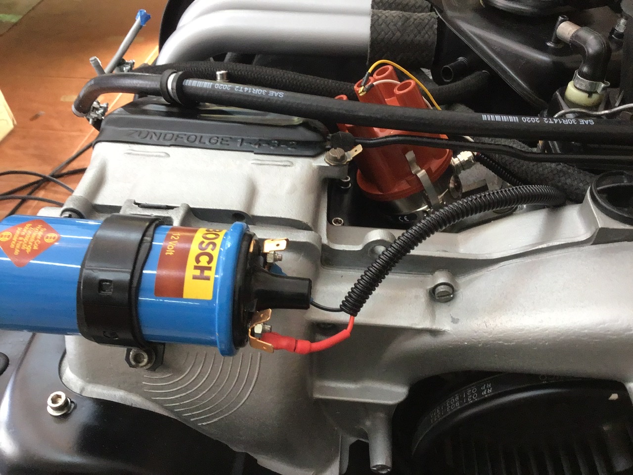

Got the 123 dizzy installed and wired to the coil
Unfortunately, I may have to relocate the coil back to the tin location due to my coil wire being too short. I prefer this location though so I might just make up a longer wire.

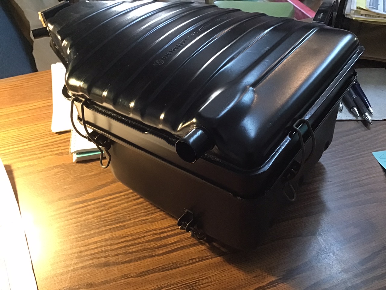

Now trying to get my vacuum lines connected. I purchased the kit from AA but having a difficult time figuring this out. I have referred to many different diagrams and they all seem to differ a bit and then the ports on my air cleaner are a bit different.
Like this big port on the back of the air cleaner, it has an ID of approx 3/4” and I believe this is where one of the lines from the charcoal canister connects, but I don’t have any hose in my kit that fits this. Is there a reducer for this stub?

barefoot   Is there any benefit to mounting the coil here ver...   Mar 3 2021, 07:11 AM
anderssj   Is there any benefit to mounting the coil here v...   Mar 3 2021, 09:50 AM
Morph914   Is there any benefit to mounting the coil here ...   Mar 3 2021, 07:45 PM

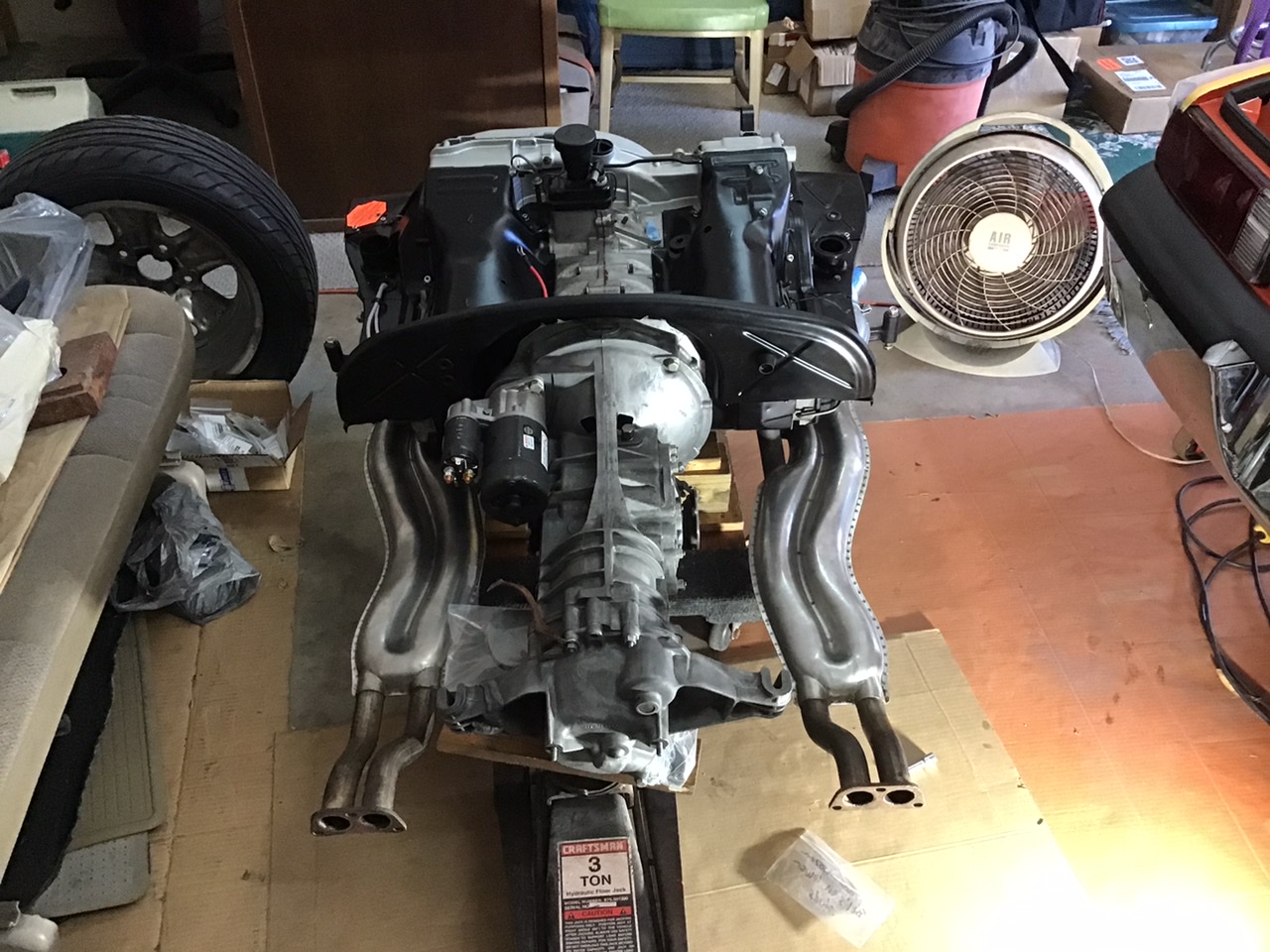

Morph914   Time to get the engine off the stand so I can marr...   Apr 17 2021, 08:34 PM
bbrock   Looking good! You made the right call install...   Apr 17 2021, 08:48 PM
Morph914   Looking good! You made the right call instal...   Apr 18 2021, 01:39 PM
bbrock   Looking good! You made the right call insta...   Apr 18 2021, 02:17 PM

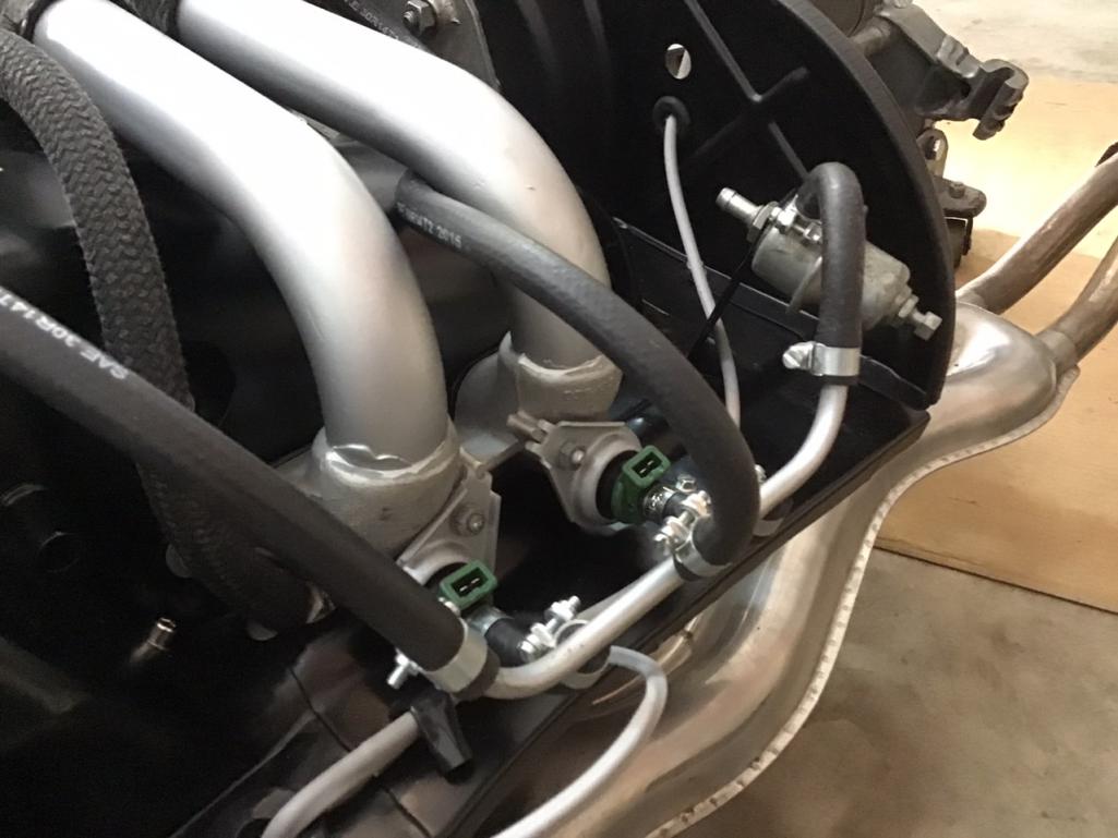

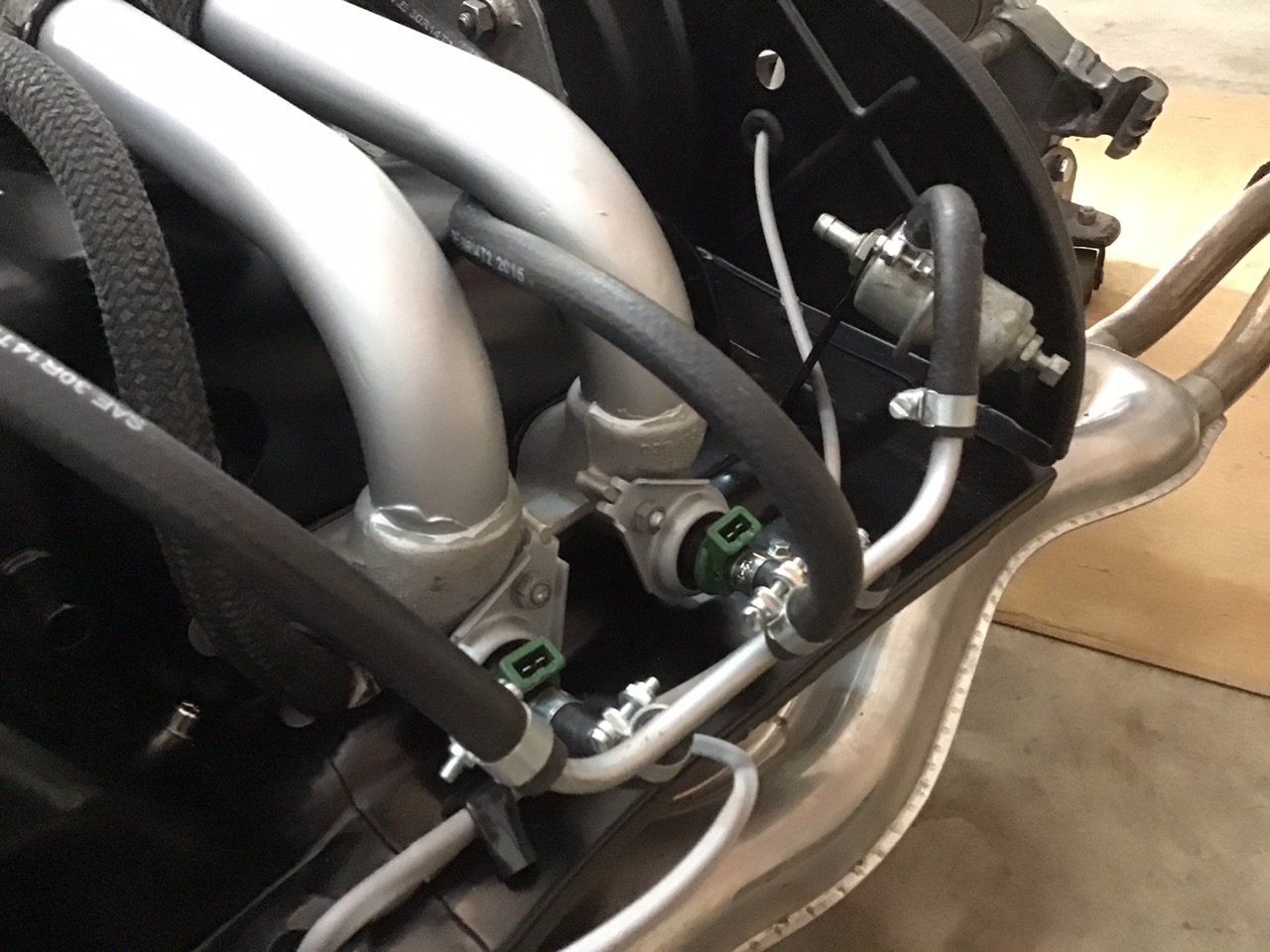

Morph914   I’ve been working on the engine last couple of d...   Apr 28 2021, 07:18 PM
bbrock   Looks like you have the green hose plugged into th...   Apr 28 2021, 09:25 PM

bbrock   BTW, where did you get the green vacuum hose?   Apr 29 2021, 07:31 AM
Morph914   BTW, where did you get the green vacuum hose? ...   Apr 29 2021, 10:21 AM
