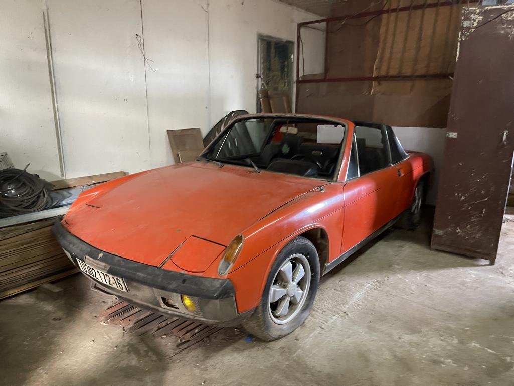

I just found tangerine 914/6 72"

rgalla9146   Is the windshield missing ?   Apr 20 2021, 06:54 PM
KBMC1304   Is the windshield missing ? Not only :(   Apr 27 2021, 07:31 PM

gulf908   hi does it still have the Sonauto badge ? more pic...   Apr 21 2021, 01:22 AM
KBMC1304   hi does it still have the Sonauto badge ? more pi...   Apr 27 2021, 07:00 PM
live free & drive   Cool pin stripe - it's like a designer's s...   Apr 21 2021, 06:08 AM
johnhora   looks like a deep 6 fuchs on the dr front....great...   Apr 21 2021, 08:58 AM
Jett   The license plate is cool!   Apr 21 2021, 01:19 PM
rgalla9146   Damage on right front fender ?   Apr 21 2021, 06:08 PM
Coondog   Congrats :first: :first: :first:   Apr 21 2021, 06:13 PM
Root_Werks   I agree, nice find! Yup, looks like RF fender...   Apr 22 2021, 02:33 PM
