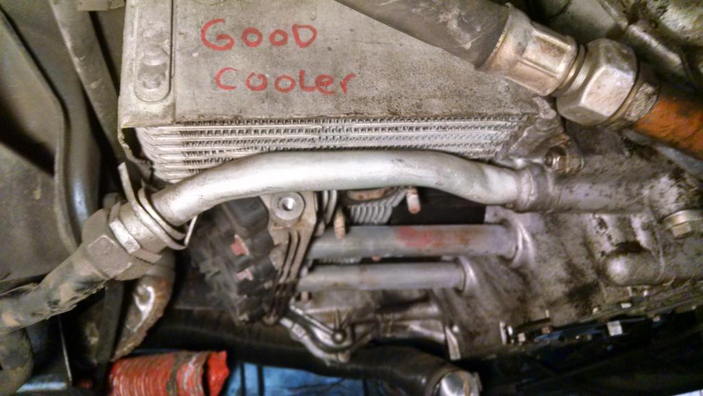

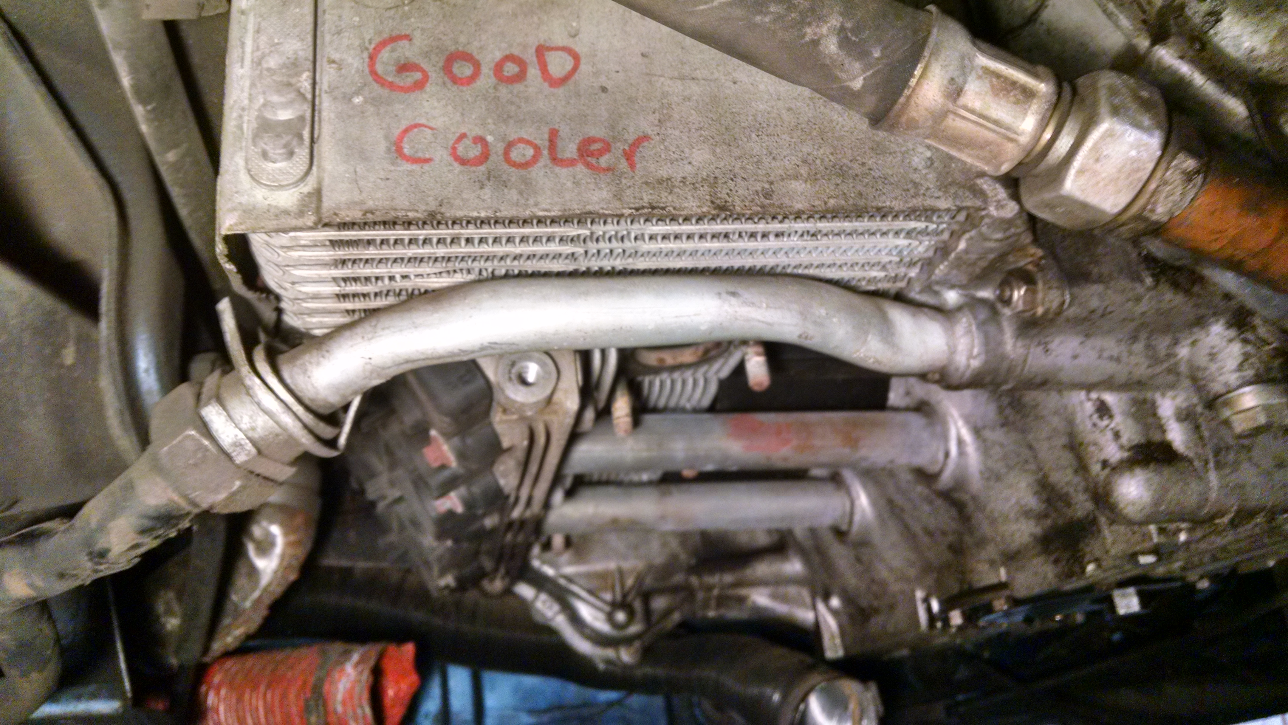

Going to correct this with a proper welded 90 turn and fitting.

Root_Werks   Well, the "Good Cooler" is going bye-bye...   Apr 28 2021, 09:51 AM
