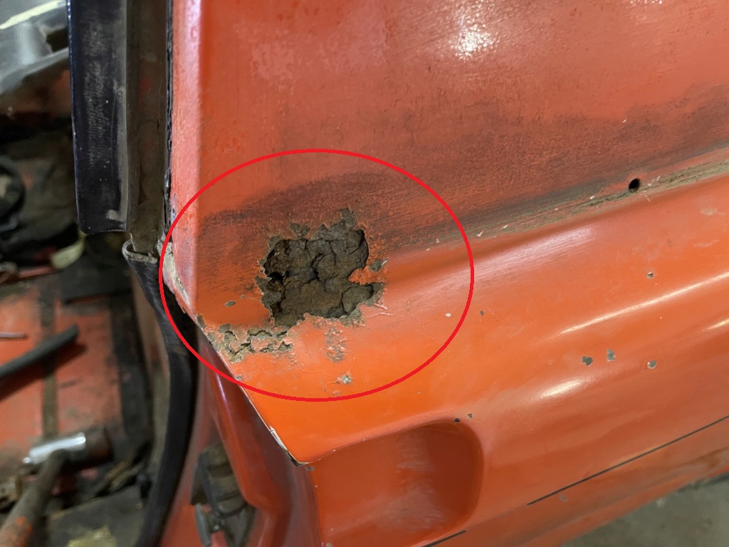

Are you brazing it all?

QUOTE(mb911 @ Apr 28 2021, 07:04 AM) *
I hope this is not the case!!
This needs to be done properly! The way this is going, rust is going to come through within a couple years after paint.
This is just the tip of the iceberg. You need to cut the entire sail panel off and blast behind there. I'm sorry to say, but this is not the correct way to be doing a restoration on a 914

QUOTE(peteyd @ Apr 28 2021, 10:06 AM) *
I cut the rust panel at the limit + 1MM on both sides.
I use primer filler pro before welding the new part.

mb911   Are you brazing it all?   Apr 28 2021, 09:04 AM
peteyd   Are you brazing it all? I hope this is not the ...   Apr 28 2021, 10:06 AM
KBMC1304   [quote name='mb911' post='2911657' date='Apr 28 2...   Apr 28 2021, 11:30 AM
mb911   Just keep in mind brazing is much like a glue and ...   Apr 28 2021, 11:55 AM
KBMC1304   Just keep in mind brazing is much like a glue and...   Apr 28 2021, 02:48 PM
