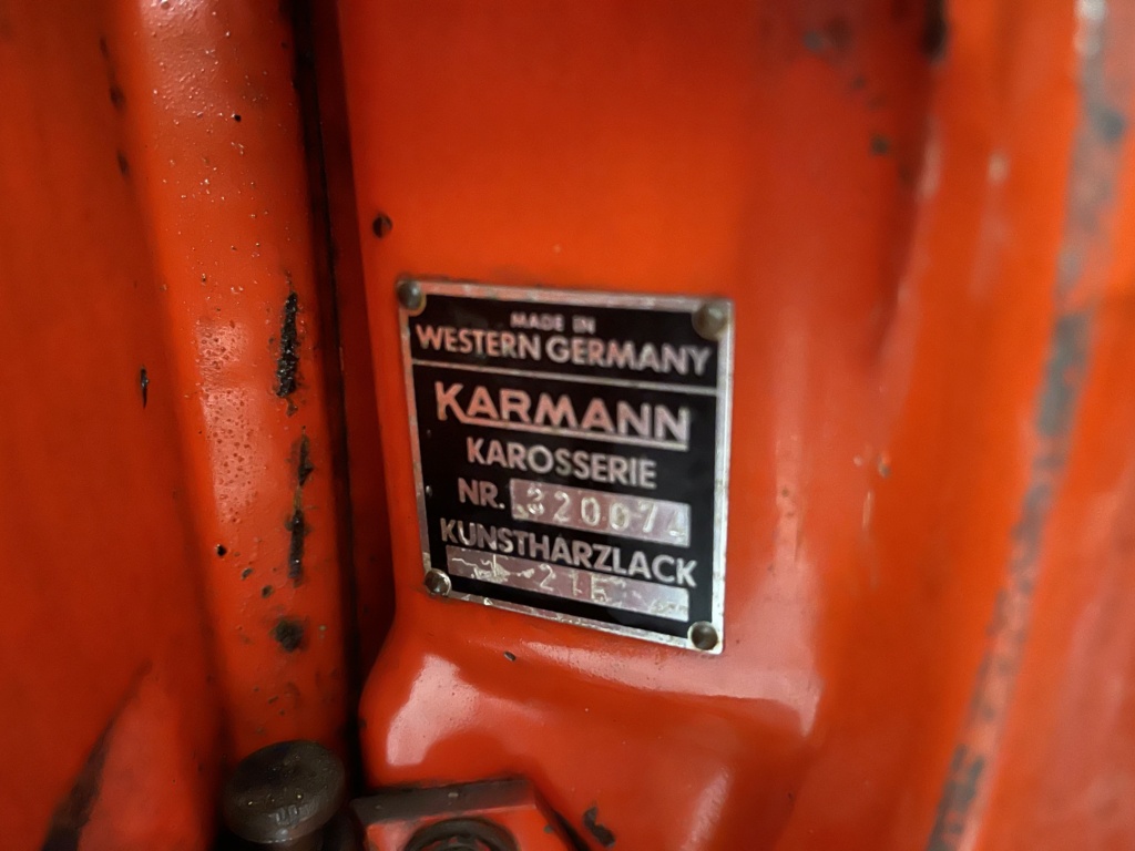

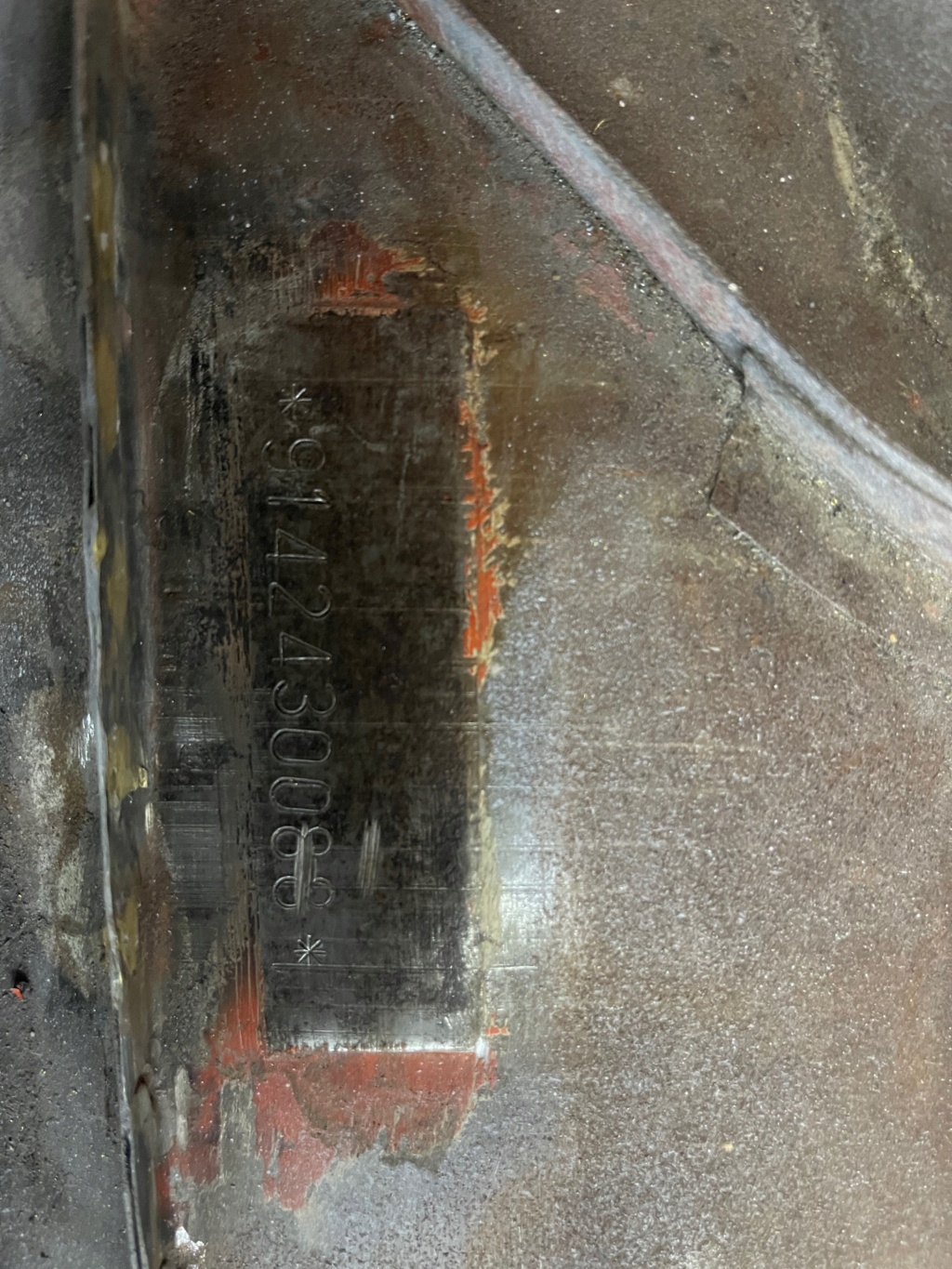

The 1972 914/6 are interesting cars. A few steps forward, and a few steps back. Along with the 914/4 steering column and ignition switch, it appears the windshield washer is the 914/4 system. Were the upper front suspension mounts painted with tar like the earlier 914/6 or without tar like the 914/4?
Please look carefully for the Karmann body # in the rear trunk. It should be in the right rear corner near the right tail light with the form of 1320xxx where xxx should be close to the last three digits of the VIN.
Please get a photo of the VIN on the right inner fender and the paint badge .
There should also be a handwritten production # (may or may not be exactly the same as the Karmann body #) on the underside of the dash on the removable rear part.
Dave

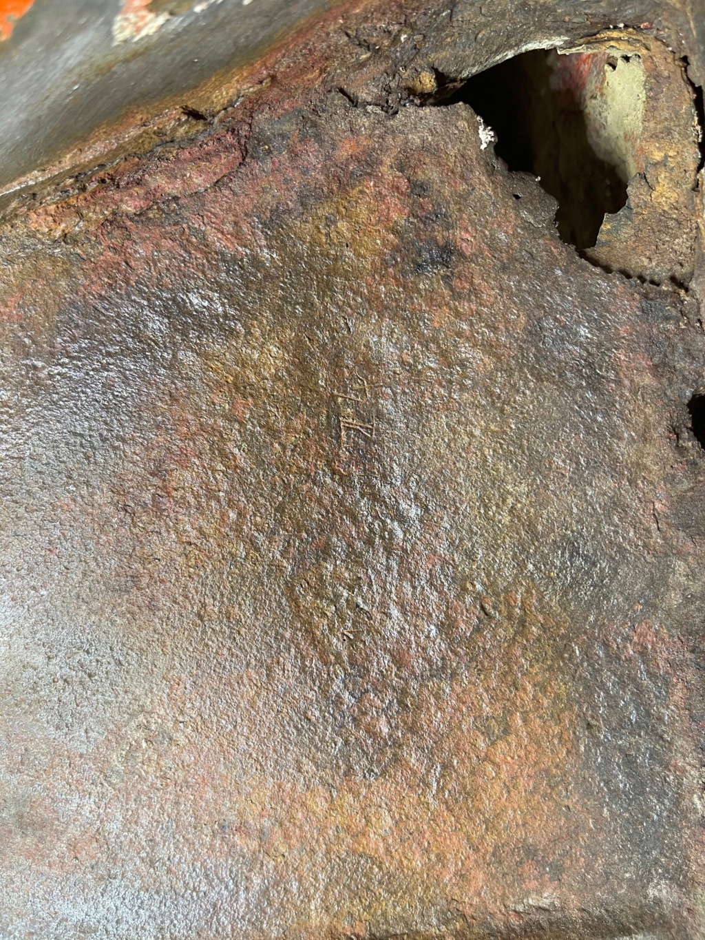

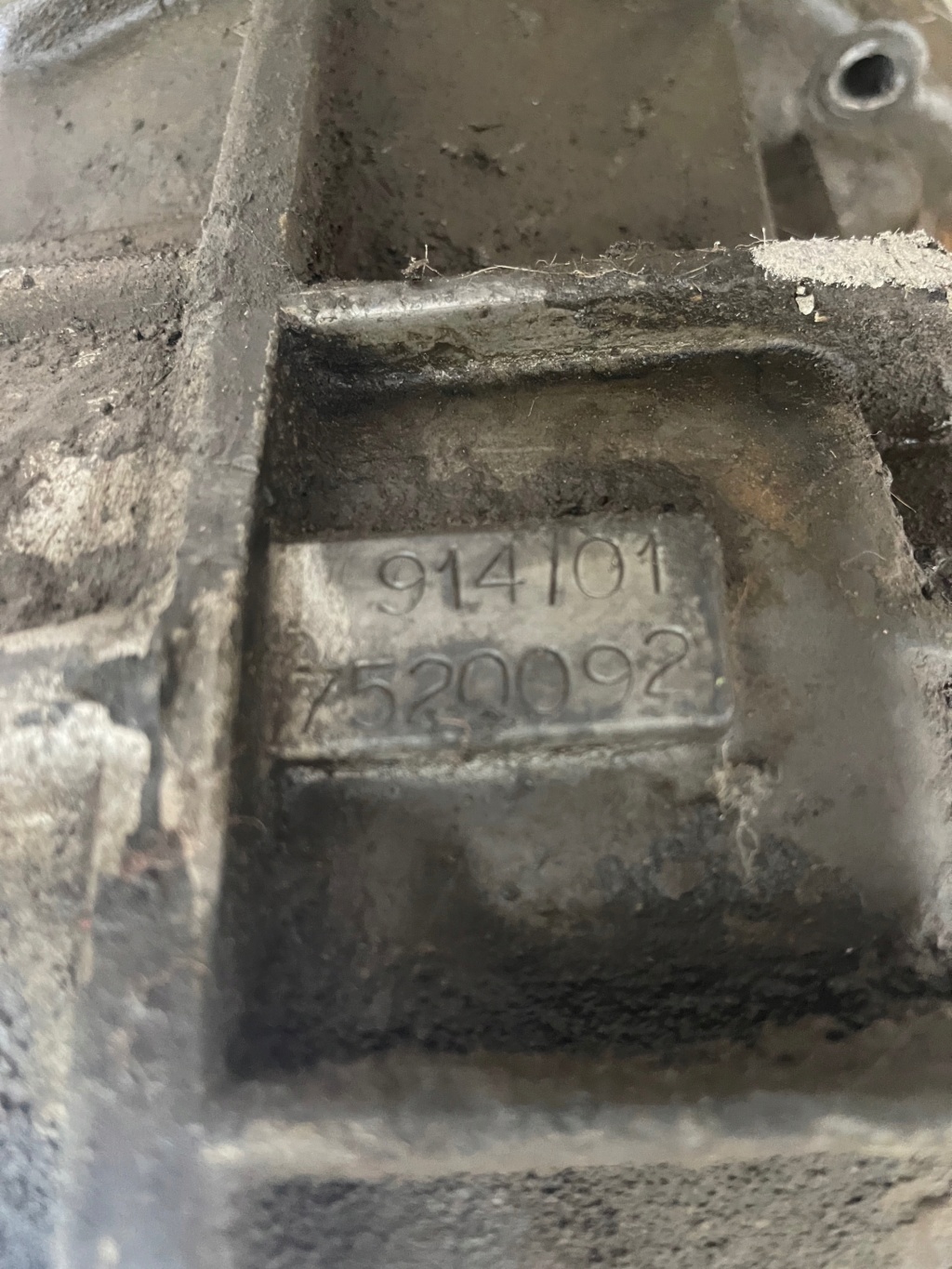

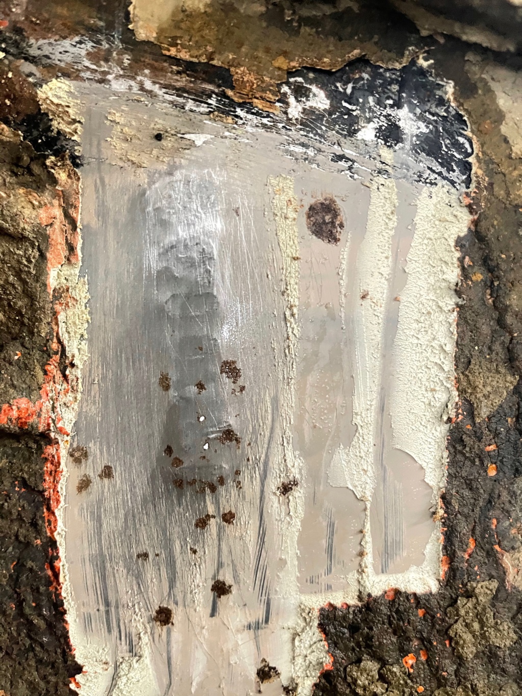

The upper front suspension mounts painted with tar like the earlier 914/6.
and
this what I found on it
too much rust in the rear trunk but we can read 4 so I believe it's the same Karmann body number.
Khaled
