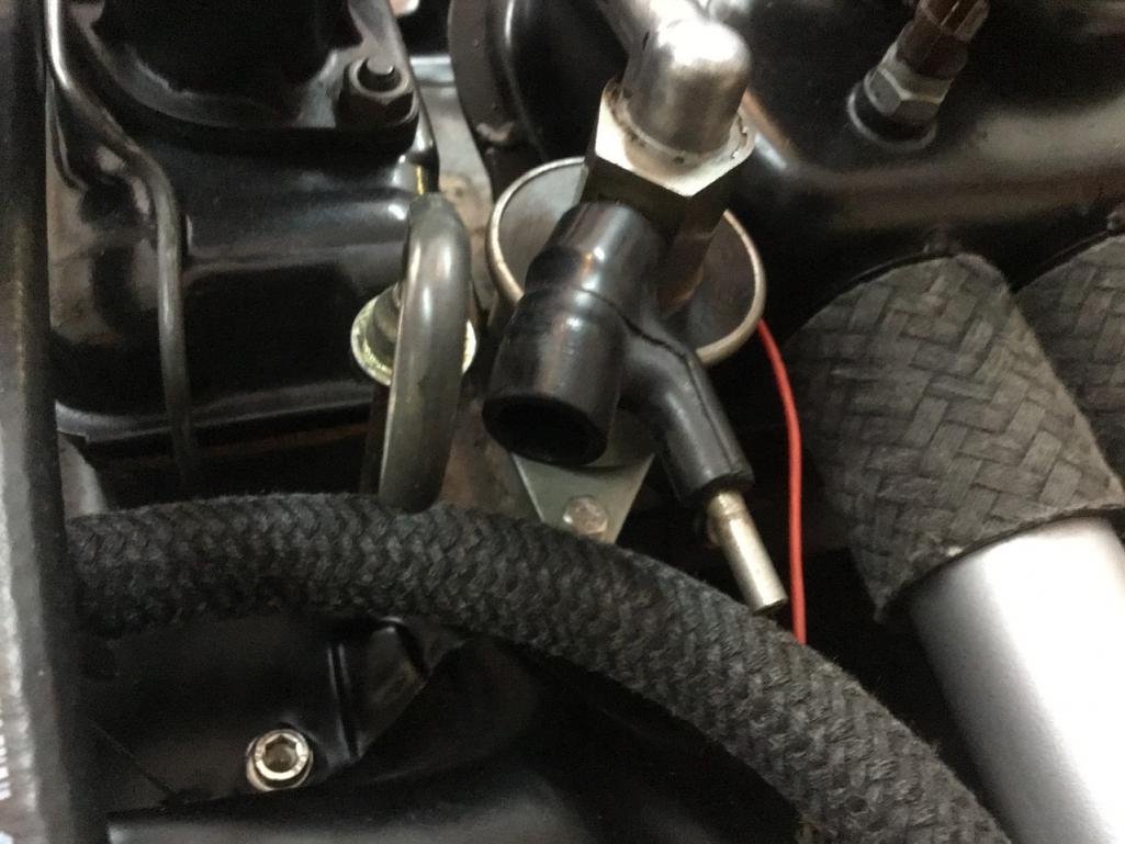

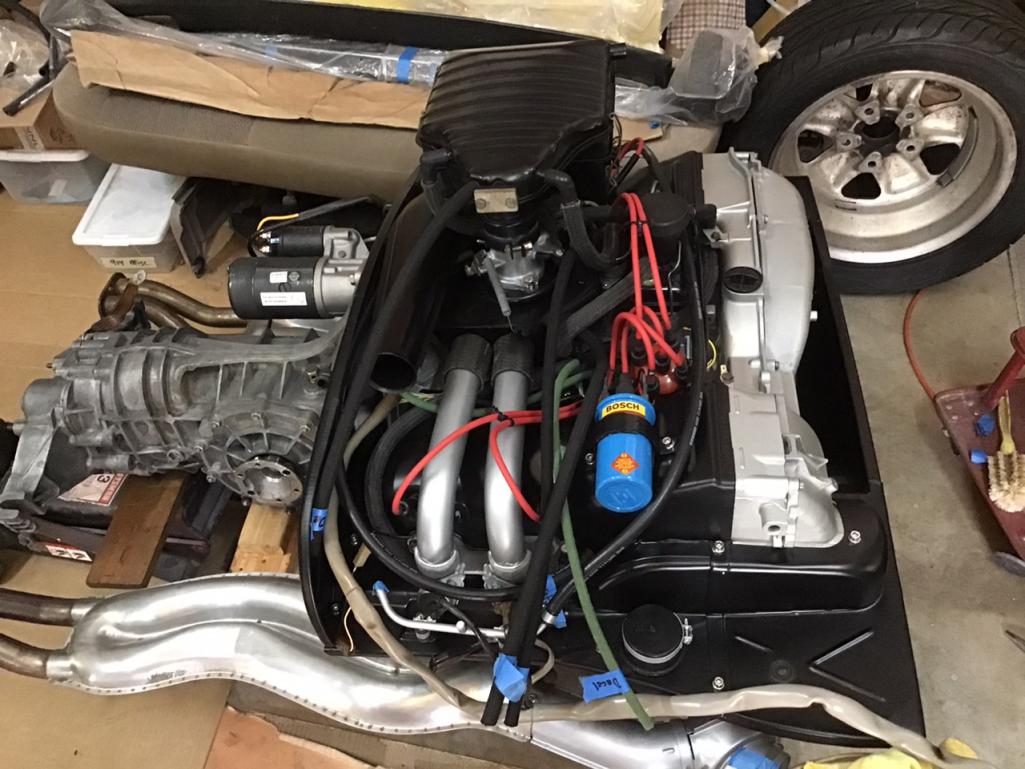

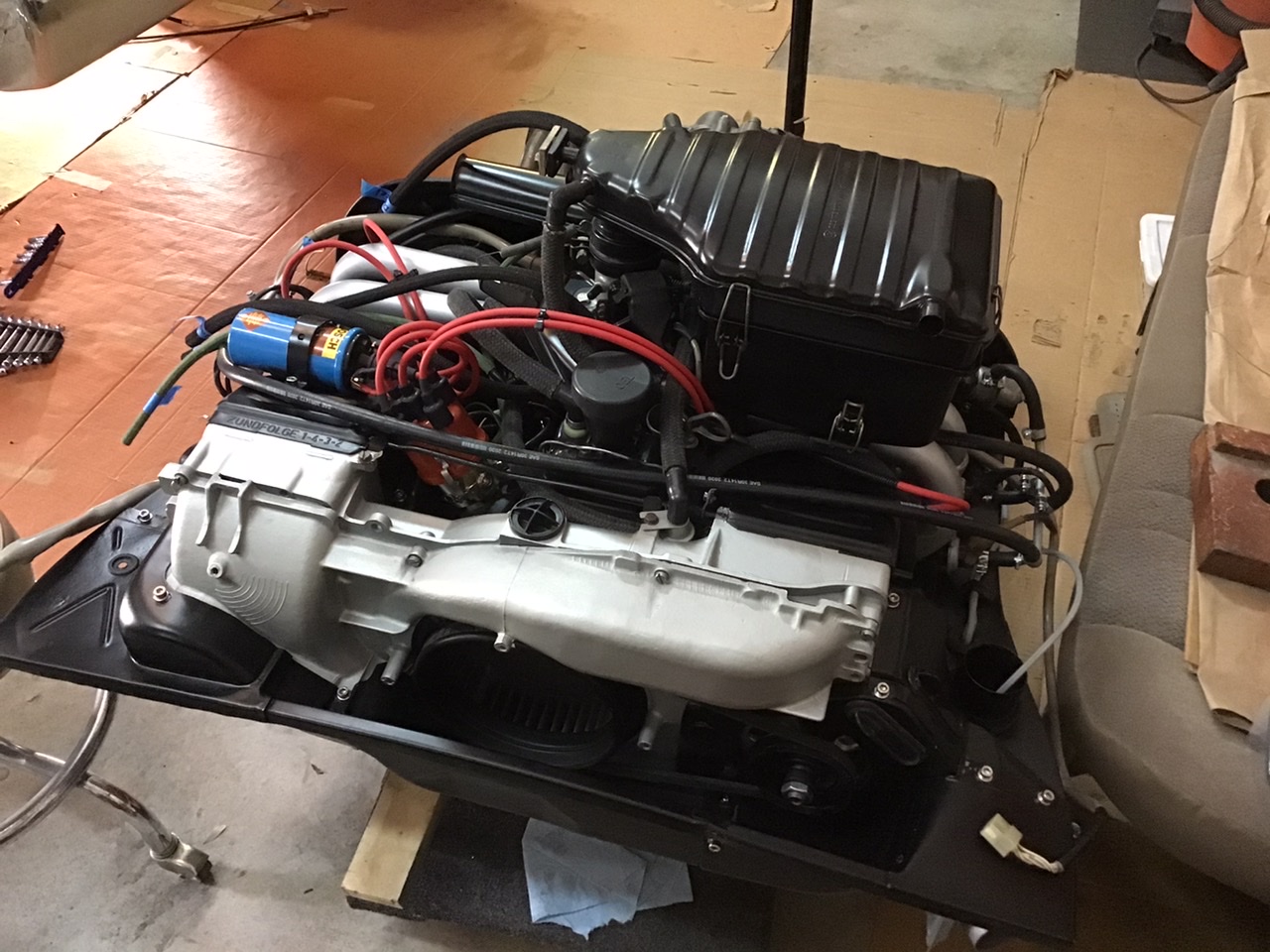

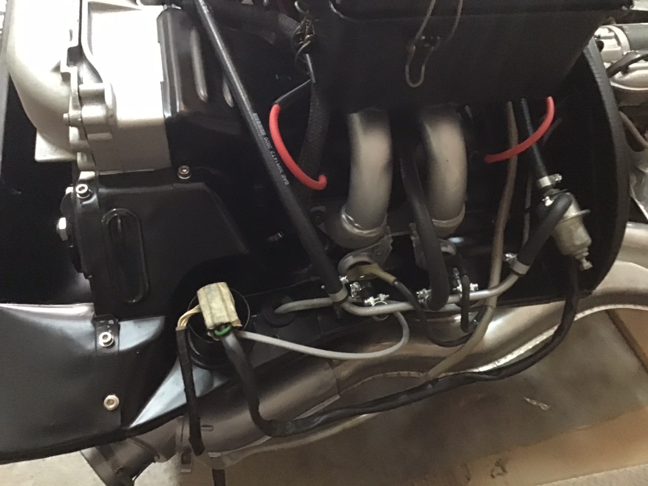

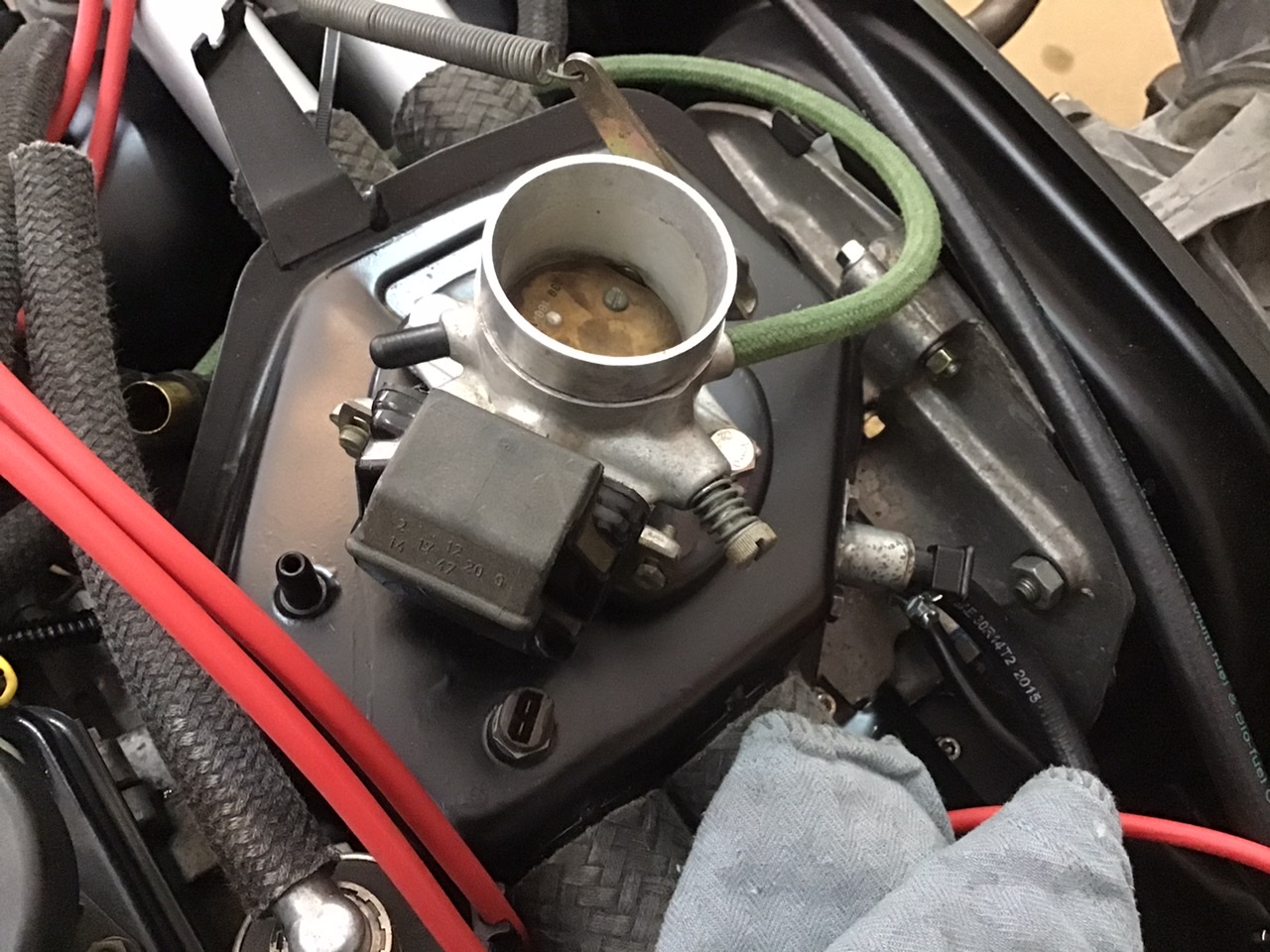

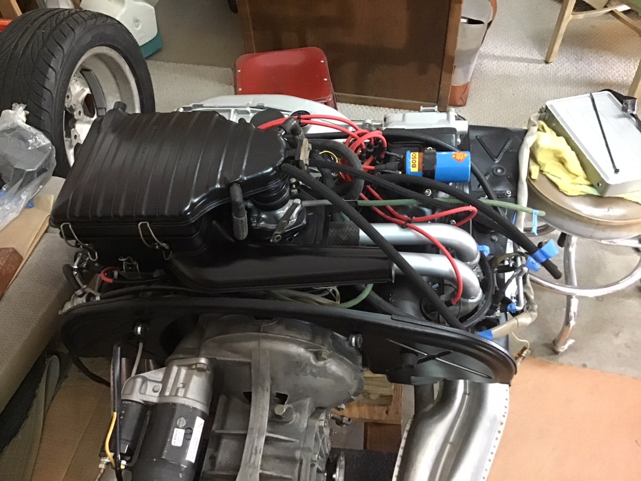

I’ve been working on the engine last couple of days. I do have a couple of questions though. First off, I connected the green vacuum hose from the throttle body to the new 123 Dizzy, I used this port because it had the same size as the one on the dizzy. The other advance/retard port that is capped off had a smaller port. I’m hoping this is right
The next picture shows a splitter coming off the AAR valve, I am not using the cold start valve so not sure if I should plug this off or not.
Just about ready to put the engine in, any words of wisdom are welcome at this point. Obviously I will remove the air cleaner before stabbing the engine. I was just fitting the last of the vacuum hoses, the more I can do outside of the car the better for me and my back.

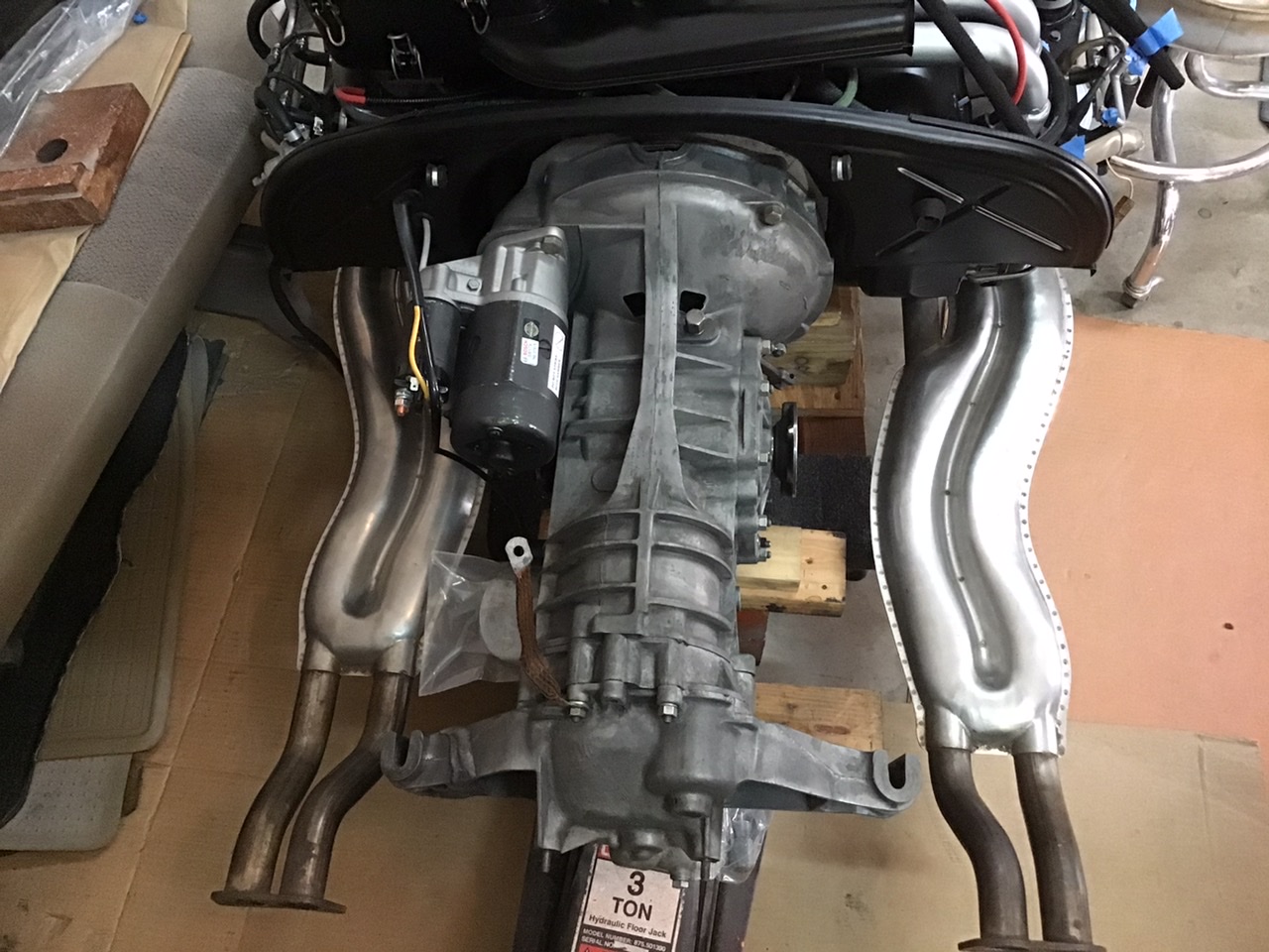

Morph914   Time to get the engine off the stand so I can marr...   Apr 17 2021, 08:34 PM
bbrock   Looking good! You made the right call install...   Apr 17 2021, 08:48 PM
Morph914   Looking good! You made the right call instal...   Apr 18 2021, 01:39 PM
bbrock   Looking good! You made the right call insta...   Apr 18 2021, 02:17 PM

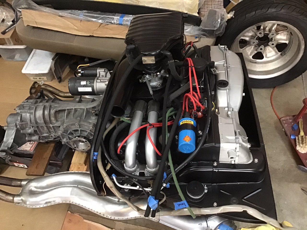

Morph914   I’ve been working on the engine last couple of d...   Apr 28 2021, 07:18 PM
bbrock   Looks like you have the green hose plugged into th...   Apr 28 2021, 09:25 PM
Dion   Car is looking fantastic! Great work. I apprec...   Apr 29 2021, 04:46 AM
Morph914   Car is looking fantastic! Great work. I appre...   Apr 29 2021, 10:28 AM
bbrock   BTW, where did you get the green vacuum hose?   Apr 29 2021, 07:31 AM
Morph914   BTW, where did you get the green vacuum hose? ...   Apr 29 2021, 10:21 AM
