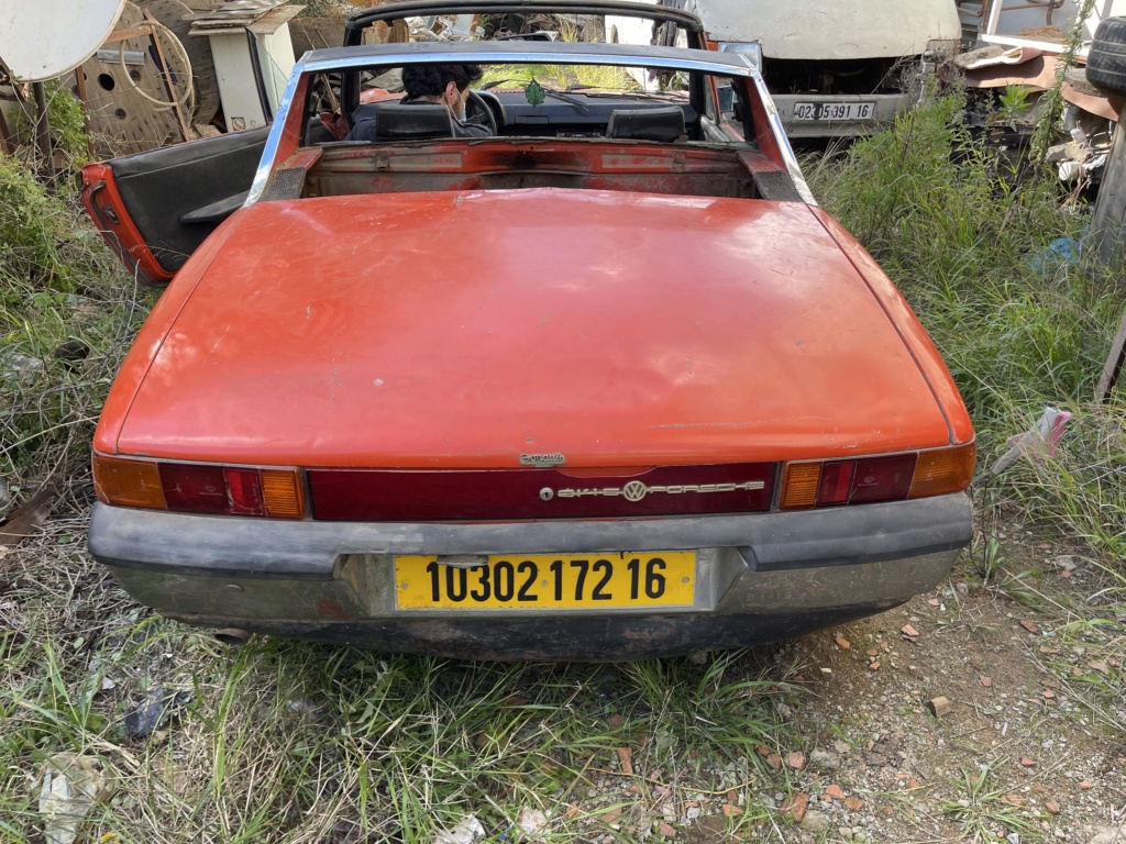

thanks for the update report
I am curious to know where the Sonauto badge was placed on the car
keep up the good work
cheers
Dennis (IMG:style_emoticons/default/smile.gif)

QUOTE(gulf908 @ May 1 2021, 12:28 AM) *
cheers
(IMG:http://www.914world.com/bbs2/uploads_offsite/i.servimg.com-25113-1619911365.1.jpg)
Thank you very much for your support Dennis.
In the middle of the trunk
Khaled (IMG:style_emoticons/default/smile.gif)
