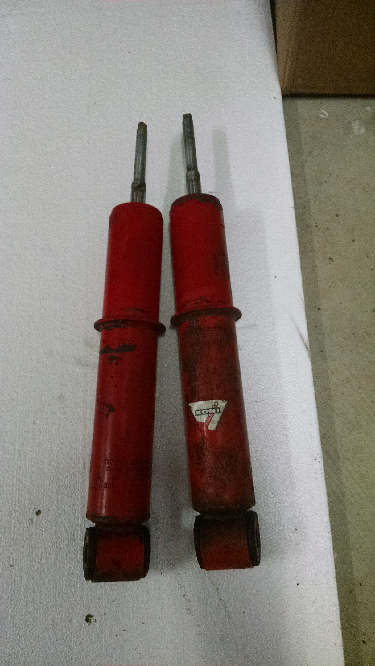

Bought the Koni's that were for sale. Wound up being adjustable oil filled Special D's which I was hoping for. They work perfectly, can adjust and feel a nice smooth resistance change with each adjustment. Cleaned them up a bit.
Gotta figure out what springs to use now. Stock, but cut 1 1/2 coils off or something slightly higher rate? Street car, don't want to bounce around but know I have a bit more weight with the six.
Any suggestions?
