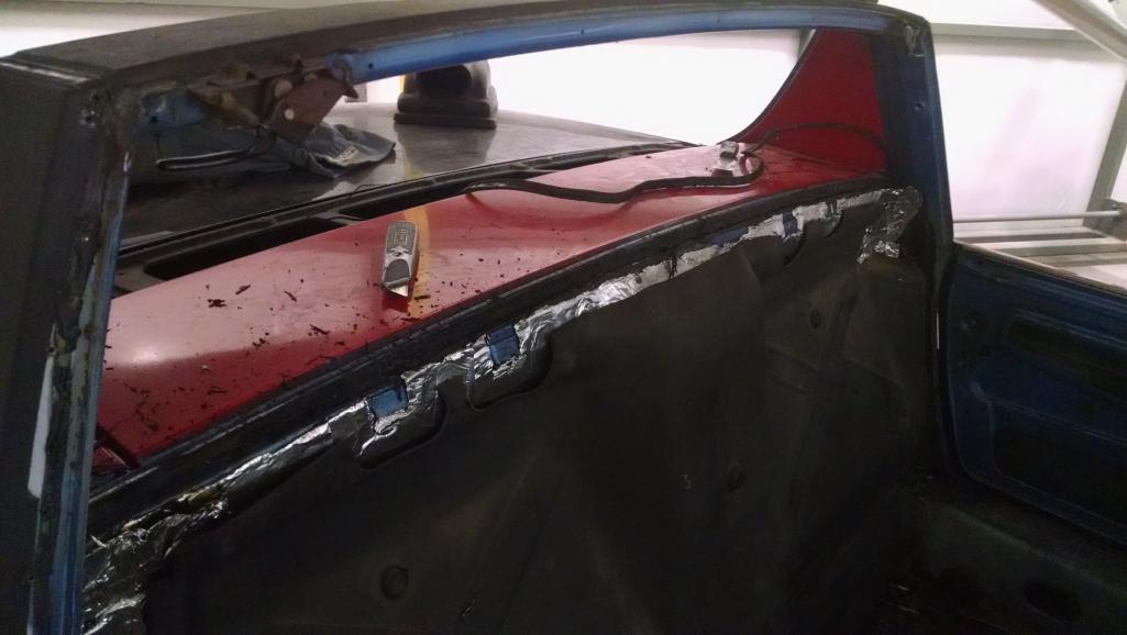

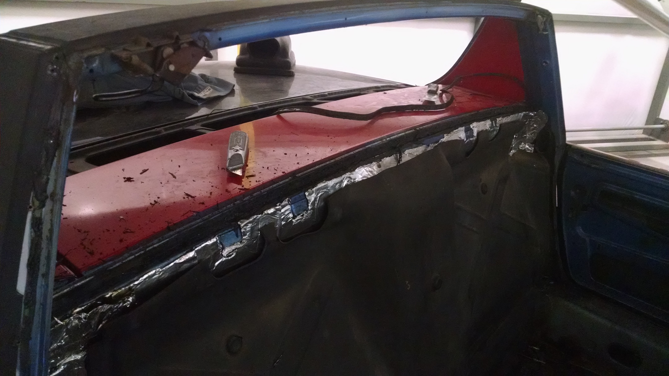

Removed the rear window, it was silly-coned in from both sides. Took about 45 minutes to get out. Another hour of clean up to do. Oye.
Noted the Dynamat on the firewall, kinda neat.
