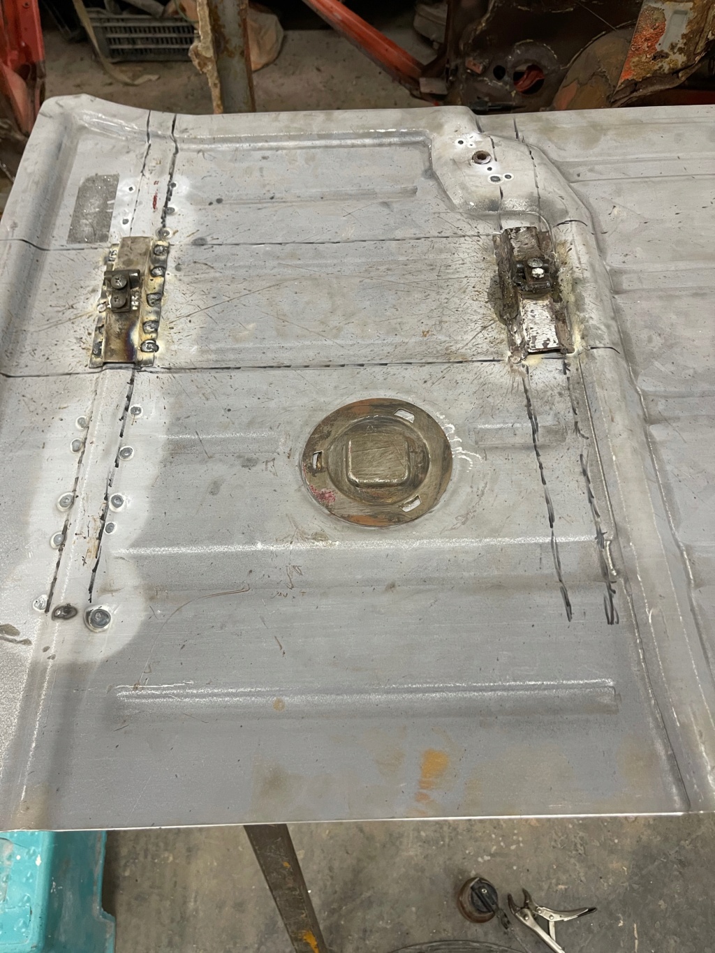

rgalla9146   Is it just me or do those floors look a bit unusua...   May 10 2021, 06:11 PM
KBMC1304   Is it just me or do those floors look a bit unusu...   May 11 2021, 05:10 PM
rgalla9146   Looks right now. The other picture was from an ...   May 11 2021, 06:43 PM
KBMC1304   preparing and stabilizing the the rear floor htt...   May 18 2021, 06:40 AM
