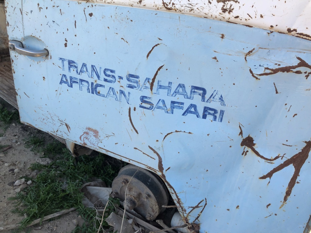

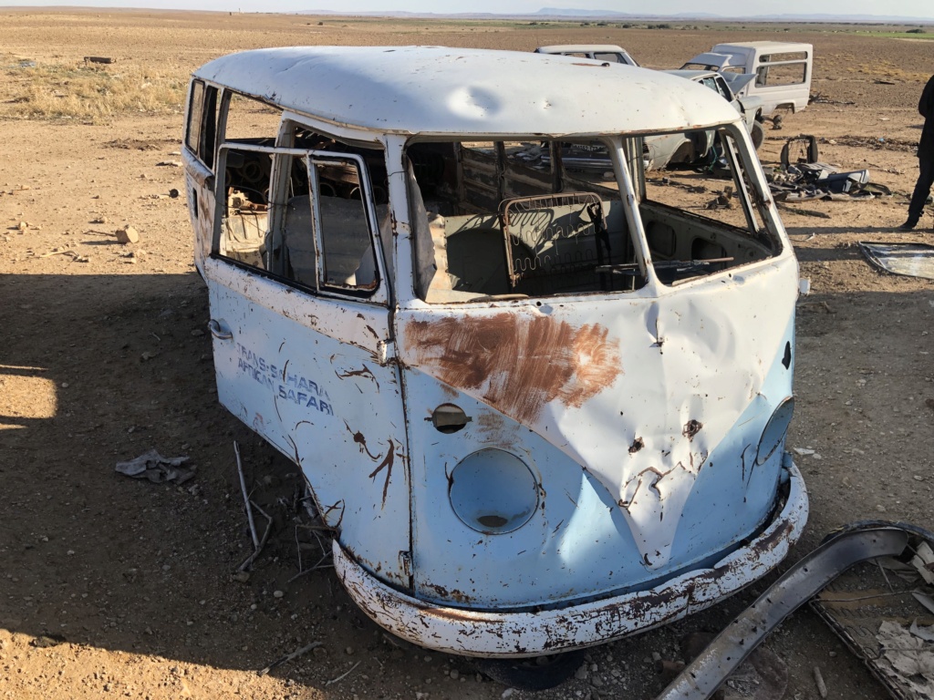

Trans Sahara African Safari. ?
Was that a tour group. ? (IMG:style_emoticons/default/confused24.gif) It is not an endurance race I have ever heard of.

QUOTE(VegasRacer @ May 10 2021, 04:16 PM) *
(IMG:http://www.914world.com/bbs2/uploads_offsite/i22.servimg.com-25113-1620686950.1.jpg)
(IMG:http://www.914world.com/bbs2/uploads_offsite/i22.servimg.com-25113-1620686952.2.jpg)
i did some research but didn't find anything
