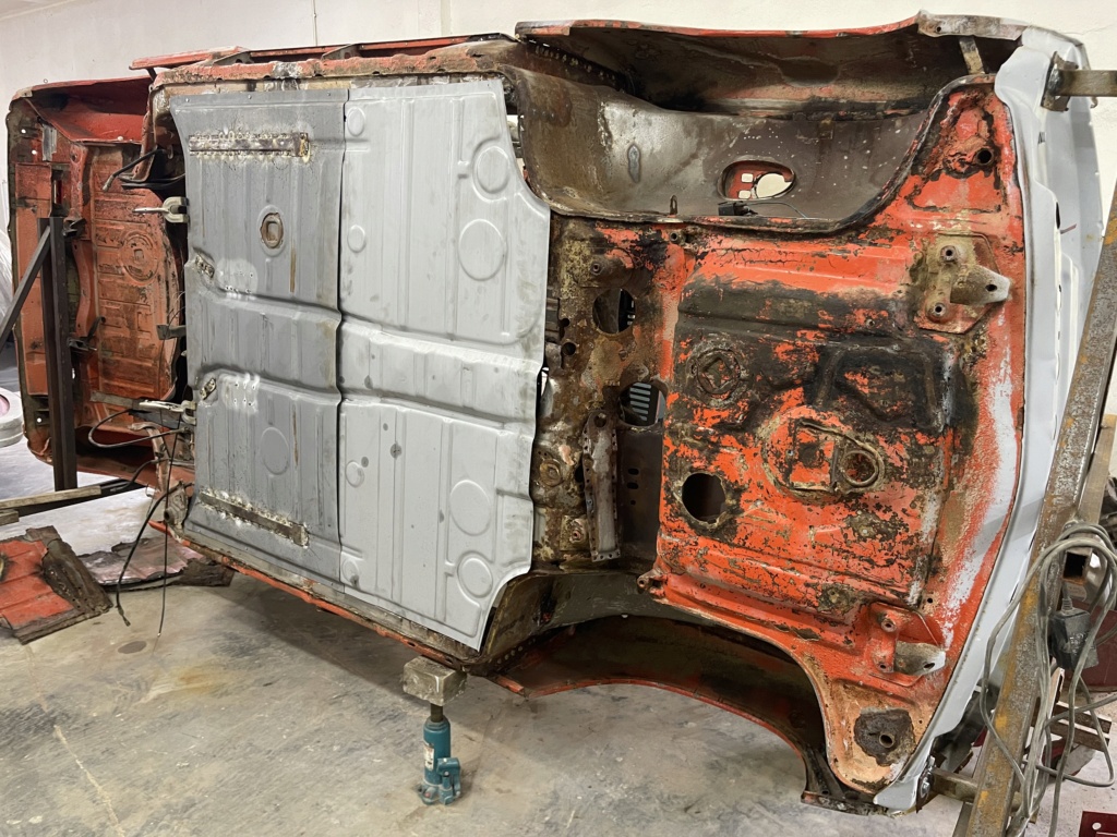

Is it just me or do those floors look a bit unusual ?

QUOTE(rgalla9146 @ May 10 2021, 06:11 PM) *
This is the first time that I restore a 914.
I don't know if the floor is unusual.
it seems that it fits well.

rgalla9146   Is it just me or do those floors look a bit unusua...   May 10 2021, 06:11 PM
KBMC1304   Is it just me or do those floors look a bit unusu...   May 11 2021, 05:10 PM
rgalla9146   Looks right now. The other picture was from an ...   May 11 2021, 06:43 PM
