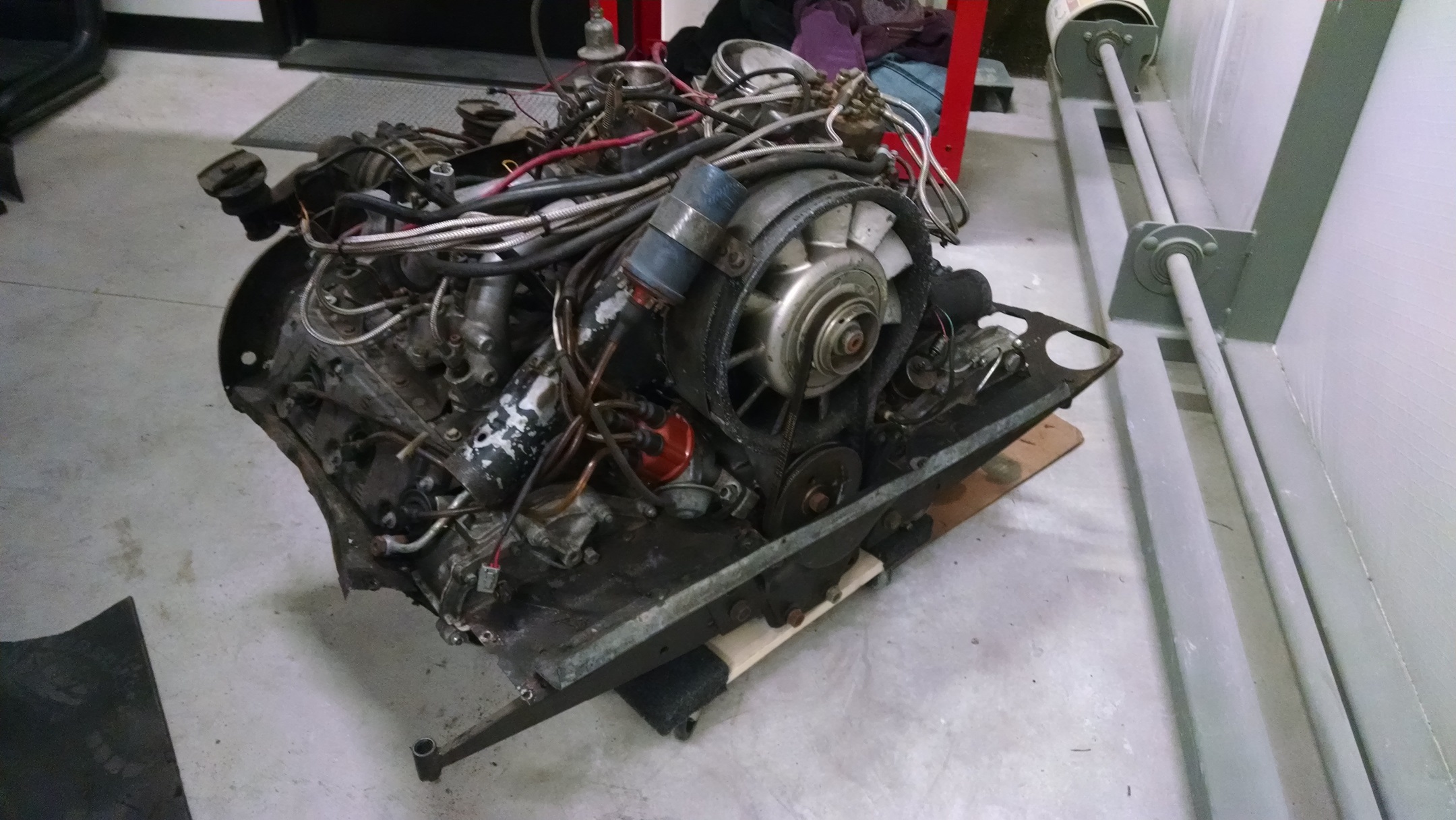

Pulled the engine to redo some things and replace some pieces. Have the time, might as well.
For those interested, check out the homemade mount. It's a modified 911 crossbar. The system relies on sheet metal shelf to support not just the engine. I'll remove all this and install a bulkhead mount.
Engine and cross bar:
