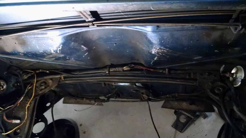

Michelle and I picked up our new to us 914-6 over the weekend. We practiced social distancing and kept safe. Two days home, 920 miles, the 914 never missed a beat.
Here's a picture at a rest stop about 30% of the way home.

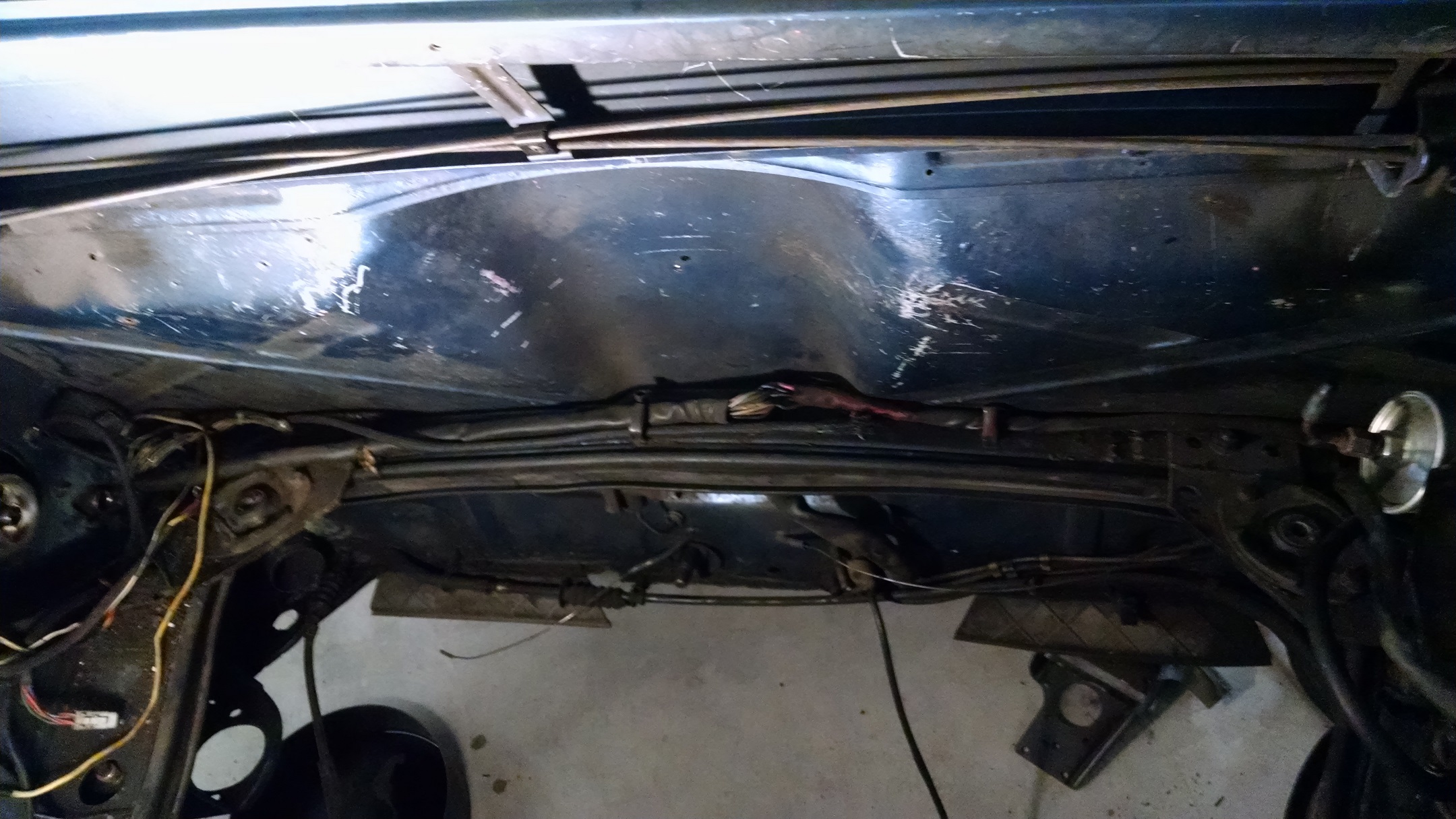

Inside the engine bay, you can see the mount plates. Everything added looks like 3/16" plate steel.
There are so many holes drilled in the 914 everywhere. (IMG:style_emoticons/default/sad.gif)
