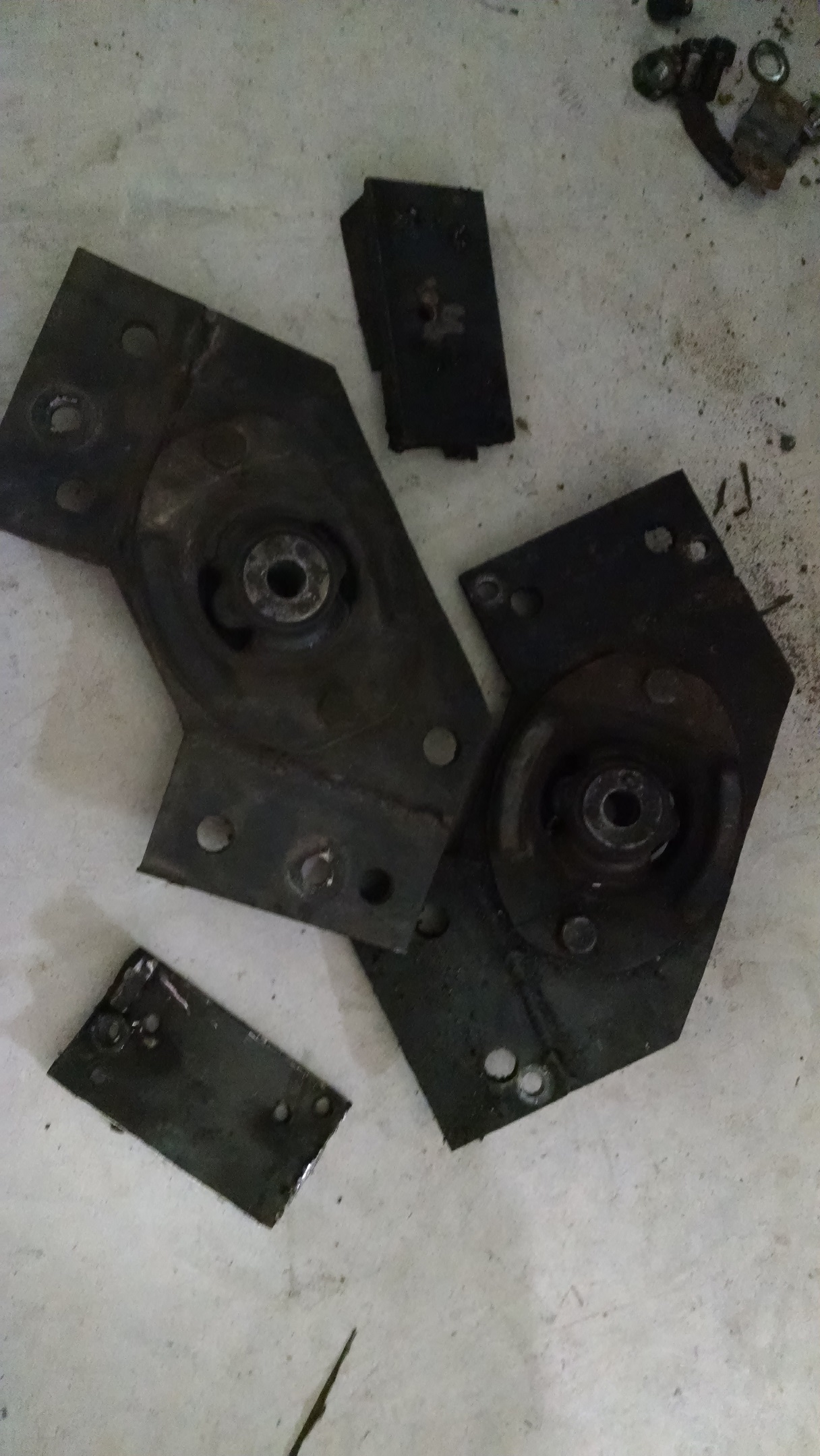

Root_Werks   Pulled the engine to redo some things and replace ...   May 13 2021, 10:02 AM
Root_Werks   Inside the engine bay, you can see the mount plate...   May 13 2021, 10:03 AM
Root_Werks   Had to Dremel, cold chisel and grind for a bit of ...   May 13 2021, 10:06 AM
Root_Werks   The pieces from the constructed mount:   May 13 2021, 10:07 AM
Root_Werks   Maddogs mount welded in place, sorry for the fuzzy...   May 13 2021, 10:08 AM
