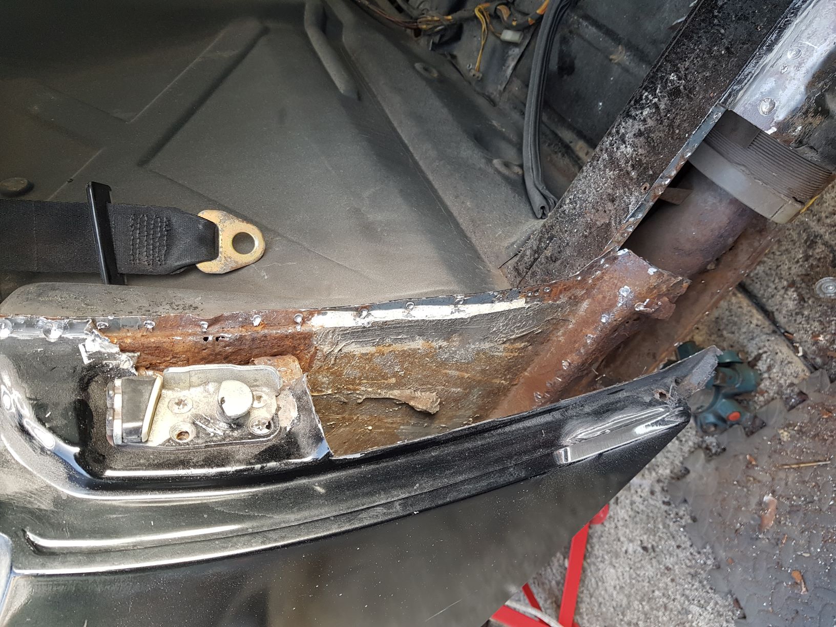

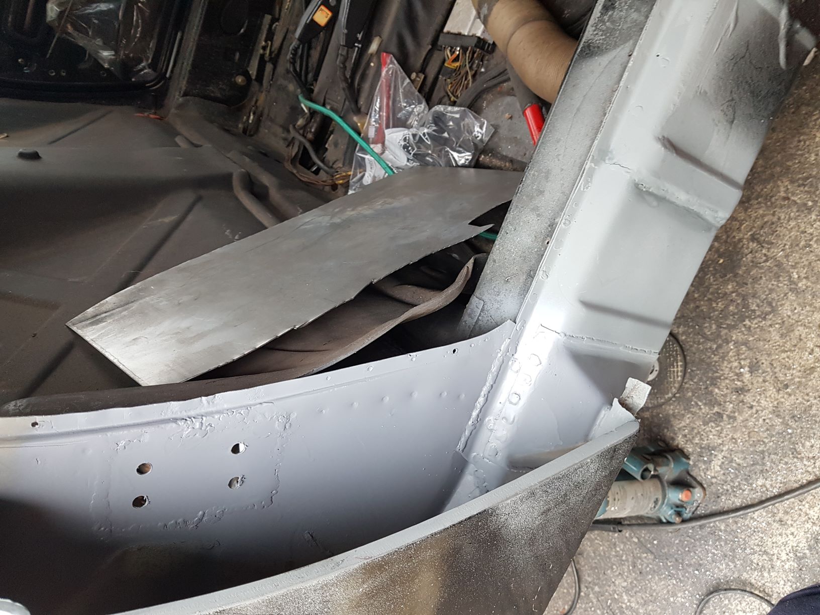

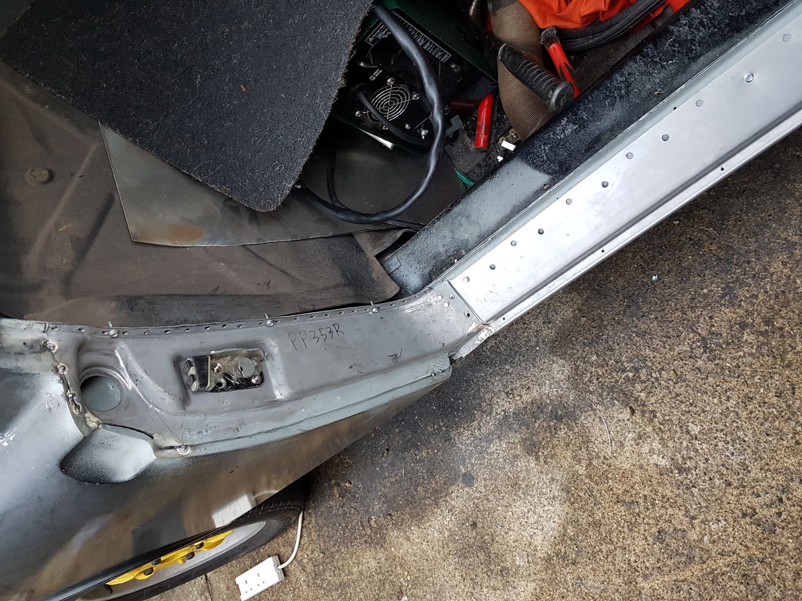

Got a good run at the right side rust repairs last few days, I modified outer outer rocker panel a bit to extend it further back as the rust I cut our extended into the wheel house a few inches. I assembled the jacking point with the sill on the bench with many test fits to ensure it lined up). I found that let me get is all more strongly welded and painted inside before popping the whole unit onto car.
Also bolted the latch support (L shape bracket) to the door jam repair panel and then marked and drilled the 4 weld wholes, then fitted the door panel with is bolded in, this made locating that bracket a lot easier. Once i have the jam door panel all welded in I will weld the bracket in from the engine bay. not sure how other have tackled but that just made most sense to me
