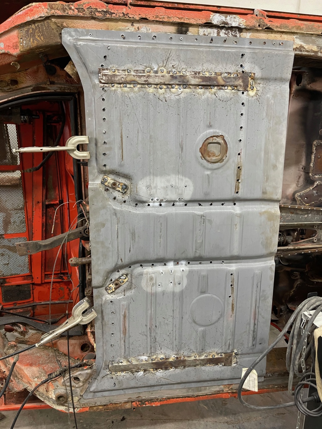

preparing and stabilizing the the rear floor
(IMG:http://www.914world.com/bbs2/uploads_offsite/i.servimg.com-25113-1621341634.1.jpg)

mb911   Are you brazing it all?   Apr 28 2021, 09:04 AM
peteyd   Are you brazing it all? I hope this is not the ...   Apr 28 2021, 10:06 AM
KBMC1304   [quote name='mb911' post='2911657' date='Apr 28 2...   Apr 28 2021, 11:30 AM
mb911   Just keep in mind brazing is much like a glue and ...   Apr 28 2021, 11:55 AM
KBMC1304   Just keep in mind brazing is much like a glue and...   Apr 28 2021, 02:48 PM

rgalla9146   Your car has great potential but needs much care. ...   May 9 2021, 06:24 PM
SirAndy   It is advisable to stabilize the door openings (a...   May 10 2021, 11:20 AM
KBMC1304   Your car has great potential but needs much care....   May 10 2021, 03:52 PM

rgalla9146   Is it just me or do those floors look a bit unusua...   May 10 2021, 06:11 PM
KBMC1304   Is it just me or do those floors look a bit unusu...   May 11 2021, 05:10 PM
rgalla9146   Looks right now. The other picture was from an ...   May 11 2021, 06:43 PM
KBMC1304   preparing and stabilizing the the rear floor htt...   May 18 2021, 06:40 AM
Root_Werks   40% new 914! It's a lot of work, but it...   May 18 2021, 08:38 AM
